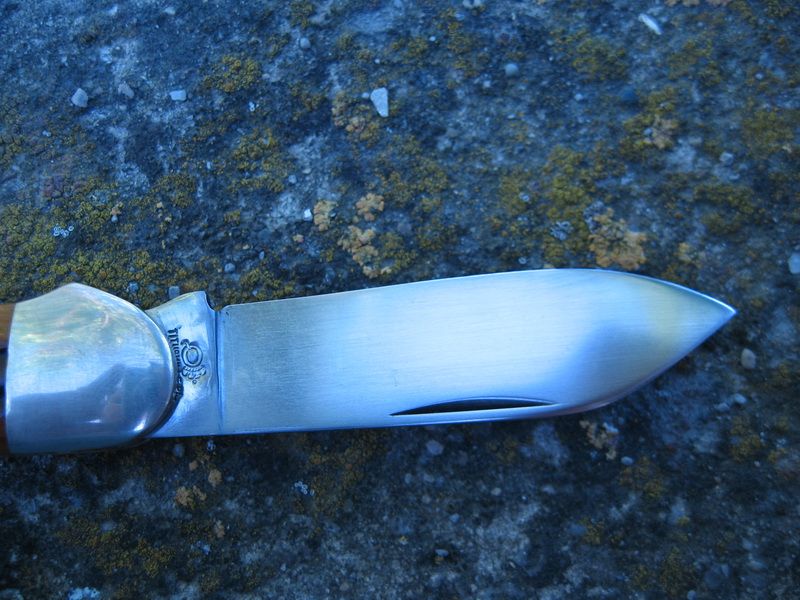

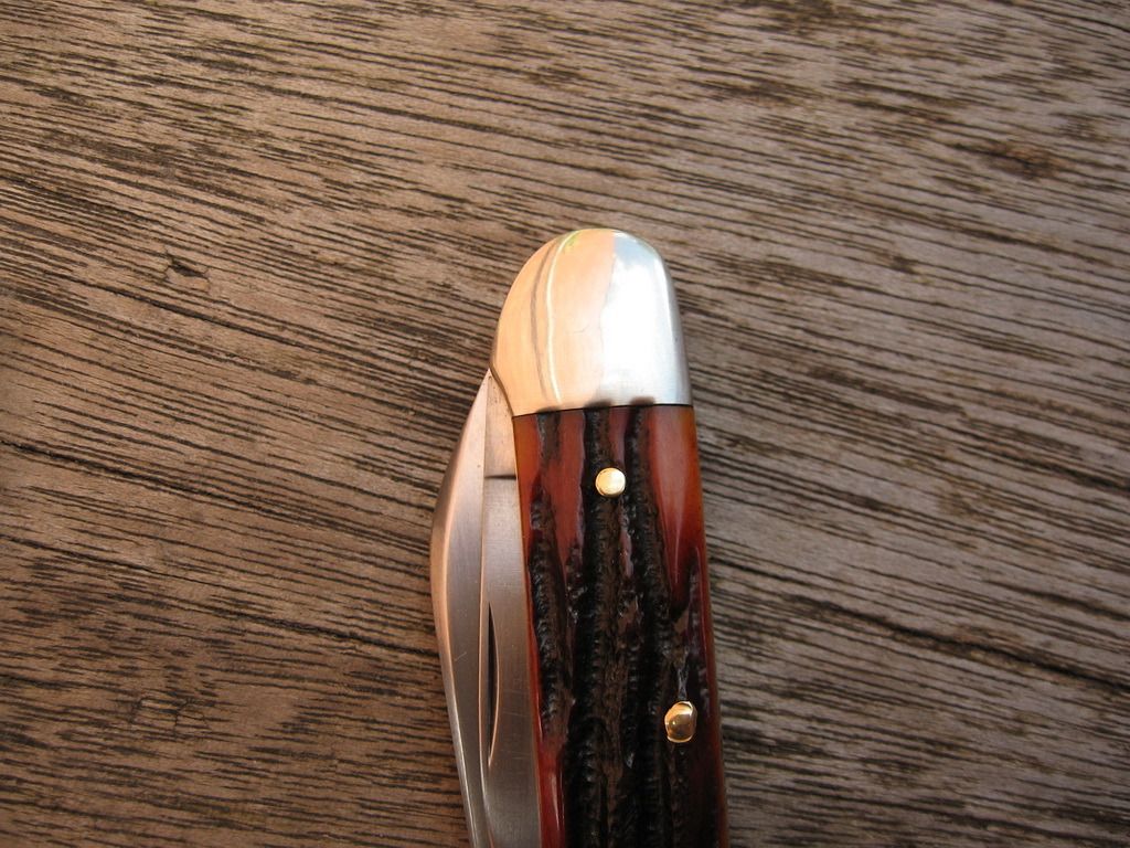

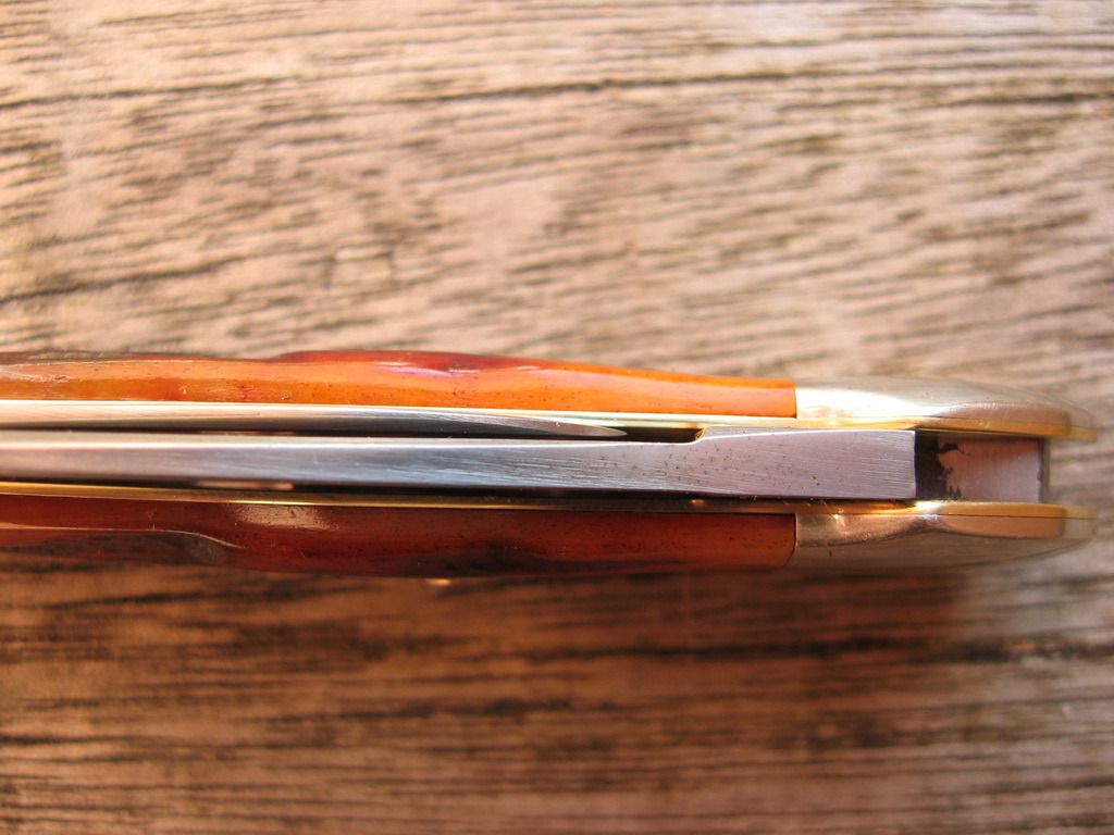

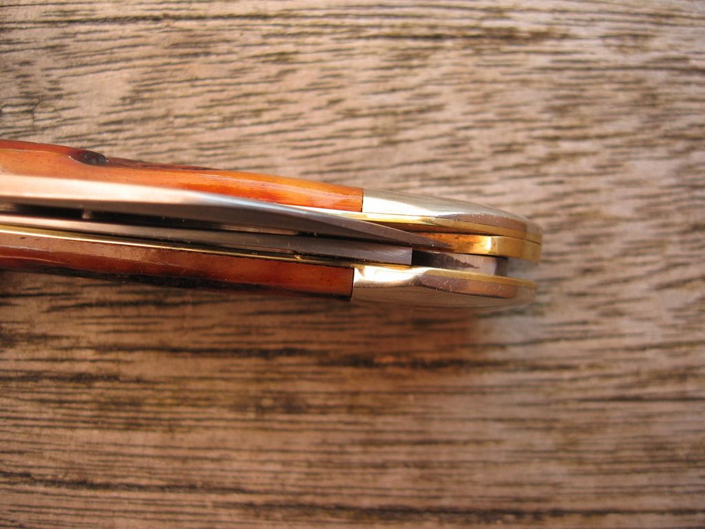

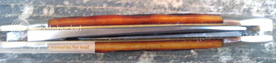

I listed the blade thickness under both because it is really just a personal preference and can be viewed either way. The pen blade is nice and thin. Here's a pic that shows the difference between the two.

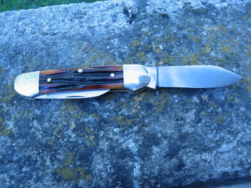

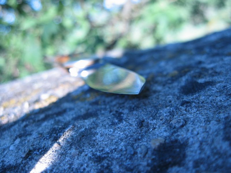

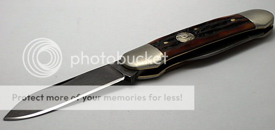

Another pic of the knife from my giveaway thread. It took a bit of effort to thin the edge down to this point. Don't expect it to come from Queen ground like this.;)
Overall it's a good quality knife that is easily pocketable and comfortable to hold, especially when using the master blade.

I really like the Canoe in D2
Highly recommended
the D2, once rebeveled, holds a sharp edge for ever
the thicker main blade is one of the stoutest blades I have and is a real worker
The super thin second blade is like a laser as a slicer

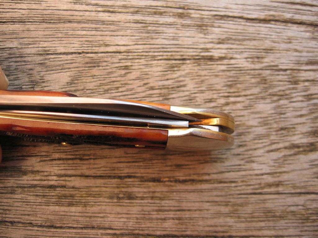

Highly recommended
attachment.php

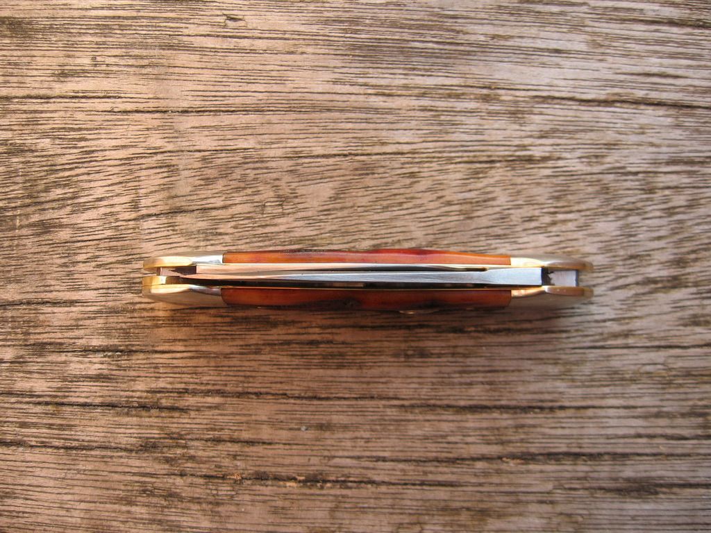

Neeman, you were certainly correct about the robustness of the main blade and the thinness of the secondary. This little bad boy is already getting pocket time, even though I have not finished reprofiling the blades. Very pocket friendly. Yet with a 3 5/8" handle, it suitably fills the hand in use.

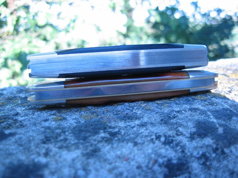

with a buck 303
Now the smaller blade is even thinner :D

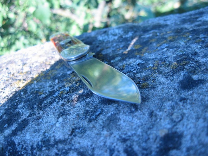

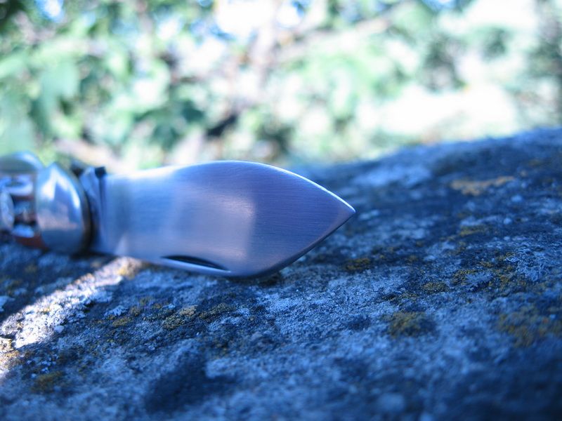

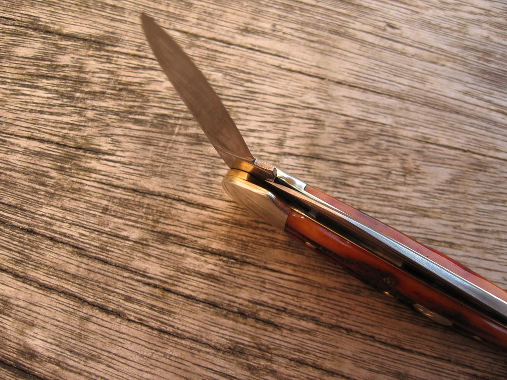

I rebeveled the main blade to an acute angle
It took time but is well worth the effort
It will be an amazing cutter
