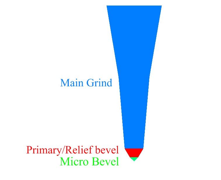

There are two ways at looking at your question, already in the answers you'll see what I mean. I think better terminology would have helped as some answers seem to be going at it from the final bevel point of view and others from the main grind point of view. I'm pretty sure you mean the latter as getting a concave final bevel would be an interesting and probably fruitless attempt. The confusion likely stems from the "multi-bevel" part of your question as sharpening gurus will tout the benefits in certain instances of micro bevels. Please excuse the very basic drawing, it'll just help with visualizing what I'm about to waffle on about!
This shows a micro bevel at the edge, also technically a mutli-bevel, but I'll be referring to the main grind.
As was mentioned, it all depends on what you're cutting and how. For example:
Large kitchen knives for vegetable prep, an understated, full height convex is your friend.
General day to day utility in a folder/small fixed blade - honestly a Moo point, you'll likely never notice the difference but I'd lean towards hollow and full flat.
Choppers (I mean competition grade wood-whacker types) convex again, basically a crossbreed between knife and axe for obvious reasons.
As far as multi-bevel grinds like Loveless' duplex grind, it all depends. If it makes sense to you instantaneously and you can see why it was done, it'll probably suit you. Some makers, do multi-bevels just for the aesthetic value. Multiple bevels are likely to add drag when slicing and/or force you to only use a short section of the blade at any one time. To get the faceted look, their thicknesses need to vary and on a couple knives I've seen it cause the grind with the lowest height to be very, very chunky and for all intents and purposes useless.
