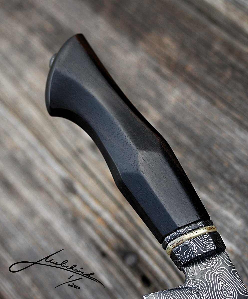

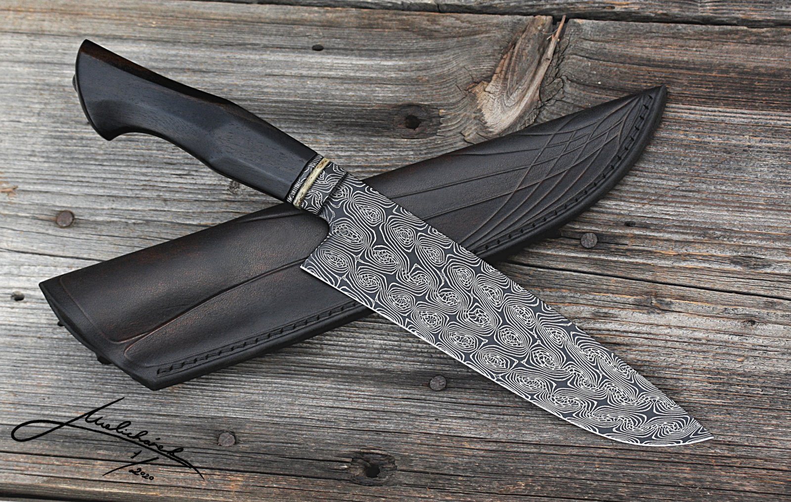

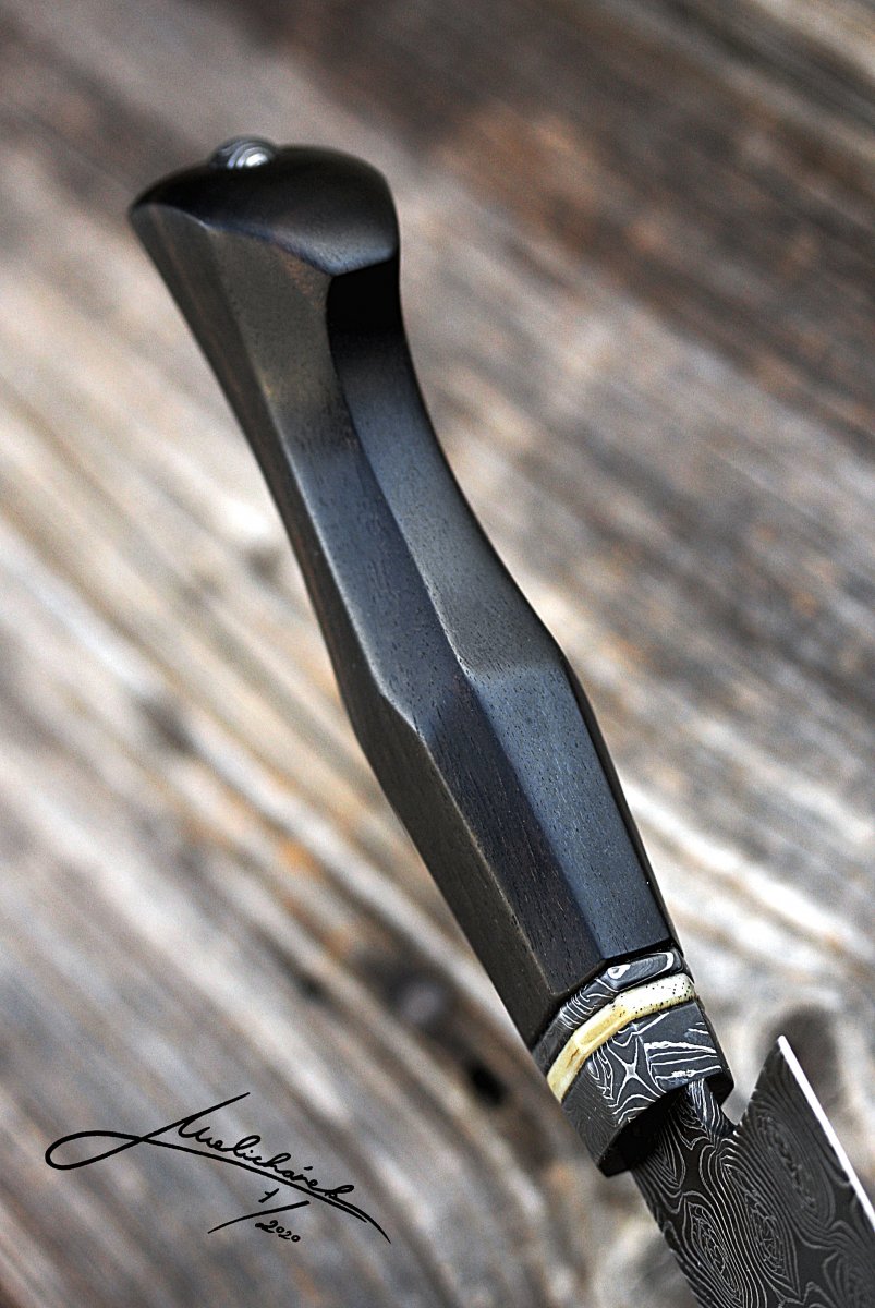

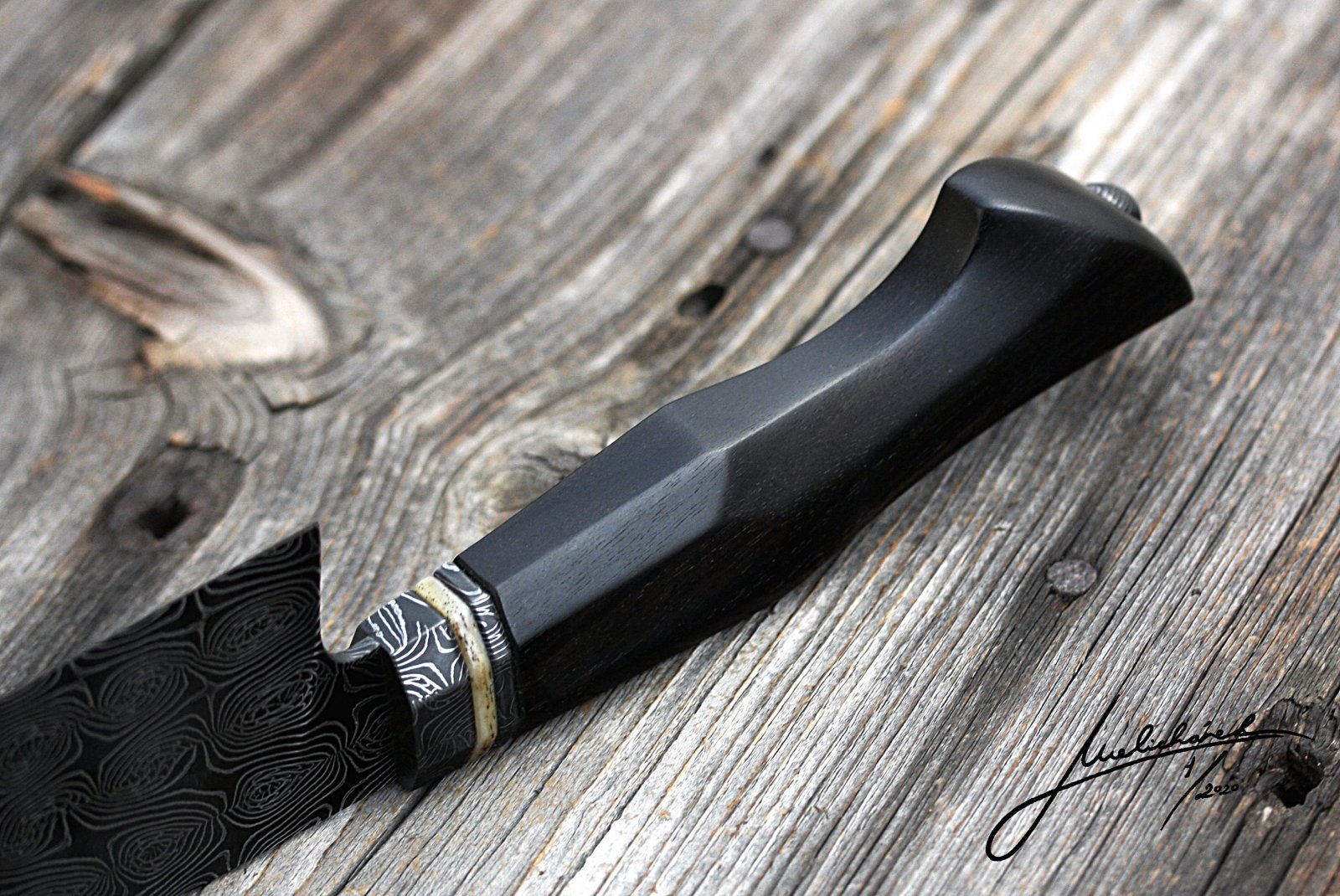

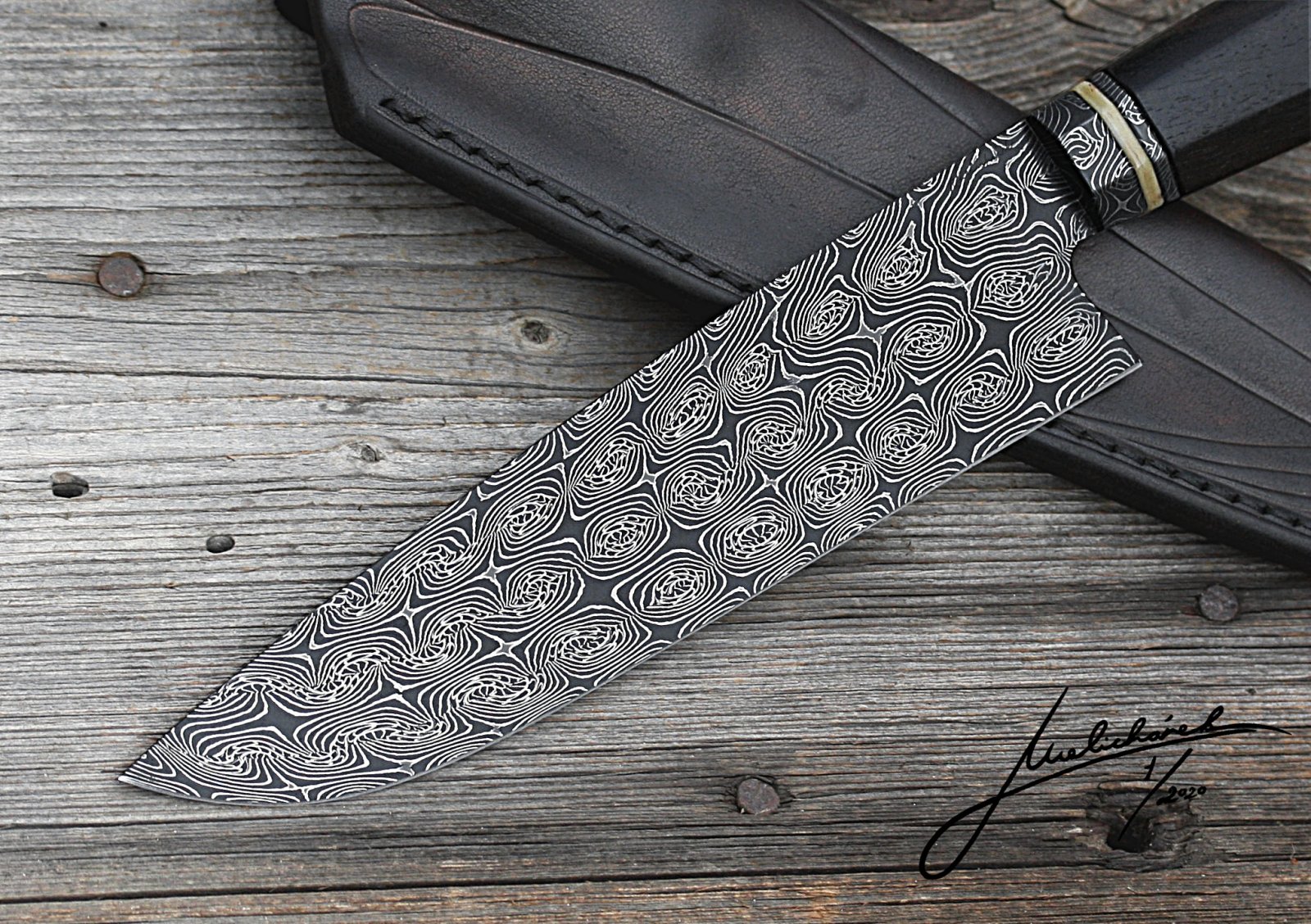

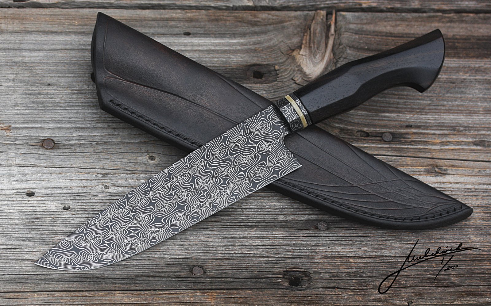

I just finished this a fancy chefs knife

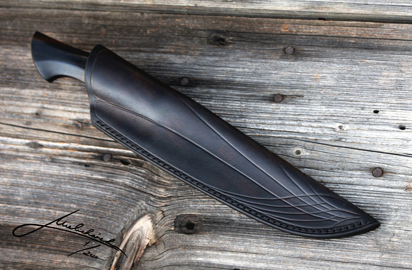

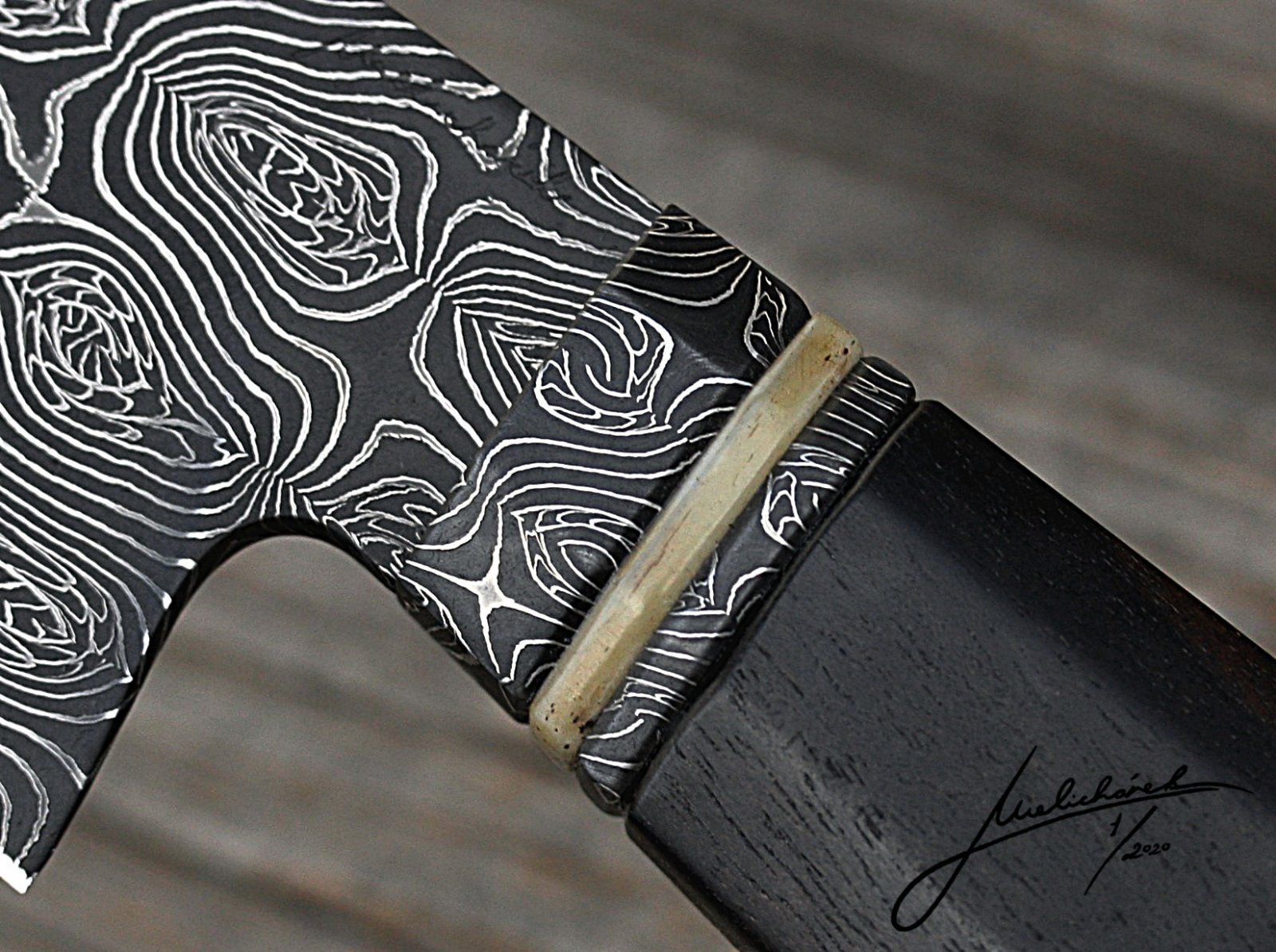

According to the customer wishes it was inspired by Africa and the Protea plant .. That should be found on different places of the knife . For example, in a damascus pattern, in that overlapped facets of handle, on a sheath etc. So hopefully he will like it and see you with more knives soon.
Petr
PROTEA

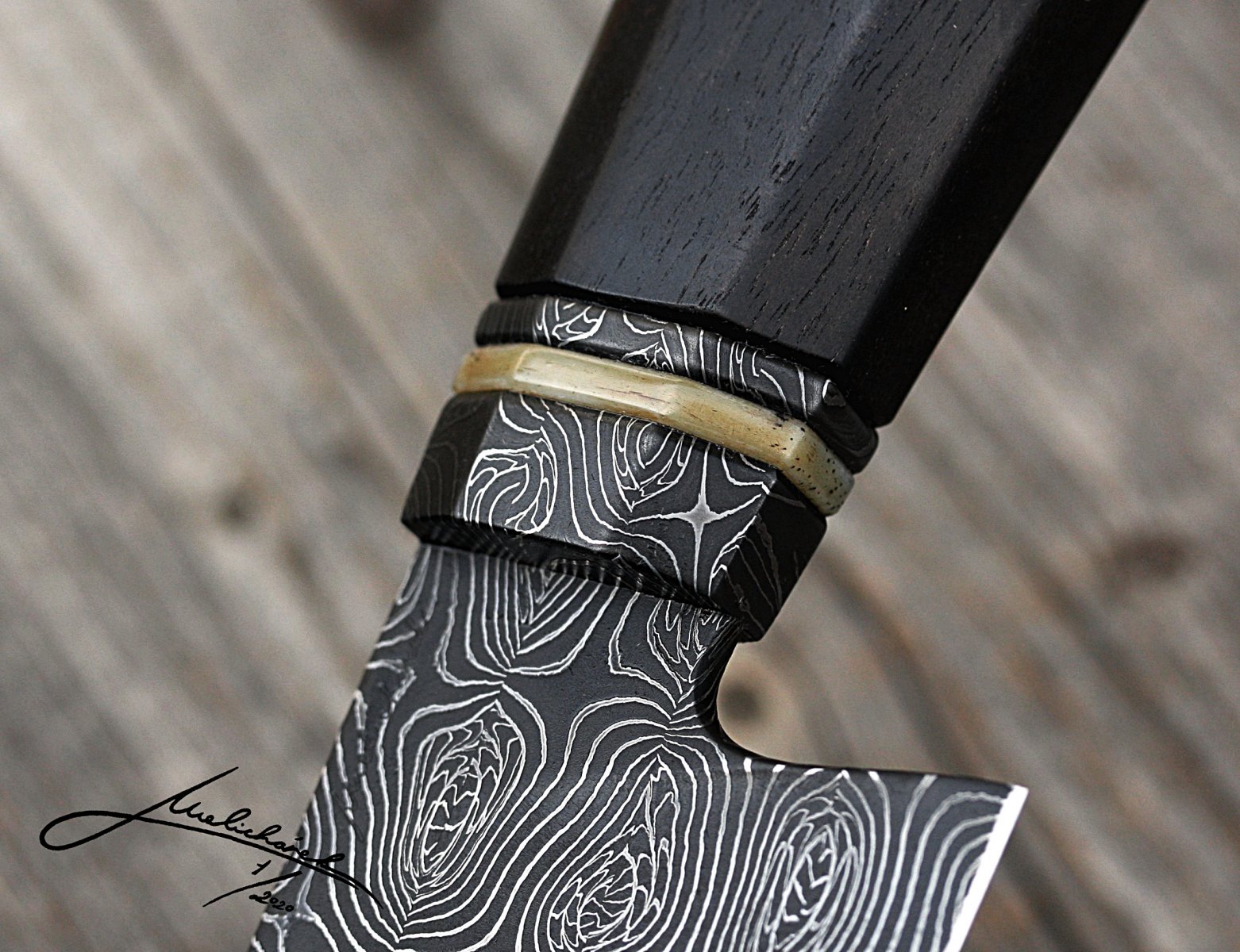

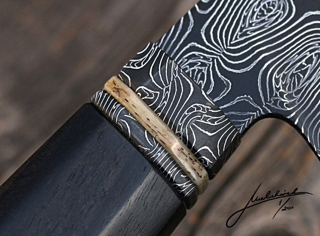

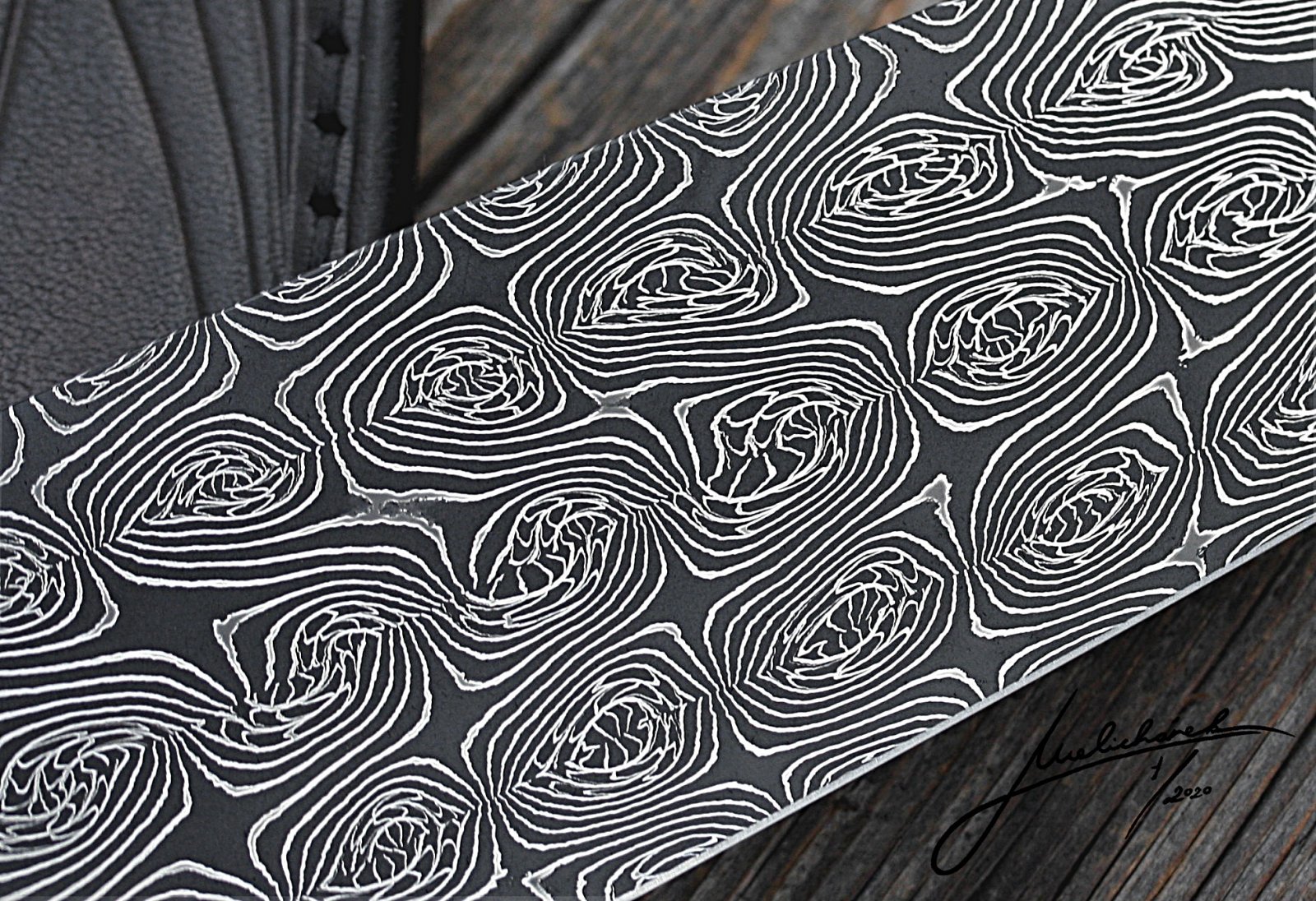

Blade - multibar twisted damascus steel 1,2842 (O2) + 75ni8 Uddeholm (15N20)
Guard - multibar twisted damascus steel 1,2842 (O2) + 75ni8 Uddeholm (15N20), Ostrich bone

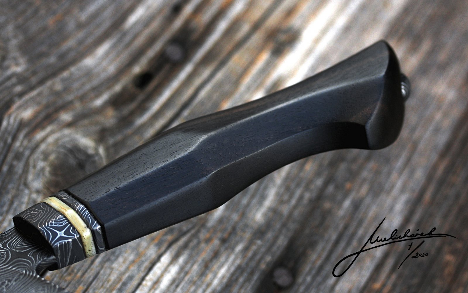

Handle - Ebony
Average length - 36 cm (approx- 14.2 inches) , blade - 21,3 cm (approx- 8,39 inches).
Blade width at widest point 50 mm (approx 1,97 inches) , blade thickness 3 mm -distal taper(0.12 inch) - distal taper.
