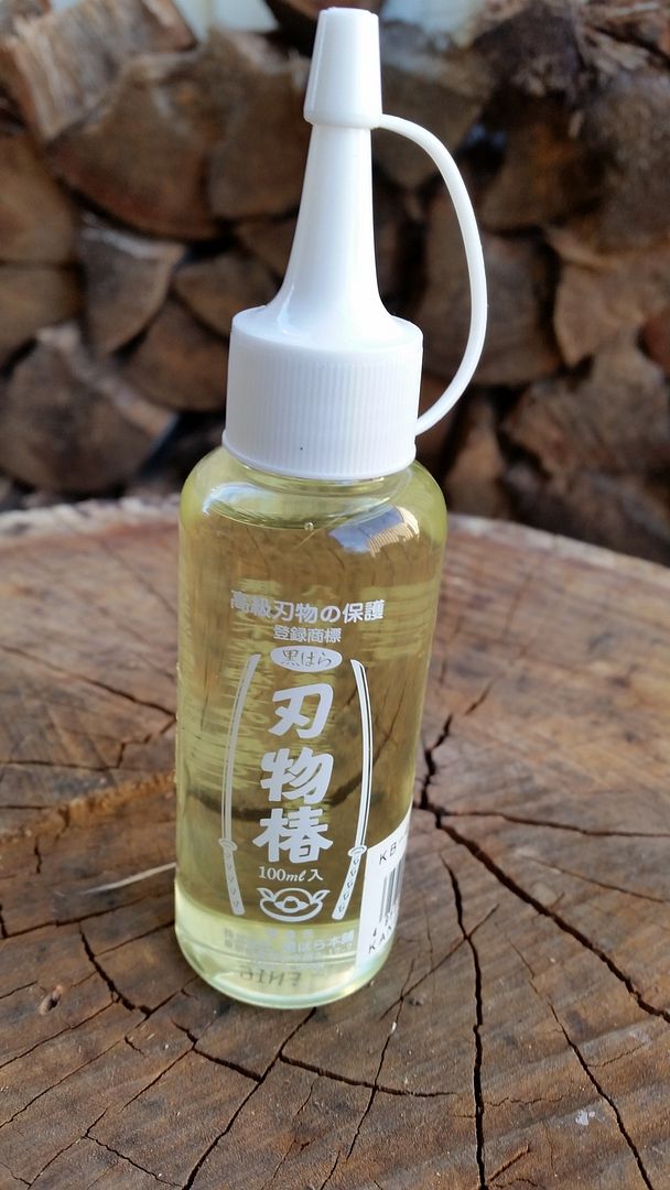

I use camellia oil as used by sushi chefs for them knives. I would have used 3 in 1 as with all of my tools only its not food safe. great video.
pros - food safe, does not go rancid and a little goes a very long way. I've had this bottle forever.
Cons - a little more expensive than your average mineral oil.

I only give a light coat of camellia oil to blades i plan on storing for a long time or safe queens, thats why that bottle is full still and may last me near a lifetime.

I just put a small amount of Camellia Oil on my cloth and wipe the blade down good and then put in my lined metal knife box
and I am good to go until further use and one of them is needed ~~ never have had a rust problem since I started using the
Camellia Oil ~~ Sushi Chef told me about the Oil many years ago.!** Great stuff.
