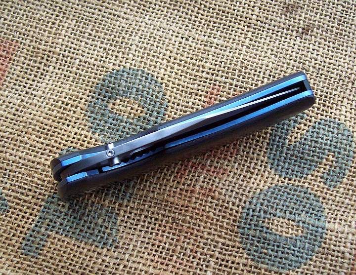

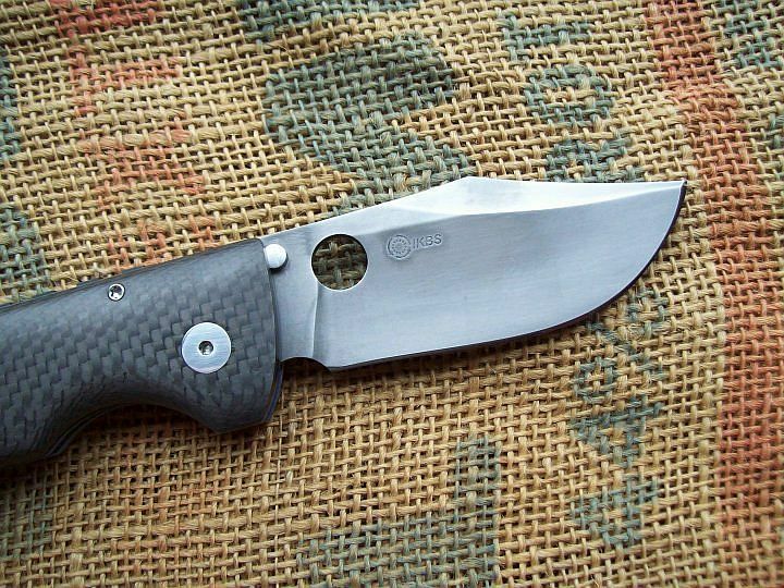

Here's a Proto-type project I've been working on.
The knife profile comes from my associate in Cali, Marcus Lin.
Like several of the other projects I've worked on with Marcus, I've had complete freedom in choosing IKBS for the pivot system, the fastener configuration and the "look" in general.
I haven't decided if I should incorporate a clip or a sheath, (something like the Spec-Ops Super Sheath) :confused: ;)
On to the knife :D
Specs:
  • Blade Etched W2
  • Pivot Captive 1/4" 416 SS pin from Alpha (GREAT PIVOT PINS !!) surrounded by IKBS :thumbup:
  • Liners Anodized .090 6AL4V Ti with 3/32" detent ball
  • Back Bar G10 with stainless 2-56 threaded inserts
  • Scales Carbon Fiber
  • OAL 8-1/8"
  • B. L. 3-1/2"
  • Weight 5.9 ounces
This knife is rock solid. Just a little blip on the spydy hole (fwiw, I've contacted Sal Glesser at Spyderco) or the stop pin, a flip of the wrist and the blade just flies out and locks up tighter than the proverbial drum ;)
Hope you like her ....................

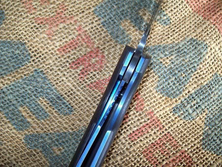

the photos of it taken apart are very cool:thumbup:
I think you did a great job with this one
Thanks Lorian. I did that to show some important features that weren't obvious when assembled. For instance, the (3) 2-56 flat head screws under the scales, the steel inserts in the G10 back bar, imho, an important component for long term use & abuse

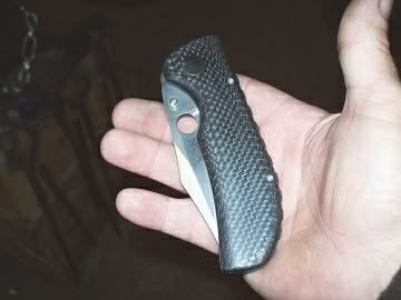

I REALLy like it. Love the small bowie shape. I hope to see you make some more of these! Can we get a knife in hand picture? I'd like to see how big the hole is in comparison to your thumb...sometimes bigger holes are easier to use.
Thanks :)
Give me a minute or so and I'll get a pic up for you :thumbup:
And you bet I'll be making more !! Many more !!

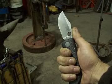

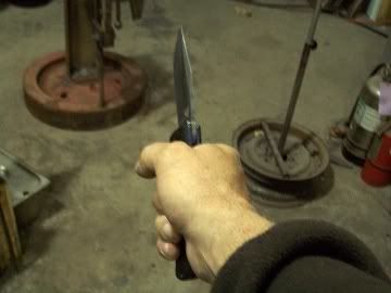

Here are the "in hand" pics you requested. FWIW, the closed length is ~ 4-13/16" or ~ 4.812" long
This knife is beefy and very solid. Just for reference, the spydy type hole is 7/16" or ~.437 in diameter.
Thanks again guys : )
If you have anymore questions please don't hesitate to ask ;)
