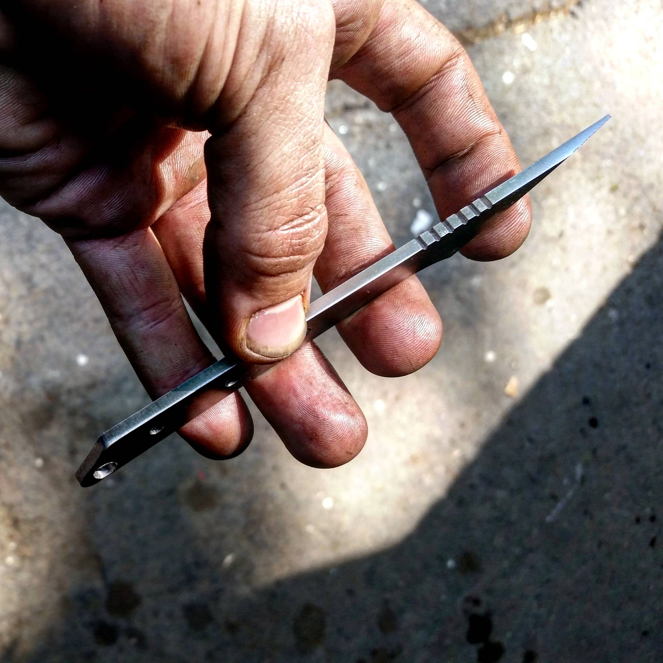

Hello everyone. I decided about a month ago to get into making knives. Sharpening is in the family and was a tank grinder at a large stainless shop so I suppose it was inevitable. So let me get to it.
I've decided to make a left and right Kiridashi pair for my first knives (I know, I know.. start easy and get your mistakes out of the way). I'm progressing well, but I seemed to have hit a little rough patch. I'm trying to make a recessed scale on both sides that are near identical. I've made the shape and ground bevels, but I need to heat treat (yikes!) and make the handle scales flat and even.

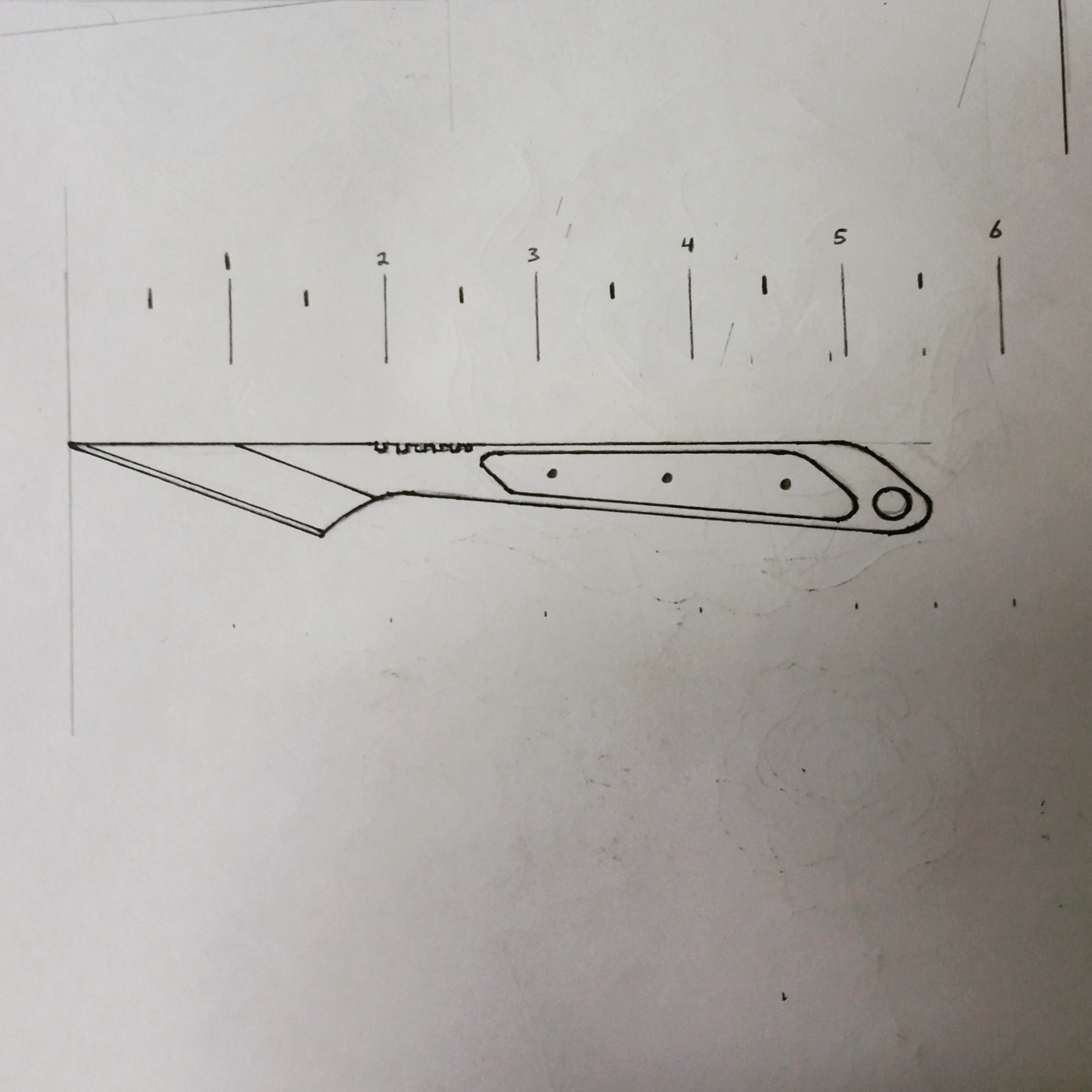

Here's my design
I thought could maybe mock up a 1/8" steel piece the same size as the scales and use that on my belt grinder to form them and then put them on the actual knife. I know I could just eliminate the recessed scales.. but that's just not in my nature.
Any advice is helpful, I'm in uncharted waters lol! I've seen this done a lot and I'm interested in how it can be done with minimal tools. I do however, have the basics; drill press, 42" belt grinder, bandsaw (that's giving me issues).

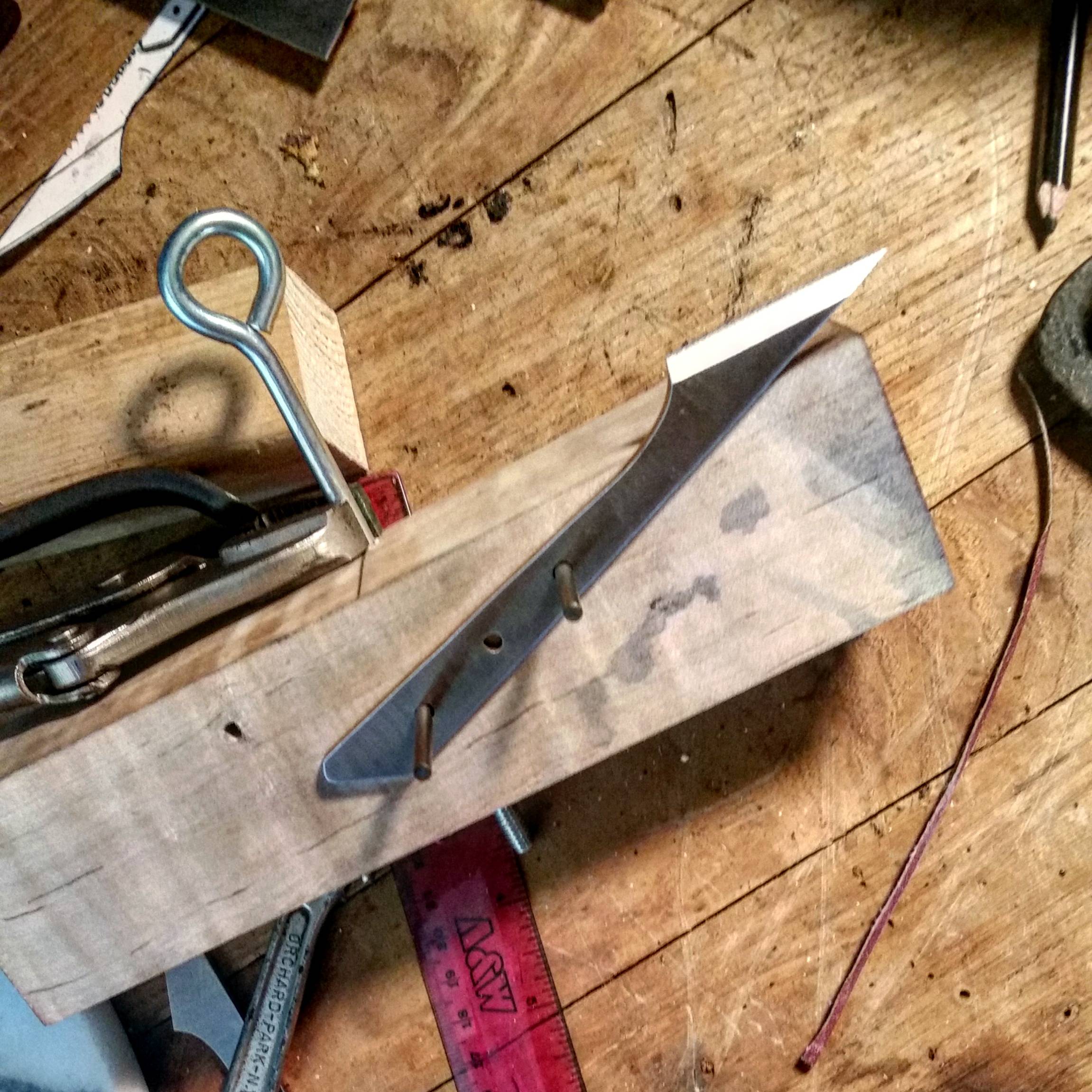

As of yesterday
And today

You can just grind the scales down to the tang on your actual kiridashi, then use calipers or dividers etc. to scratch a line about 1/8" in from the edge of the scales ( or however far in from the spine you want the scales recessed) , then take them off of the knife and pin the scales together and grind them down together at the same time to that line. :)

So simple, I feel silly. thanks man.
I suppose a coat hanger will suffice for temporary pins.

A pair of bolts and nuts will hold the two scales together while shaping them to match. You can slide the bolt ends through the tang to check the look and spacing for a quick check.
