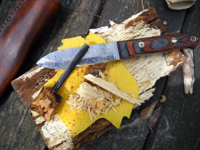

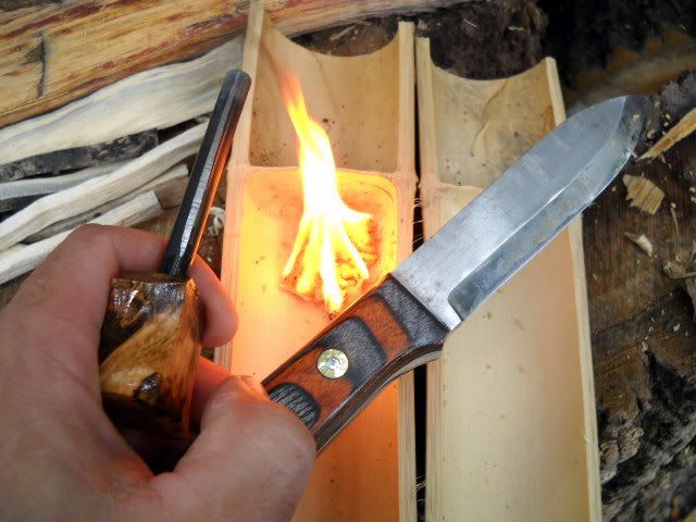

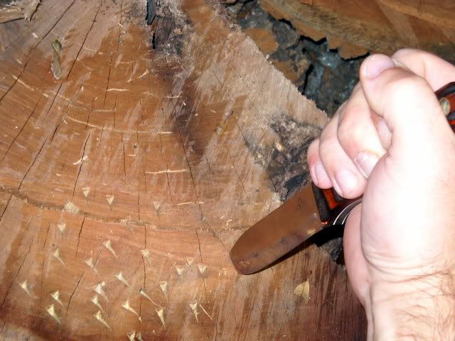

I started making knives a few months ago, and decided to do a pass-around of one of my 'bushPick" knives on a bushcraft forum I'm a member of. One of the guys in the pass-around did his testing today and really wrung out the knife. It survived, except for a small chip in the handle near the pommel. I'm really thrilled at how well it held up!
Anyhow, I got his permission to re-post his pictures here.

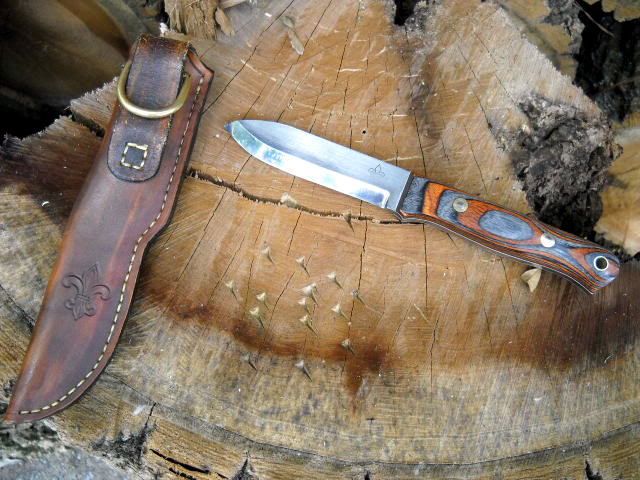

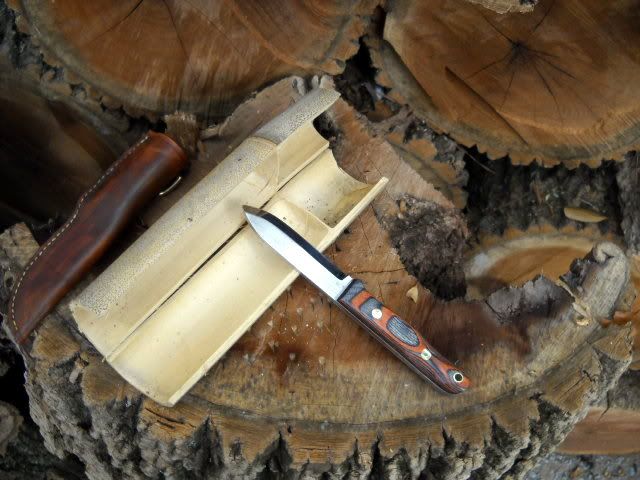

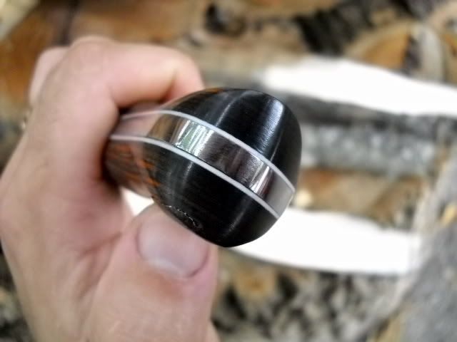

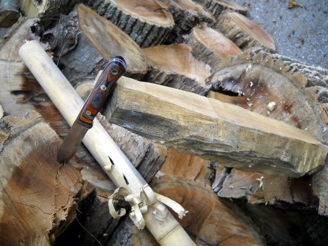

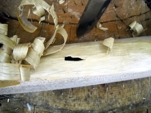

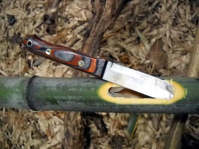

Here you can see the split. I assume this is from batoning the knife on the pommel to drive the tip into the bamboo. In his own words, "not a big deal". It's a failure of the dymondwood itself, not my heat treat or construction methods. (Though I did ask the folks testing the knife not to baton on the handle.) I'm glad it made it through with as little damage as it did.

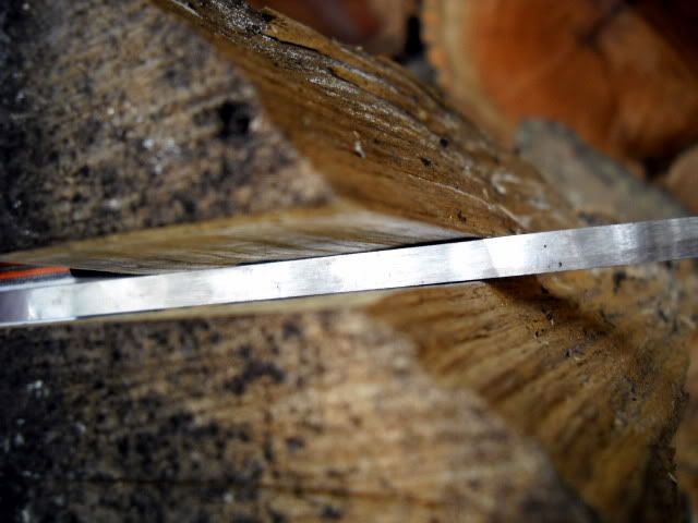

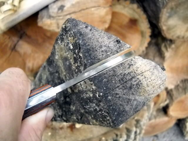

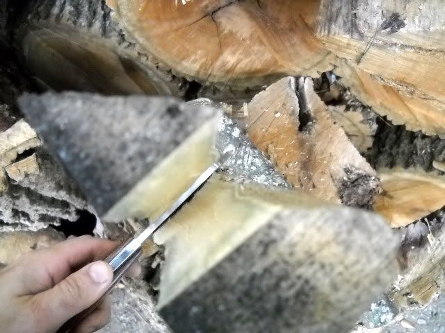

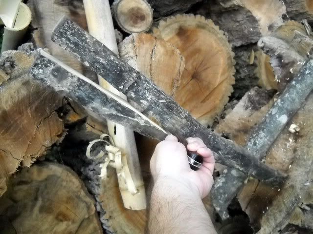

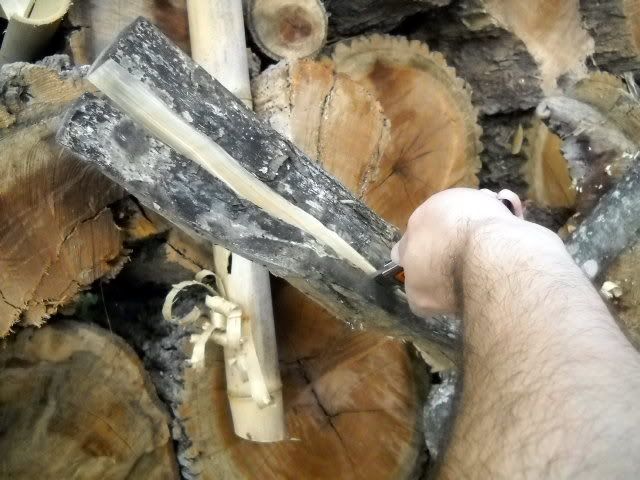

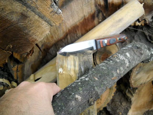

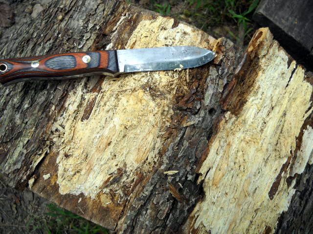

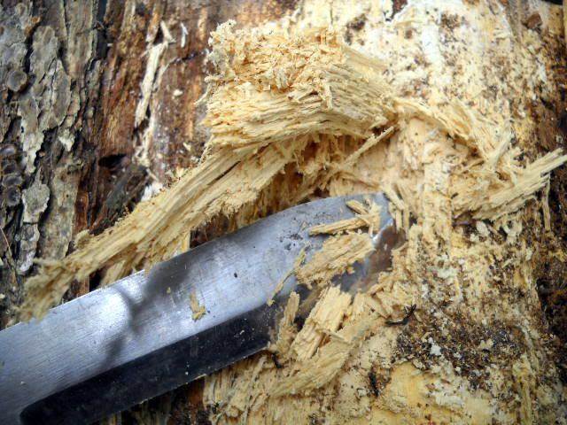

Here he actually uses a wooden mallet to baton the knife into some punk wood...

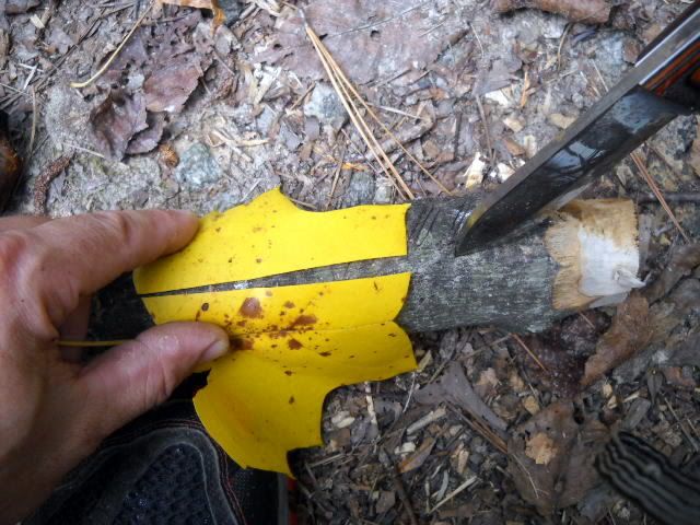

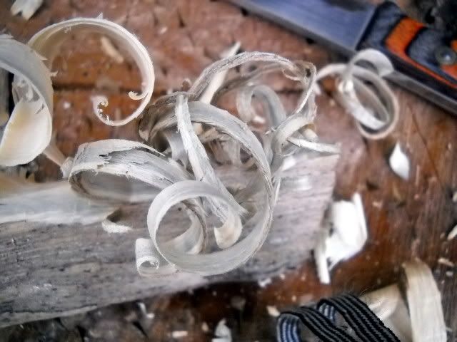

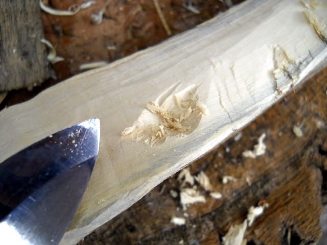

He said after all this it no longer shaves. But he will strop it.
Overall I am pleased with it's performance. It handled a severe beating and didn't chip, roll or snap. The handles stayed glued on, and it did well overall. Now it just has to make it past 3 more testers! :D
Nice knife! The guy who did the testing sure did a great job at documenting it. What steel did you use?
Great looking knife. Specs?
Thanks!
It's 9" overall with a 4-1/4" blade
3/16" thick O1 steel
white vulcanized liners
cocobolo/black dymondwood scales
brass/stainless Loveless bolts and a brass lanyard tube
Well done! Looks great. Like those handle scales too. What material is that?
The scales are dymondwood. It's a great, stable material made from layers of color dyed laminated birch and can be had in all kinds of colors from single colors to horrible garish rainbow colors. It's used on a lot of gun grips, and unfortunately got a bad reputation as a cheap material despite it's excellent properties because a lot of cheap "Made in Pakistan" knives were imported with dymondwood handles.

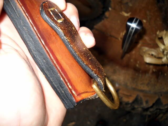

Beautiful knife and sheath man! Your friend took some great pictures - looks like it really held up well!
