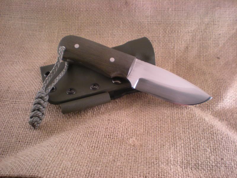

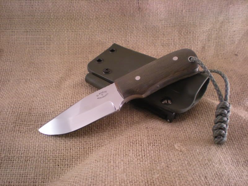

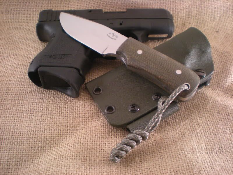

Here's a little one that I just finished for a customer. Well, almost, the sheath was too tight and the choil wore a groove on the inside making a white mark on the outside of the sheath so I'll be redoing that tomorrow. Let me know what you think!
Blade: Flat ground 3/16" O-1, hand sanded to 600 grit
Heat treated by Peters’ Heat Treat to RC 59-60
Handle: O.D. Green G-10
Pins: Stainless Steel
OAL: 6 3/4"
Blade Length: 3 1/4”
Sheath: O.D. Green Kydex with firesteel holder
