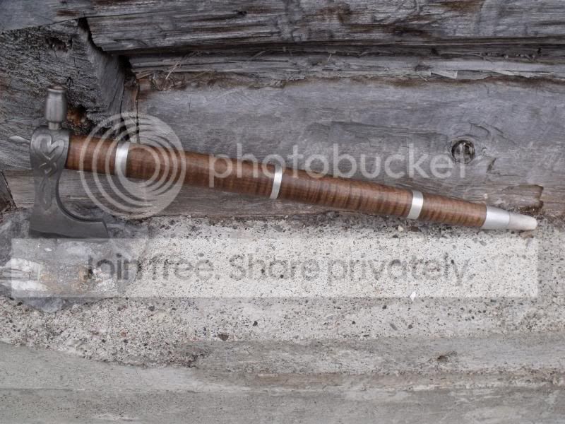

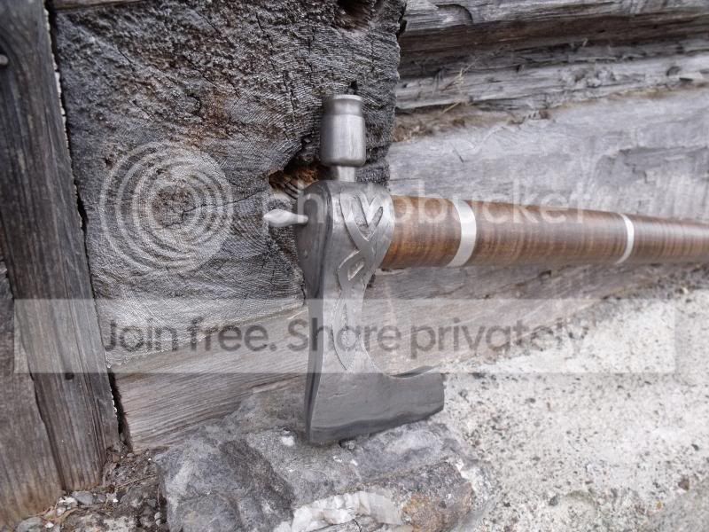

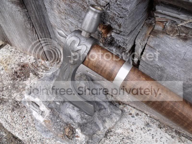

Well I finaly got time to finish the puff and chop as it was dubbed on another forum .
The head was forged from wrought iron with a file bit in the wrapped method.
O.A.L.is 24 1/2" and the head is 7" tall with a 3 1/2" bit.
Cast in place pewter bands with pewter and antler mouthpiece.
Cheers Bob

I know this is probably like asking a trade secret :eek: but how the heck do you do that, (the carviing I mean)?
It appears to stick out which to me says the metal around it was removed. How in the world do you smooth out that area around the carving and not destroy the carving! That looks like untold work too me but I like it! :cool:

The carving was done with my dremel and a lot of carbide burrs. I found out that the silica which there is lots of in this wrought eats burrs:eek:. But once i started it there was no turning back. Then i smoothed it with the trusty files and sandpaper so no secret just a lot of hand work.
Bob

Actualy the image was very easy i drew it up then scanned it then sized it than opened it in m.s. paint and printed the image.
Than i cut it out and crazy glued it to the hawk and cut the material around it:p.
