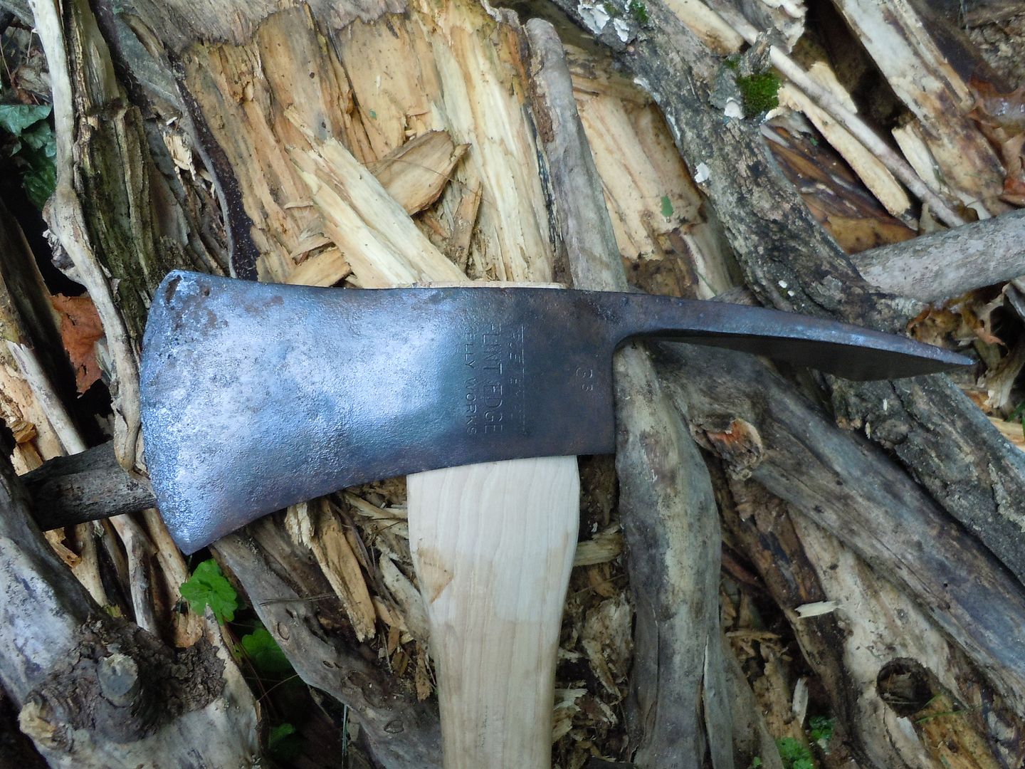

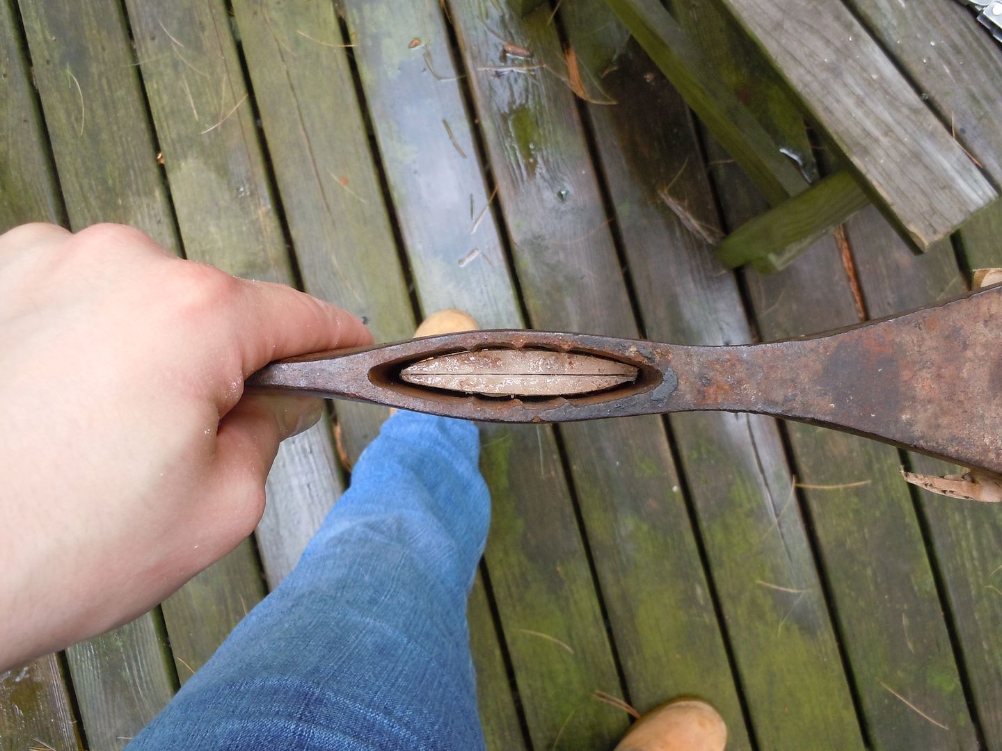

So went to lows for a few things today. Came across the Axe handles section. Didn't have much, did have some nice Ames 36" ones. All in the good category, I picked the best one, also took the best wedge from the lot (shhh)
The eye shape was real close to being true as well. Made for short work shaping.

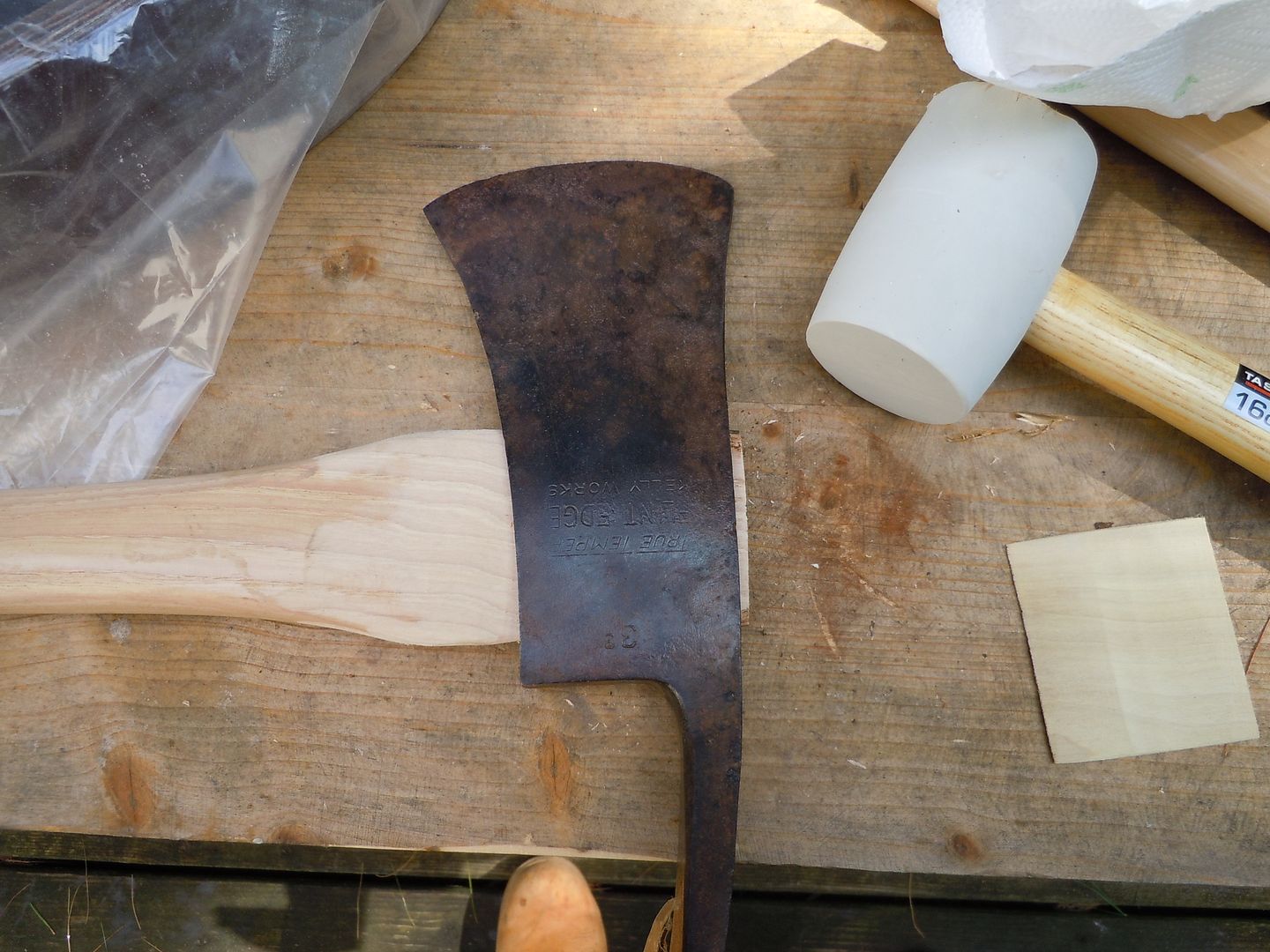

Ok grain
After the third fitting, trued up. After I get to sanding this the shoulders will meet the head.

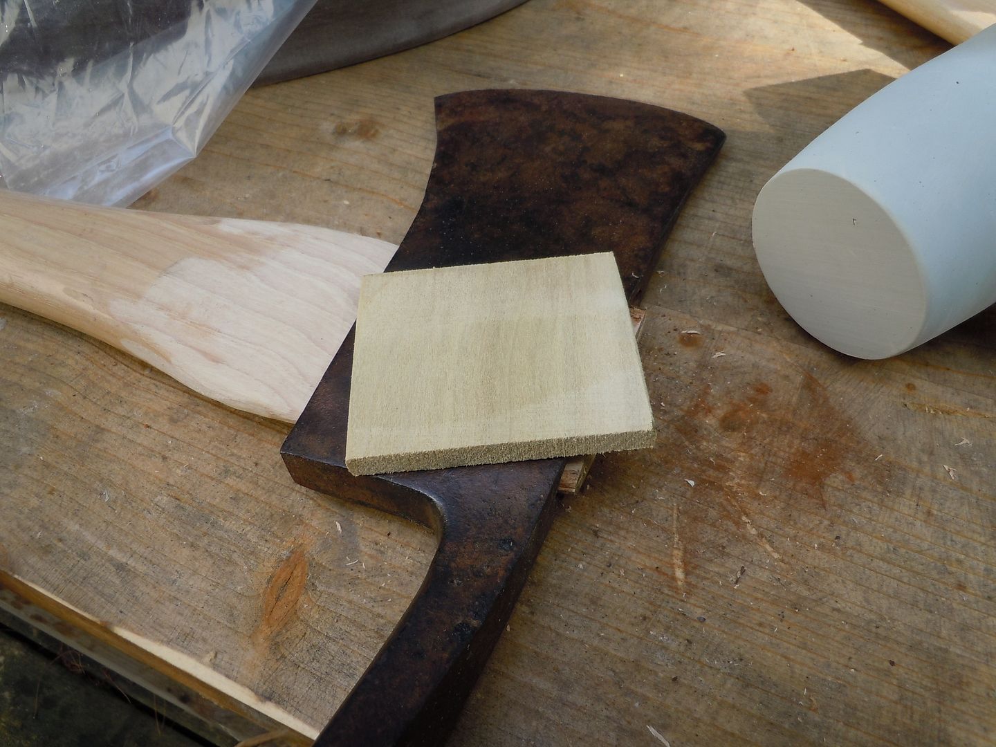

Getting the wedge ready

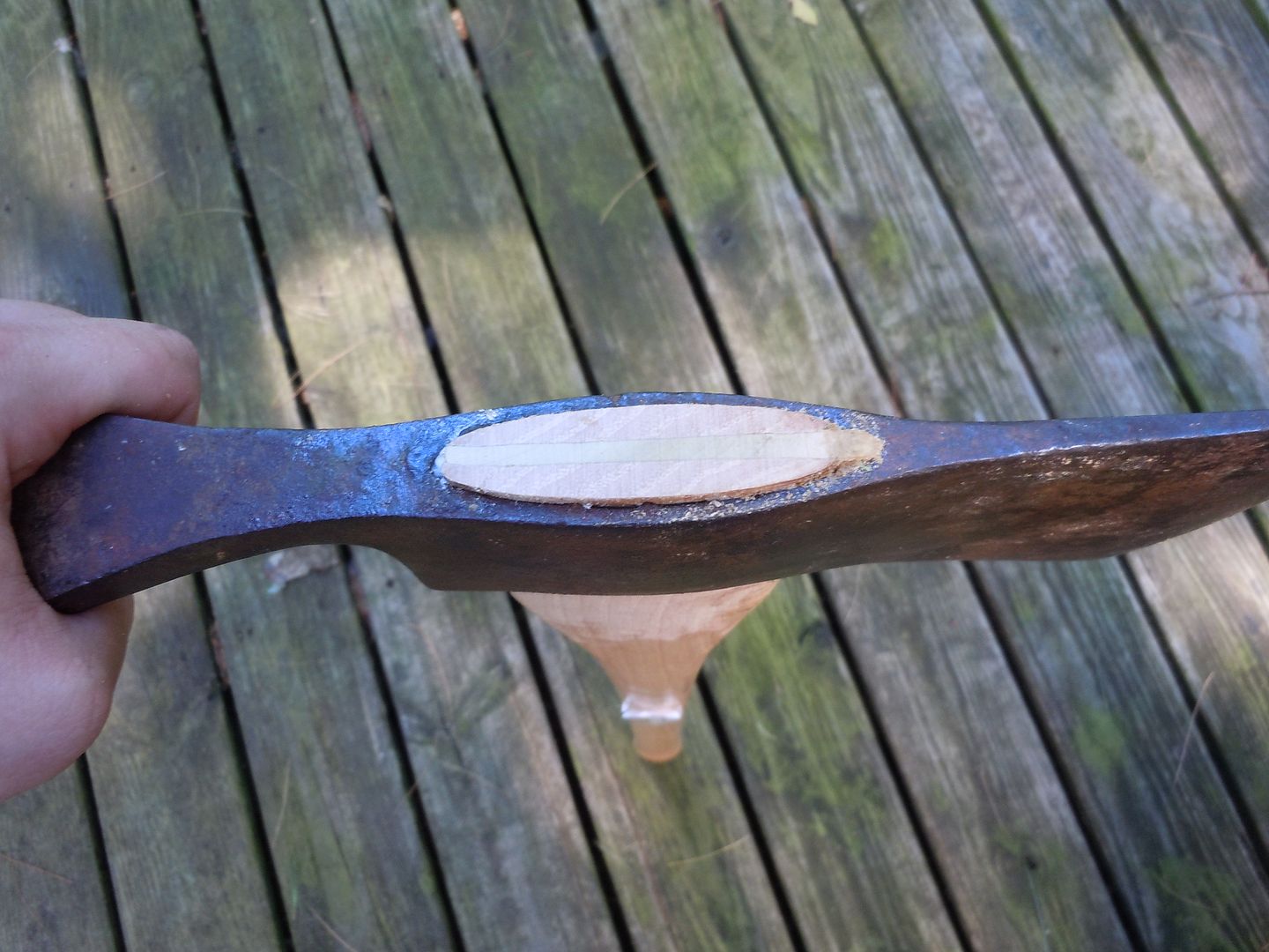

Drove the wedge home
