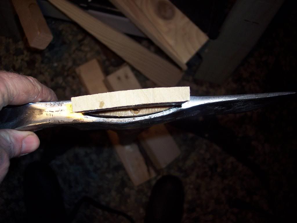

Picked up a long double bit wedge that fit the entire length of the eye:

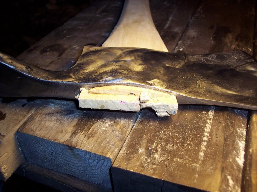

taps with the wooden mallet:

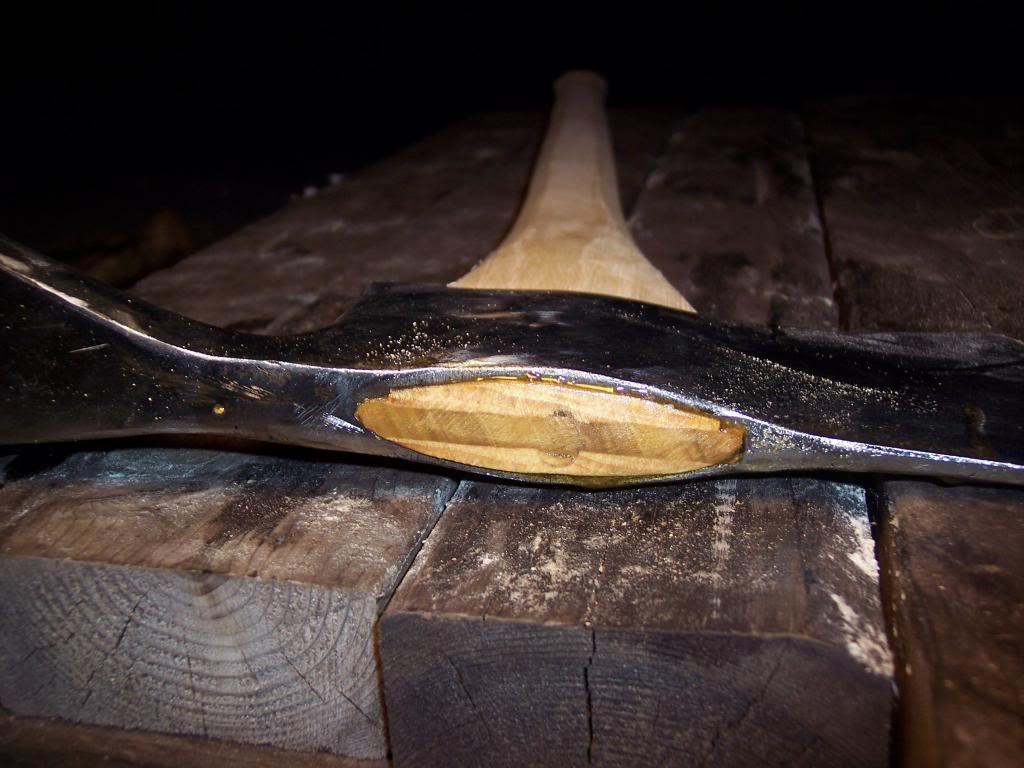

finished:
I will be staining the handle ebony.

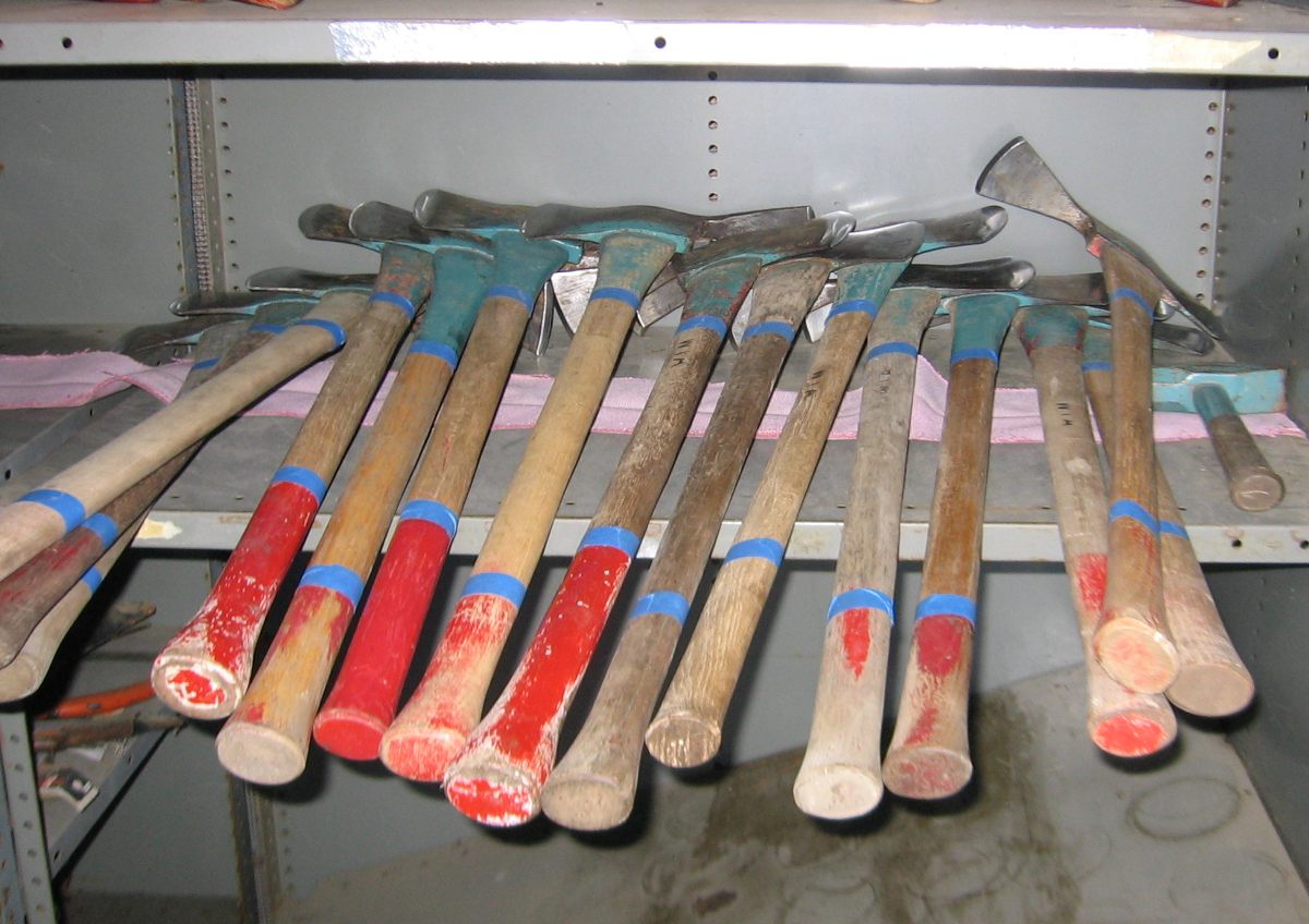

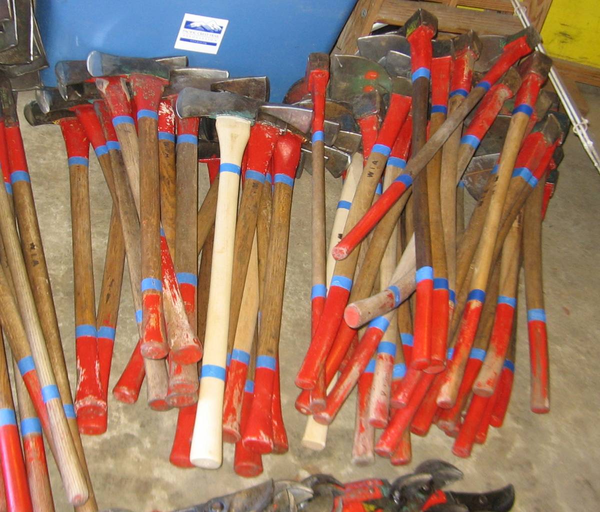

Today was tool sharpening day for the Washington Trails Association. I must have sharpened 30 Pulaskis.
These get severely abused by volunteer trail workers who often don't have experience with such tools. These don't get the care that I take with my own tools or the DNR tools. There just isn't time. After sharpening we mask off the handles. More volunteers will then re-paint the handles so they're easier to find in the woods.
