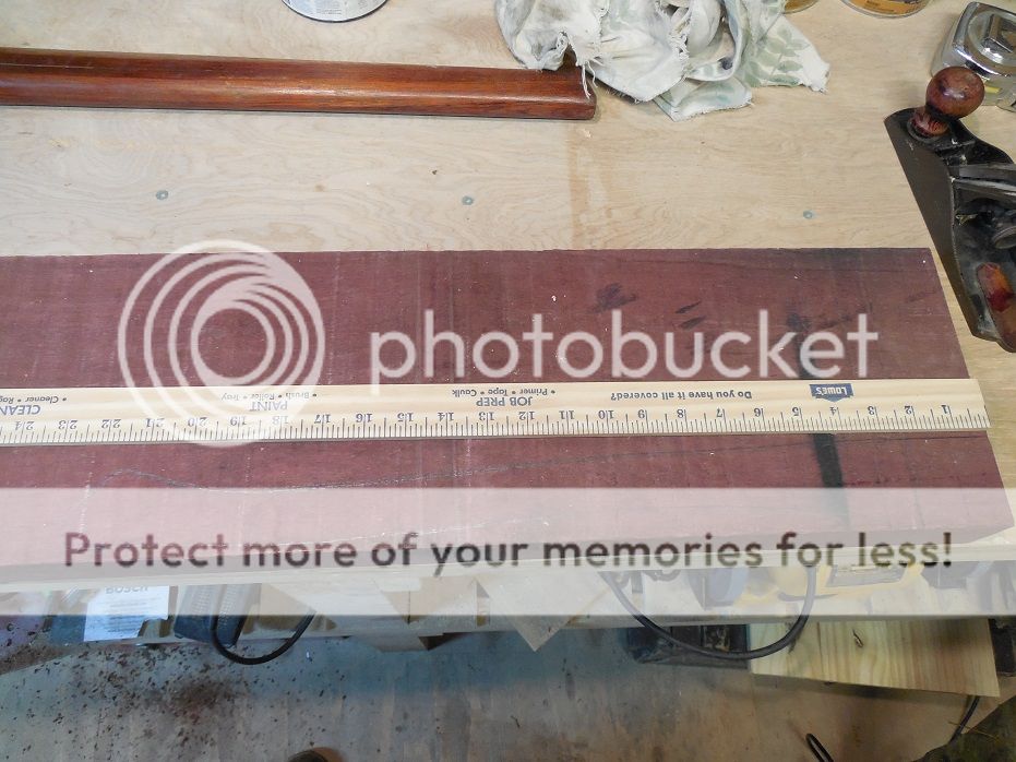

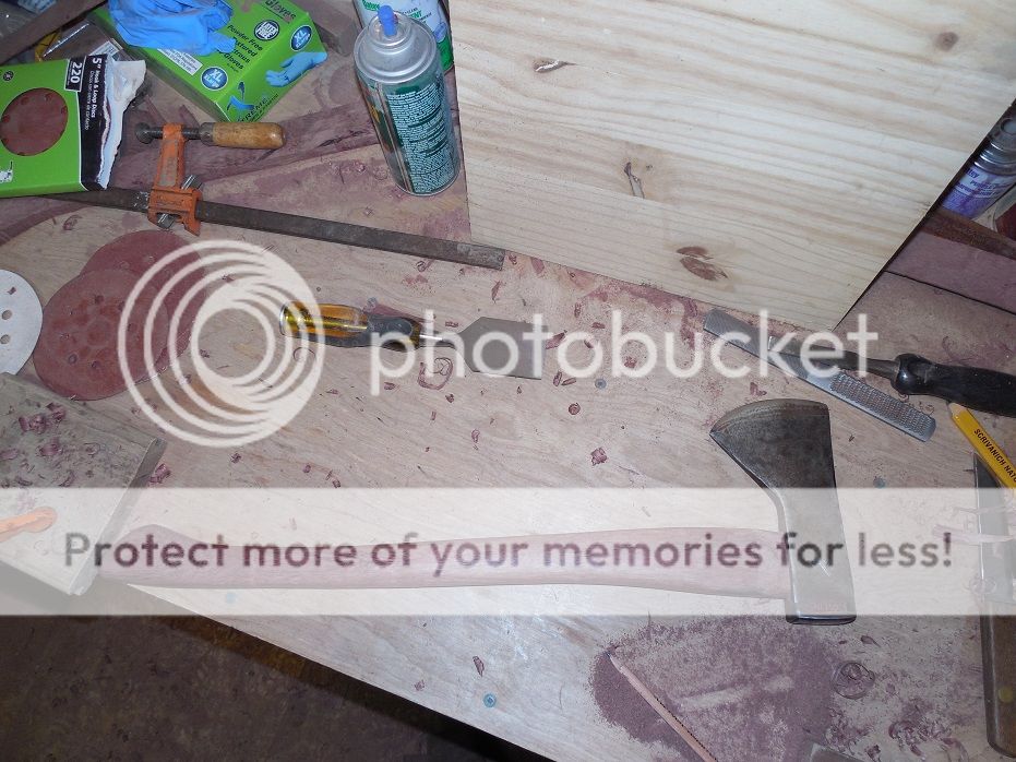

So all the discussion of late about what to make a handle out of finally got the better of me. I came across a slab of purpleheart with excellent grain yesterday at a not exorbitant price (If I can get three handles out of it I'll break even with buying three from the hardware store) and went out in the shed and made a new handle for an old Collins HB I had. For anyone else who wants to play with purpleheart, wear gloves and at least a dust mask if not a respirator when sanding as the dust is not so good for you (it's mildly toxic but nothing to panic over unless you're allergic) it also tends to give you lots of little splinters until you get to the final sanding so.... gloves. One of these days I'll get a bandsaw and a vise but until then improvisation is key.

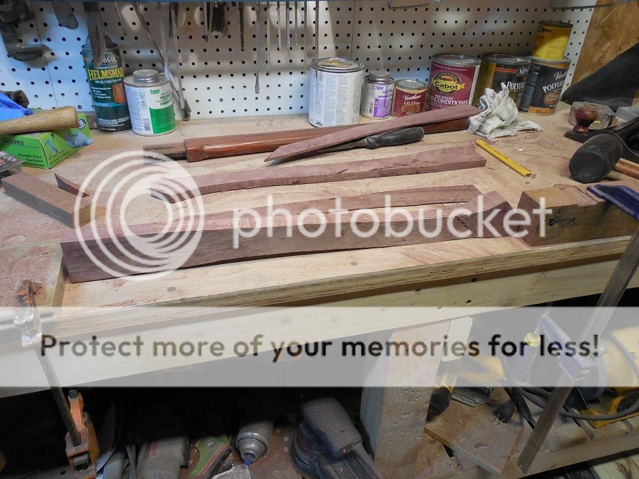

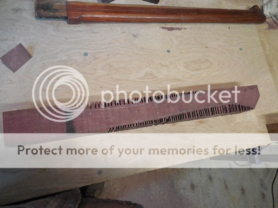

Doing curves on a table saw...

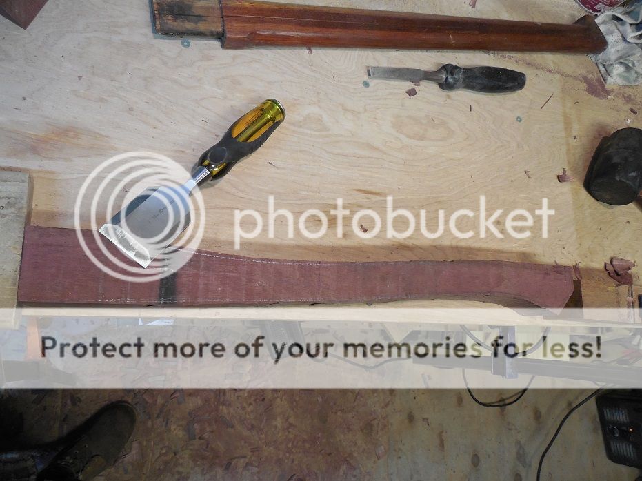

Some chisel work.

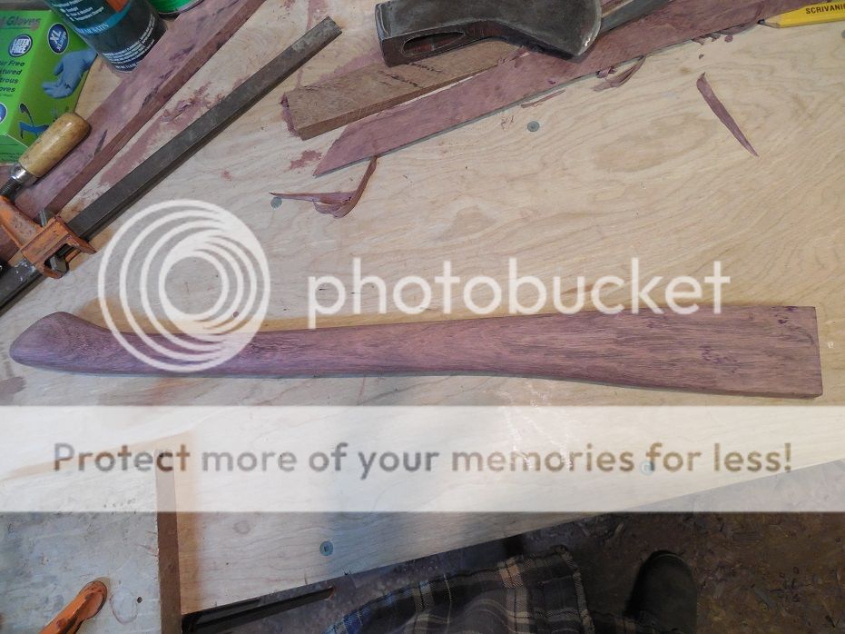

An ungodly amount of planing, rasping, and sanding later....
Cutting the kerf. (did I mention I need a vise)

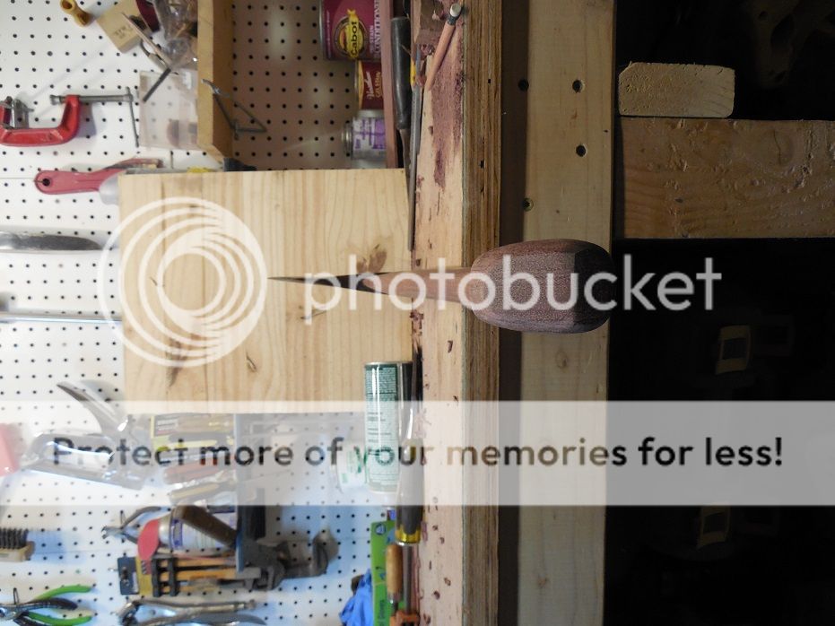

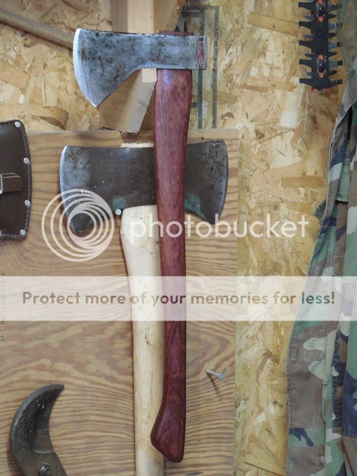

Hung, oiled, and waiting to cure.
Next step is to take it out and abuse the hell out of it and see how the handle holds up. If it works out I'll try making a full size handle out of the rest of the slab.

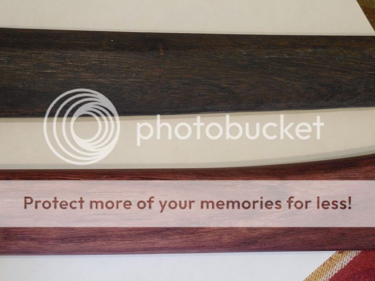

The thing is I've never treated the wood with BLO before. I know that there's a lot of little knicknacks, jewelry boxes and such, made from purpleheart that get varnished and the wood keeps it's color so I'll just have to wait and see how it reacts to linseed oil.

In the second picture above you can see the old mahogany handle which split down it's length under use. I made it back before I gave much thought to grain orientation. When I get some more daylight free time I'll take the new one out and attack the cedar stump.
Here's a better picture of new purpleheart vs. 10 year old untreated purpleheart.
