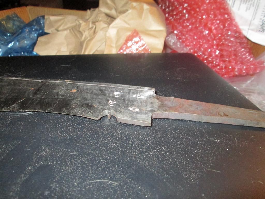

Bawanna - I'll keep that in mind. And yea, I was quite happy with what I saw in there for the tang - it's WAY more substantial than any other similar tang I've seen. Like 3/4" wide and well over 1/4" thick then tapers back gradually. If the tang broke anywhere near the blade, I'd be surprised. I normally prefer full tanged knives, even though I mostly do scandi rat tail stuff, but this one is nice. HI is so awesome with everything I've gotten from them. This one has a 12.5" blade btw. I'm really considering keeping it, but I'll let you know if I decide to let it go. Still waiting on some suggestions for handling it before I decide to let it go or not :-p the main problem I'm having is the bolster - what do I do for that? The butt I can probably figure out, though I'd like some suggestions on that too. And also traditional handle / something else?

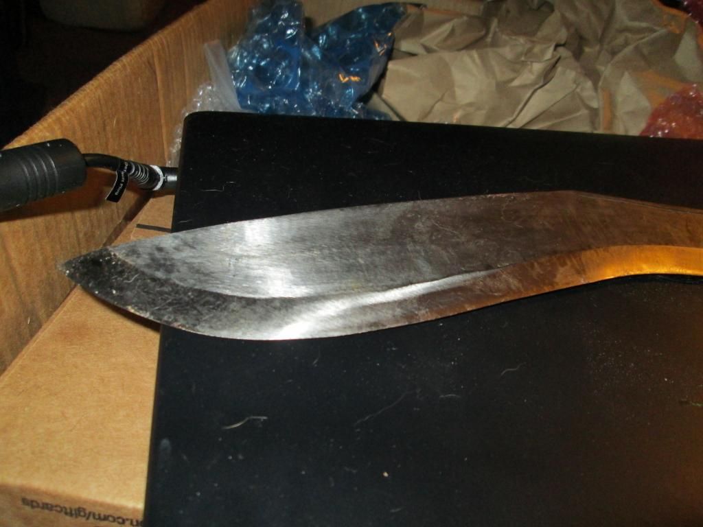

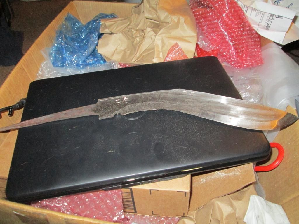

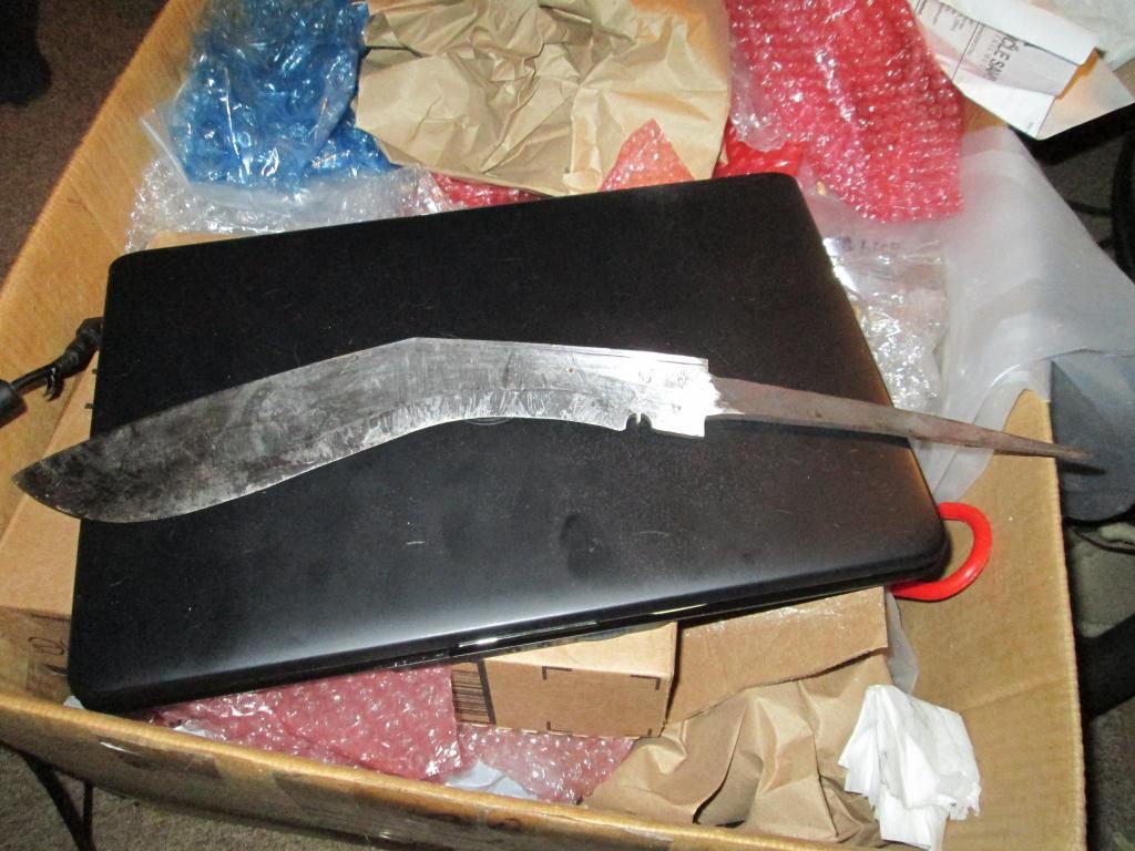

Pictures of the blade btw
That blade look more like a WWII than an ang khola.
Make your own micarta it's easy. Fiberglass resin and any cloth or paper will do.
I've got my WWII out with it and though it looks like it, it's a little different - it might be a WWII, but I thought I remembered it being called a Ang Khola? I've been trying to find the posting where I bought it, but I can't. I was trying to see how much to ask for if I did sell it. Kinda toss-up right now really. :-/
