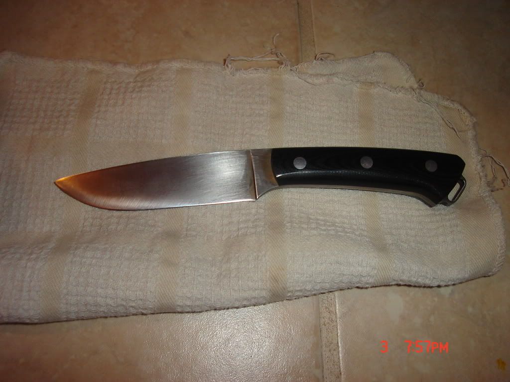

now what you need to do is lay your knife on a towel like so

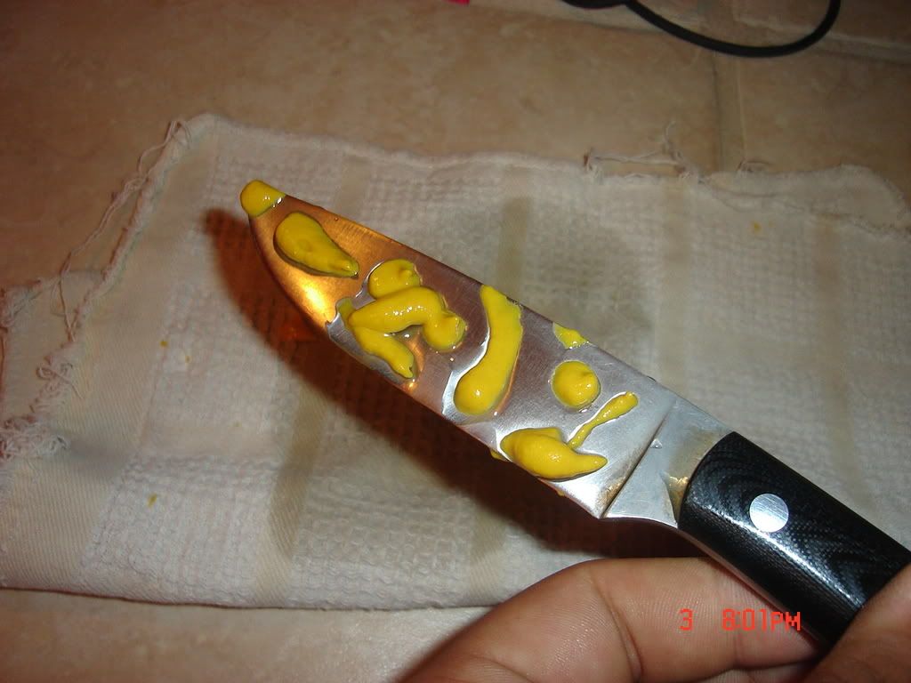

then you take the mustard and put your own art on the blade
then you take the vinegar and pore it one the blade like so
then you let it sit for arounf 45 min to a hour
then you do the same thing to the same side i will show the pinta forcing results later in one of my youtube videos i also hope this helps guys ;)

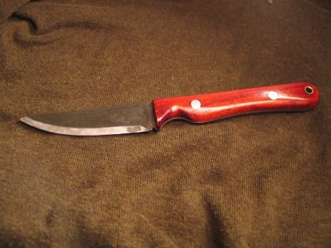

Masteroffajitas, the patina can help to protect against rust. It is a thin oxidized layer that sits between the bare steel and the elements, helping to inhibit further uninvited oxidization (rust / pitting).
I'm partial to a more uniform patina myself, which is one of the reasons I force it rather than allowing it to appear naturally.

I'm partial to Brownell's cold blue myself. Not traditional for knives, I suppose, but it does work pretty well.
