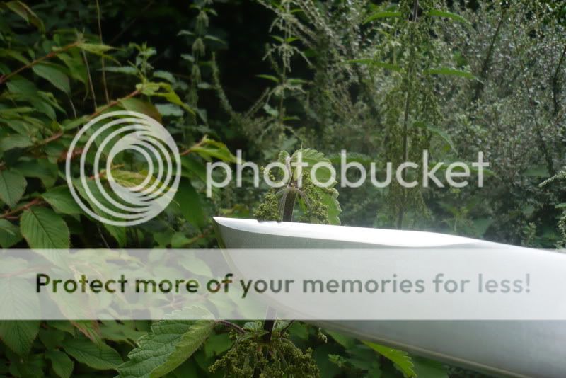

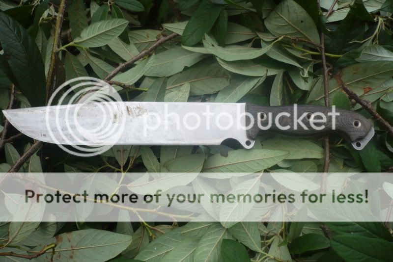

So I decided to make my own Bowie ... my BWM CG seemed the obvious choice .... it is light and versatile and is more or less shaped perfectly to give it a sharpened clip .... so here it is ...

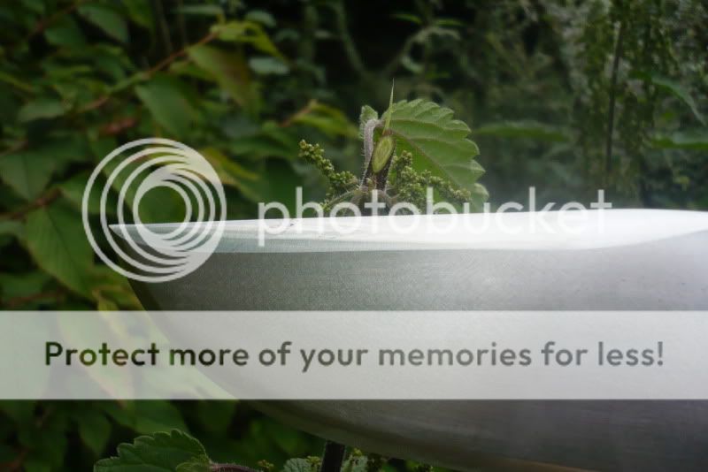

The clip is VERY sharp .... designed to be functional so I can use it clearing weeds and brush ... a task the BWM is just about perfect for ... the clip easily slices free standing weeds ....
and can go through fairly thick branches ... it cut the limb the knife is resting on in the pic below and did the side branches ....

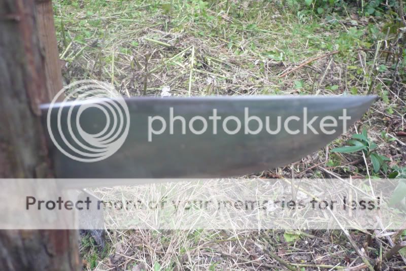

The BWM CG has always been a great chopper for it's size and weight and working with it today was a real pleasure .... to see how the clip point held up to being batonned I picked some nice long sections to put it through ....
As a tip or technique I try and keep the blade facing upwards to give a flat striking surface for the baton ....
The baton was taking the hitting of the clip fine ... and the clip's edge was unaffected .... still as sharp as it was at the beginning ... "Infi magic" :D

I just used my old belt sander and a new blue zircon belt for the stock removal ... then polished it a little with some older belts gradually going up in grit to blend it in .... cooled it regularly in water ... and just checked it by eye to make sure it is consistant either side ... it is not a hard job in fairness ... and works best if you keep the spine/edge in view rather than inverted as you do when sharpening ... the belts going against the edge is'nt a problem if the angles are right ...
