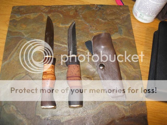

If you can get birchbark it's pretty comfy too.
I laminate it in 2" blocks in pipe vices, with wood glue between each layer. Then just assemble the knife with blocks of birchbark, wood, antler, and brass or aluminum (and epoxy).
