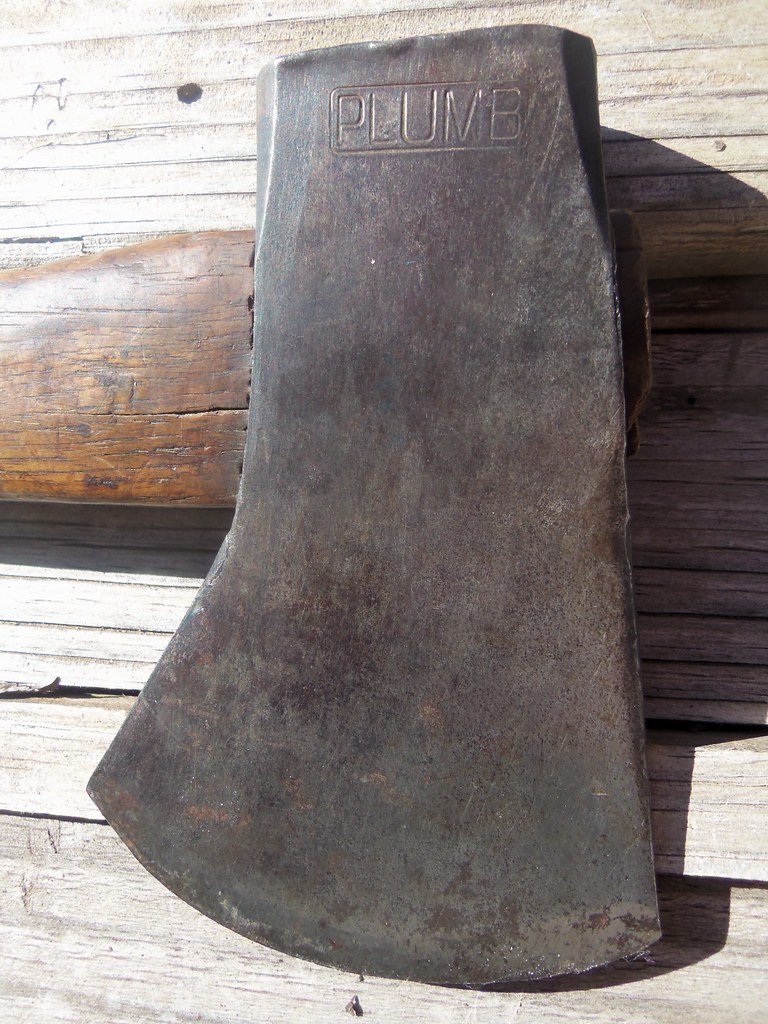

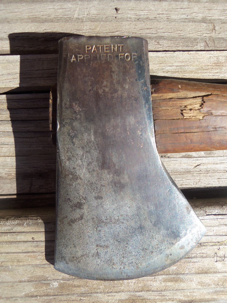

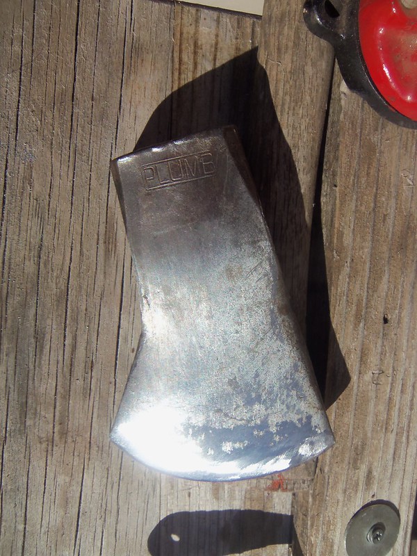

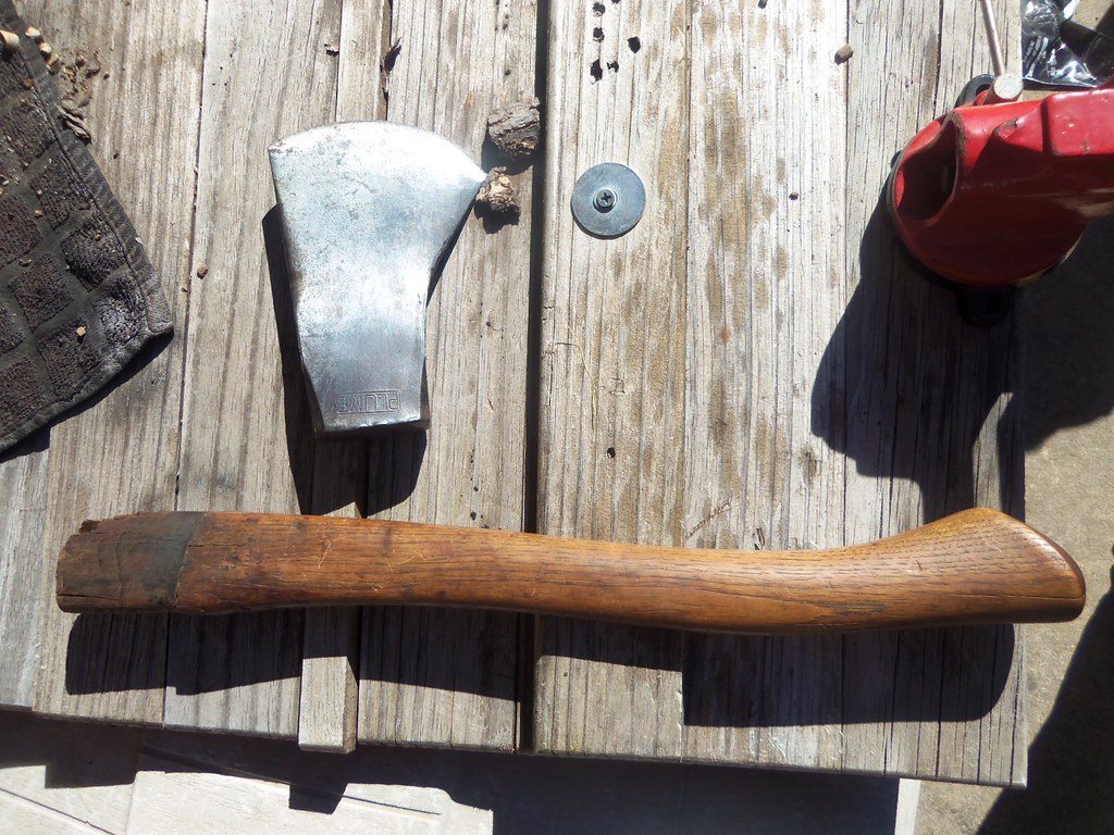

So after using quite a few different axes in the pack axe size range, including GB and Wett. I still didn't have what I really wanted out of a bushcraft axe. So it was time to make it. I have long coveted a Plumb Cedar Axe in the 1.75lb range with the 4" cutting edge. I finally scored one at a good price
head came off really easy

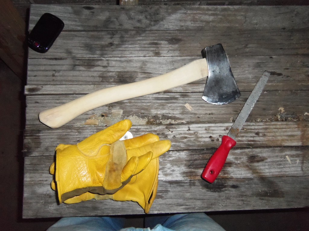

I started filing on the bit. Mostly to get the secondary bevel removed to have a continuous convex edge on it.

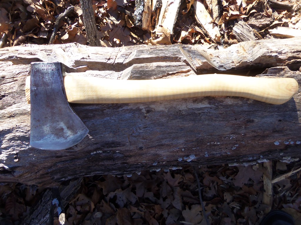

for the head finish I want to leave a little bit of the patina on the head. So I used some wet sand paper to lightly remove the rust on the outside.

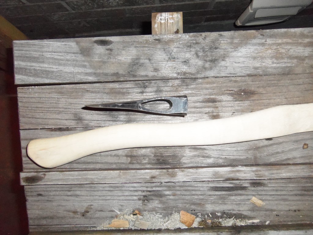

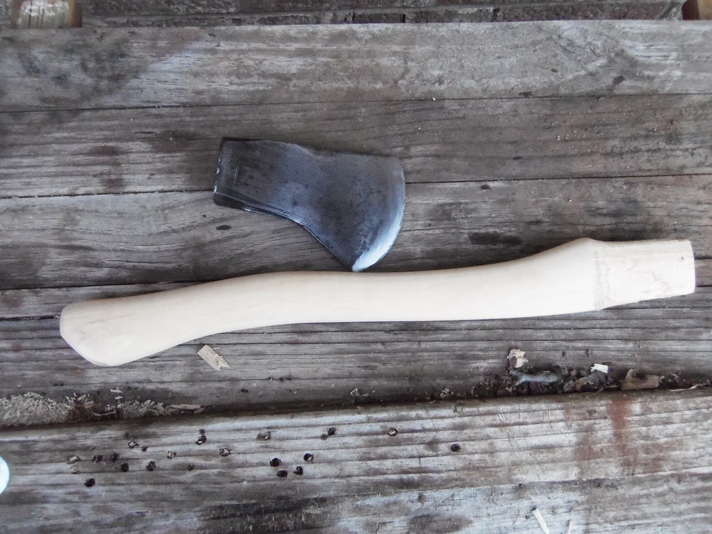

Handle I picked was an 18" from HH. Handle was perfect but needed lots of thinning in the shoulder. Total length after hanging is 18.25". So the handle must have been a little long.

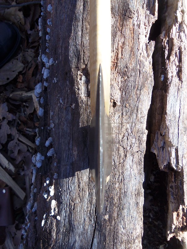

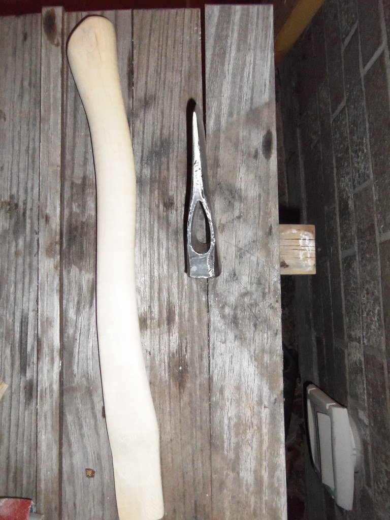

Here is the crooked eye I mentioned in the earlier thread. Top of the eye is aligned straight
bottom eye is not centered as you can see

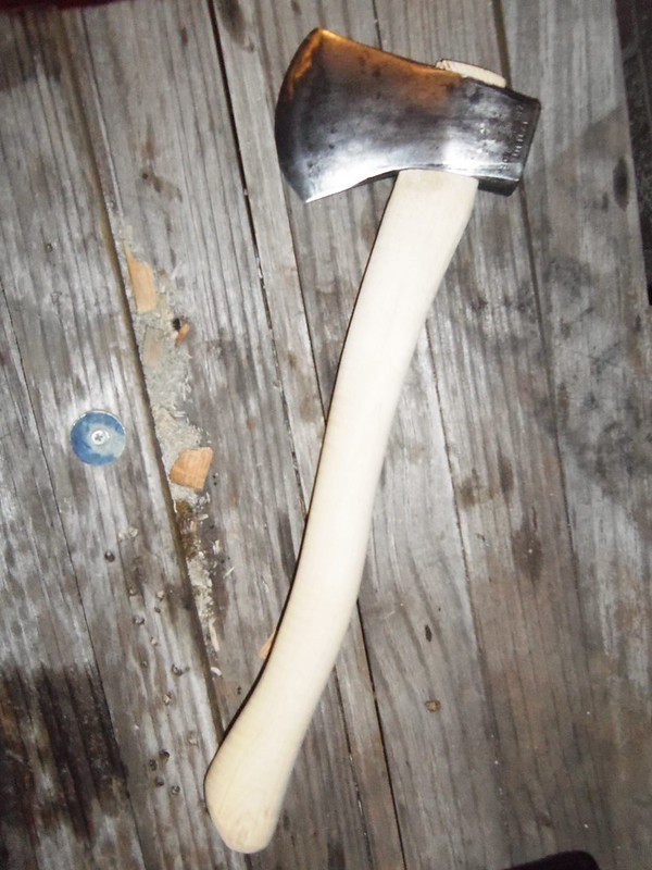

For fitting and thinning the handle I used a rasp and sandpaper. Now to get this head aligned straight you have to shape the bottom of the eye and remove more wood on the side with more metal, as you want the wood to pull it back to center. But since the top eye is straight you don't want to make it uneven so no adjustment needed up top. This eye had the head tilting to the left from the bottom when looking down at the edge. Well after some time and careful fitting here it's just about where I want it.
I'm wanting to leave most of the handle length so rather than bringing the head to the shoulder I'm going to thin the shoulder after I know where I want the head set. That looks good to go
after this it got too dark and my pics didn't turn out. But I got it hung straight and solid and took it out for a test run, so here's the result

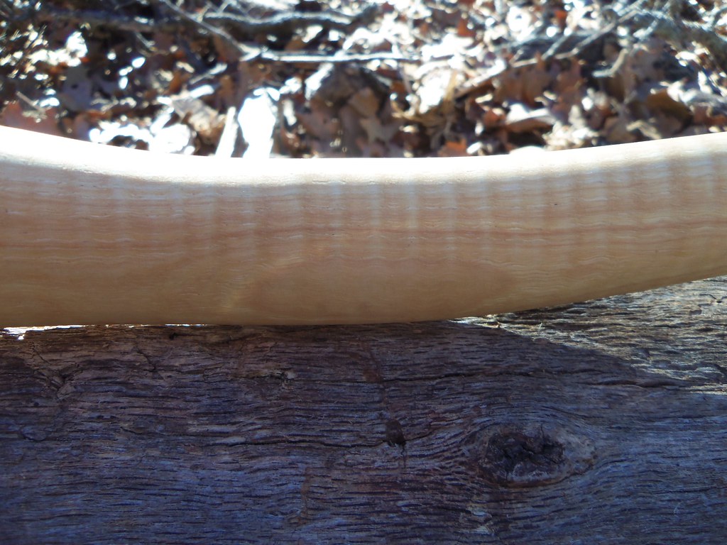

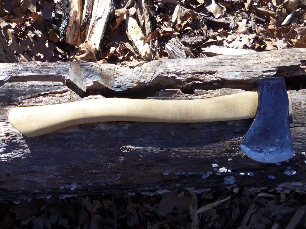

this was one of those hickory pieces that had the stripes running down. Love those, I was thinking about staining it but I just can't do it to this piece

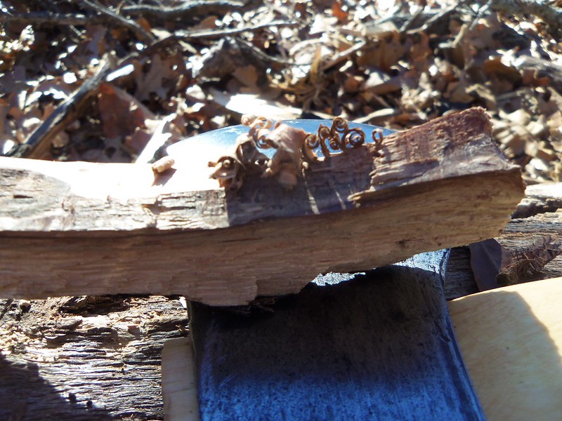

it was curling pretty good

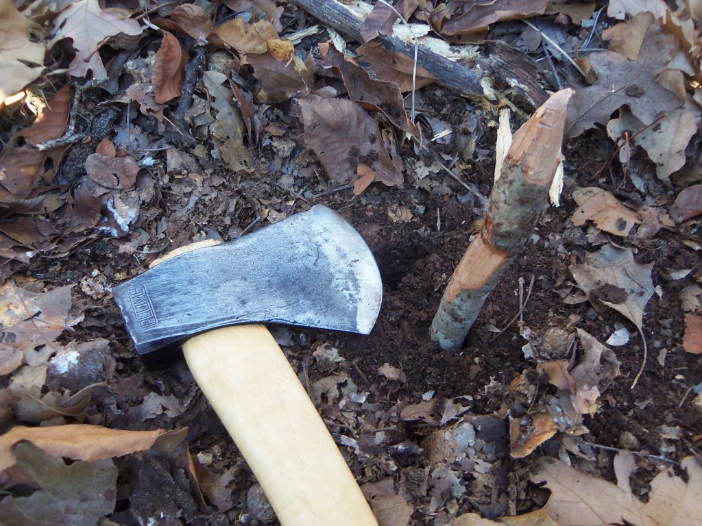

I chopped and carved around a little just getting a feel for it
carved a quick tent peg

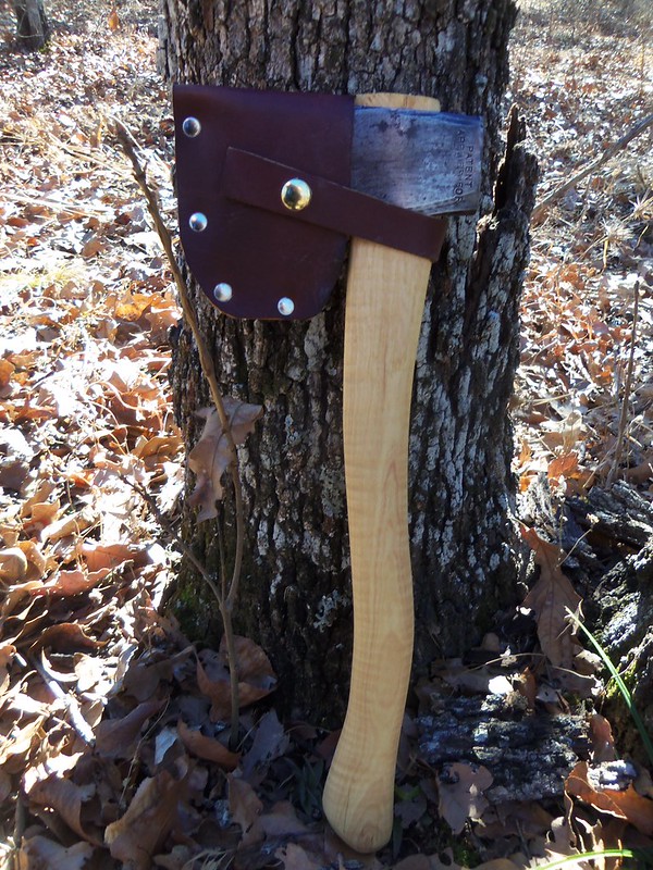

Well after using it some I realized the handle needed some better shaping to it. So I thinned the handle down a little and put a much nicer shape to the end of the handle with a steeper transition in the end of the handle. I also added a little wood stain to highlight the grain lines and give it some quick character appeal. It feels much better and will say I am very please with the end result.
Thanks for looking
Looks perfect, and I'm impressed with the hang on with a difficult eye! I haven't seen figured (at the that's the term used for maple and other woods on guitars) hickory anywhere I have seen handles...I wish I could find a few though as they are really nice looking. It really turned out great.

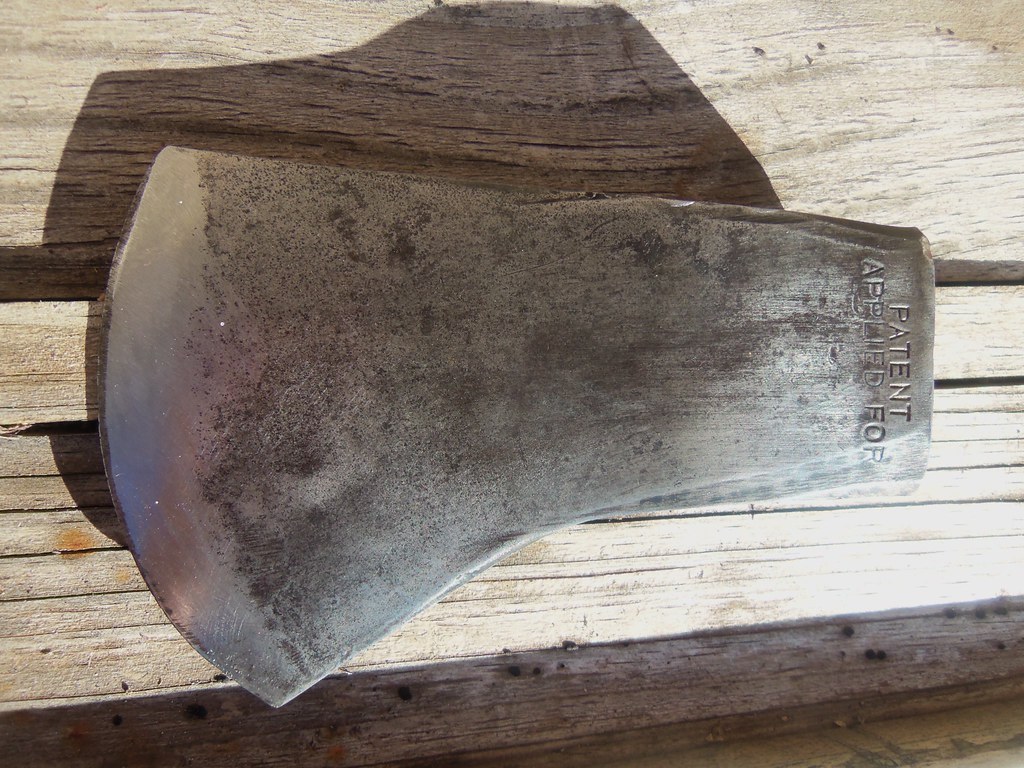

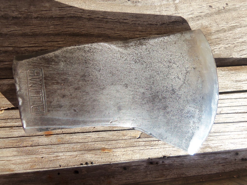

There may be quite a few of these around in the States. But I have never seen one here in NZ. I do have a nice Plumb Victory of about the same size but totally different pattern. I like everything about your little axe. Especially the extended heel, the chamfered edges and plenty of heft above the eye. I would imagine she would 'take no prisoners' in the rough...but also good for more delicate work.
the5farrs Plumb is in really good condition also. Any idea how old these may be. Great to see old tools that have been used for what they were designed for and have not had the living daylights beaten out of them.
