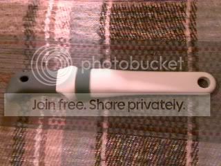

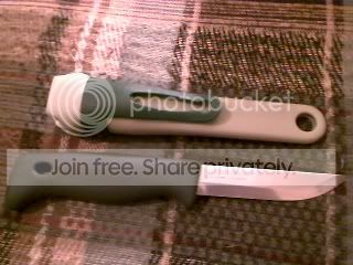

I first heard of this knife on a Russian TRPG game but never seen or heard of them anywhere in America. I got it from a guy in Finland who showed pics of his in a knive thread and offered to sell me a few. Anyone heard of them?
The blade appears to be similar to a Mora but has a longer tang, the handle is kinda crude though...

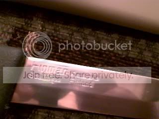

The Finman puukko is made by finnish company Laurin Metalli Oy (Lauri's Metal, www.laurinmetalli.fi).
It's a Mora-like puukko with stainless steel blade that has a more acute grind (puukko grind) compared to Moras. The hardness should be at about 57 - 58 HRc. It is an excellent cheap allaround knife. I have two for work around the house. The handle is quite neutral in shape, various grips are easy.
The sheath is nothing super but does give you carry options by positioning the clip down or up. It's possible to rig it as a necker but personally I wouldn't trust the retention of the sheath if the handle is facing down. But overall...If you like Moras you should like this one aswell :)
