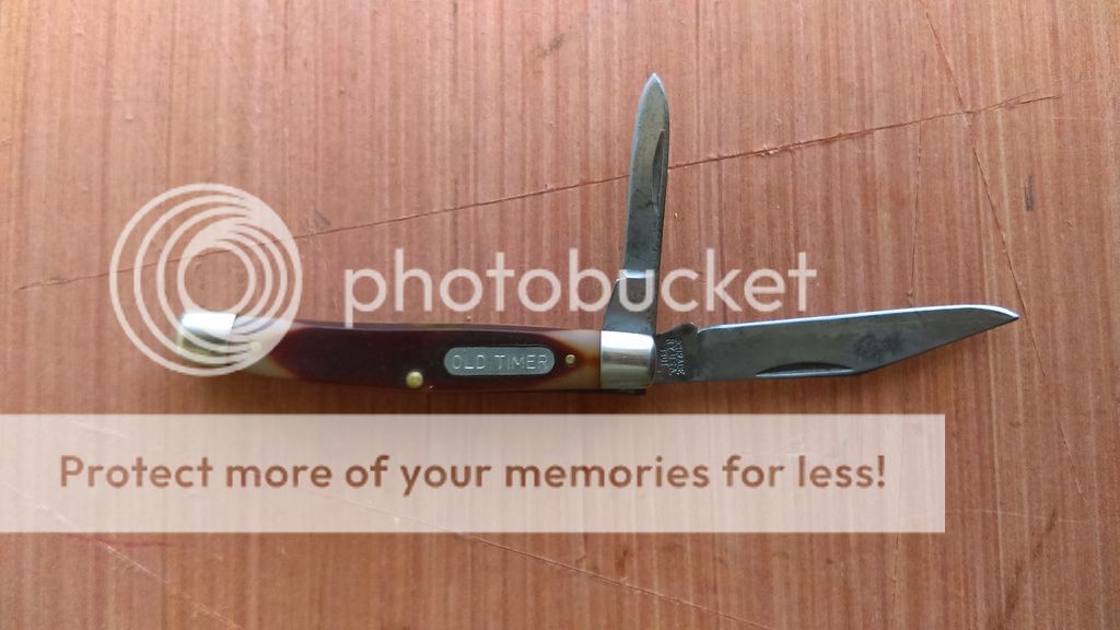

It was actually bought for my dad, but that would be nice. it may not mean as much as you'd think because my dad gives me everything, he pretty much used to find some old thing to give me every other day ( so it's more the issue of liking the knife and wanting to use it ) I've got a 34OT stockman from around '04 that I use all the time on wood, but the sheep's foot ( the one I use the most has no snap left in it at all, and it was never perfectly straight ) not to mention that I was dumb when I was a kid and sanded the rust ( which I stupidly let form on the Knife )off of it and it looks like crap. By the way the old 33OT cv blades ( we're they always like this ? ) I'll have to post a picture of it in a minute. ( it was never used, but my dad never wiped it off after handling either so it has some patina nice )

Here it is
Old Timer built a good knife, I always considered them a working mans knife. Quality was good but maybe not as consistent as Camillus. Old Timers 1095 was as good as any.
Schrade/Old Timer could service the swinden Key but but with them gone you need to find someone who can drill it for a pin. There's probably some here on the forum who could do it.
Sorry there's no way I could describe exactly how the swinden works.
[/URL][/IMG]
If I knew what size of brass rod to get, I'm sure I could do it myself. I also noticed that the pen blade doesn't open flush with the back spring, which also kinda sucks.
