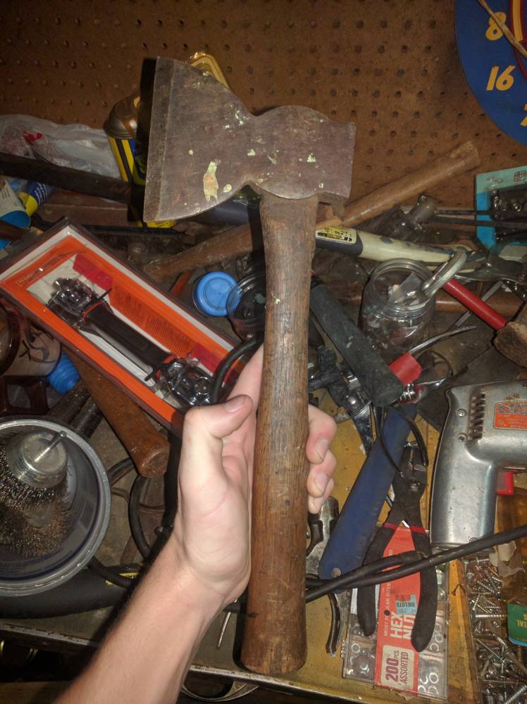

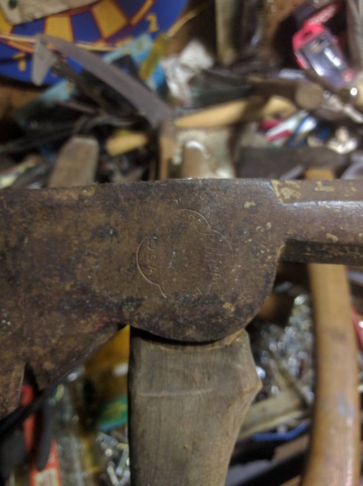

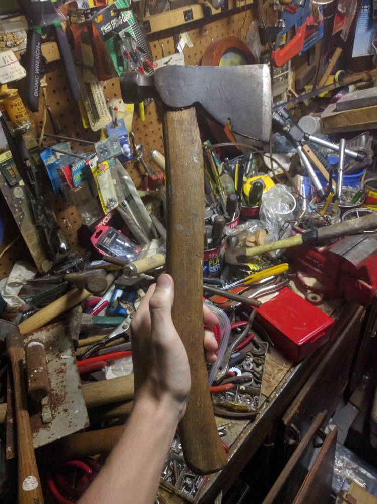

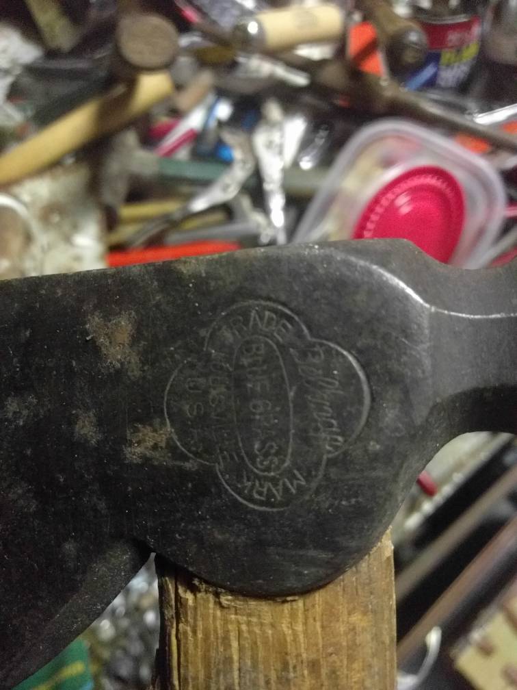

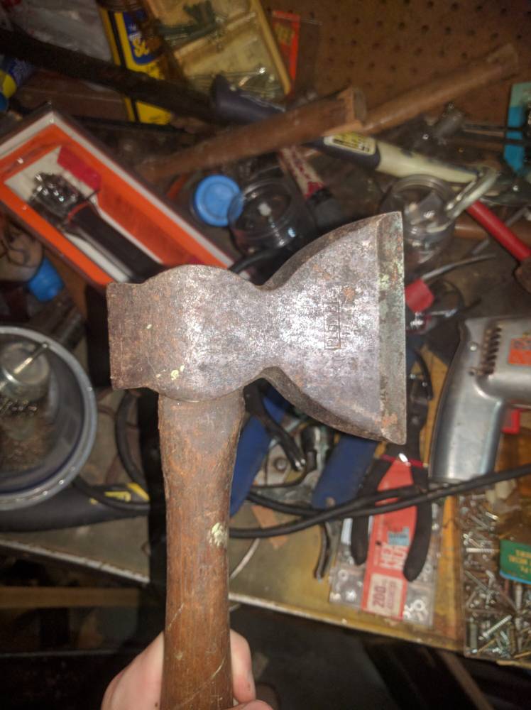

Okay so what is a lathe hammer, and the work bench is my grand fathers, he shops local yard sales and buys crap he will never use, case in point, I found 12 axes with handles and 4 heads, and 5 or more of all types of hammers
Sent from my Nexus 5X using Tapatalk

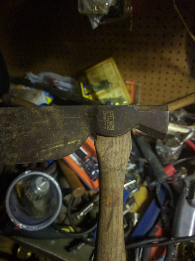

The first one is a riggers axe ( unless it's lighter than 28oz then it's for flooring )
The second one is a half hatchet with the bit pretty well worn down

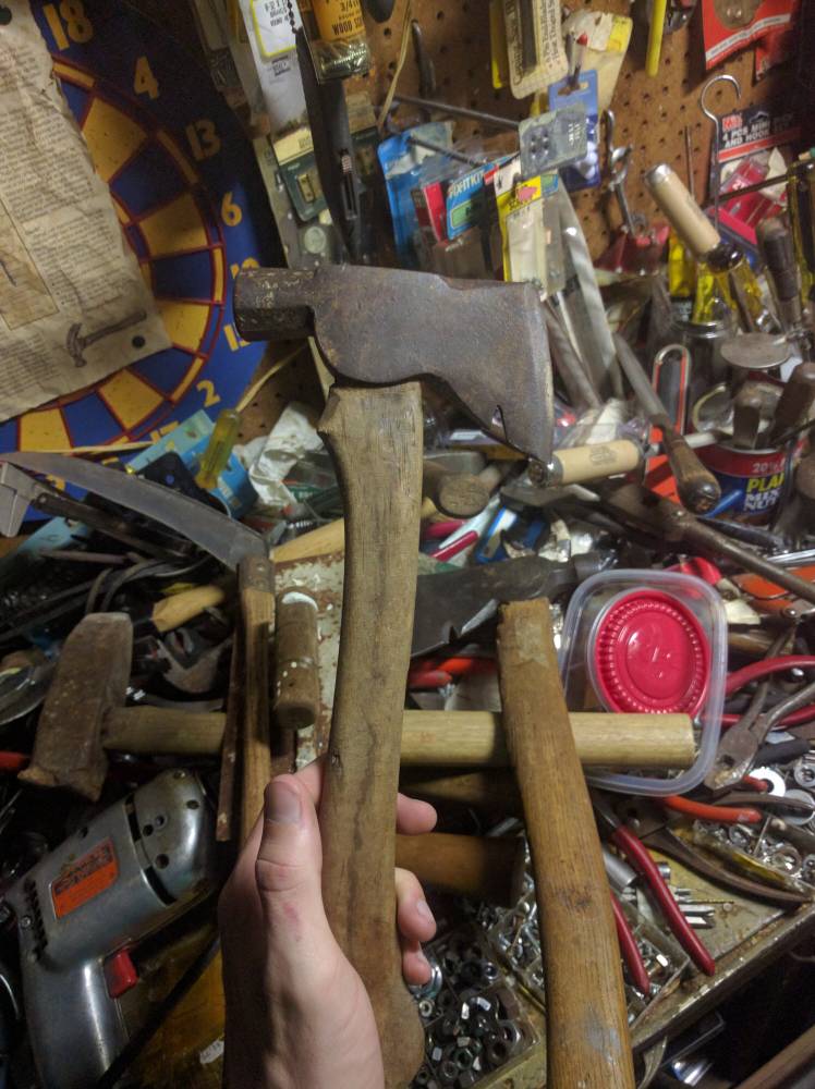

The third is a underhill style lathing hatchet

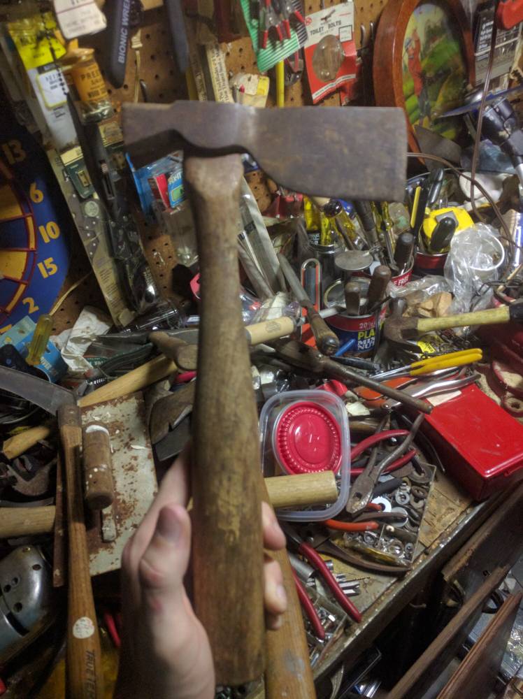

And the fourth is a carpenters broad hatchet that should've only been sharpened on the stamped side.
The quality should be pretty good.
Both vintage Plumb and Belknap are high quality.
Those first two can be called either a rigger's axe, a half-axe or a half-hatchet depending on the manufacturer and date of production. In any case they should be hung on a straight handle so that both sides of the head, hammer or axe, can be used equally well.
Ditto what others said about the rest.
As far as I know, riggers axes from the 20th century never have the octagonal head on them.
That's why framing hammers have that style of head, guys would cut the axe bit off and weld on hammer claws. Half hatchets also way less that the standard 28oz / 1-3/4lb
personally I'd use a 22" curved handle on the riggers axe to turn it into a small axe that happens to have a hammer for a poll.
But that's just something I've wanted to do for a long time to make the perfect pack sized axe. ( I'd also slightly curve the bit )

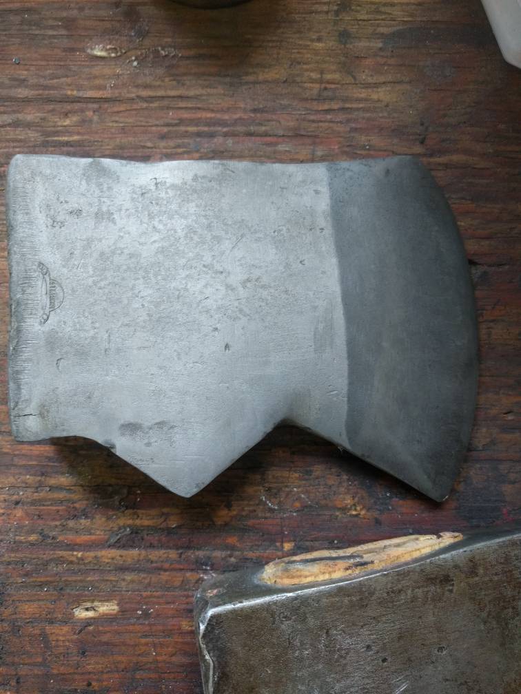

That plumb head on bottom two pics is not ruined but sharpened both sides right? Supposed to only be one like a chisel. So far my balknap head has held up to me and brother so they're good I dunno bout plumb but heard good things

As far as the double bevel on the Plumb, I have no info and have not looked. However, double bevel broad hatchets were made.
1901
If Plumb did offer double bevels that does not prove that the OPs hatchet was originally a double.

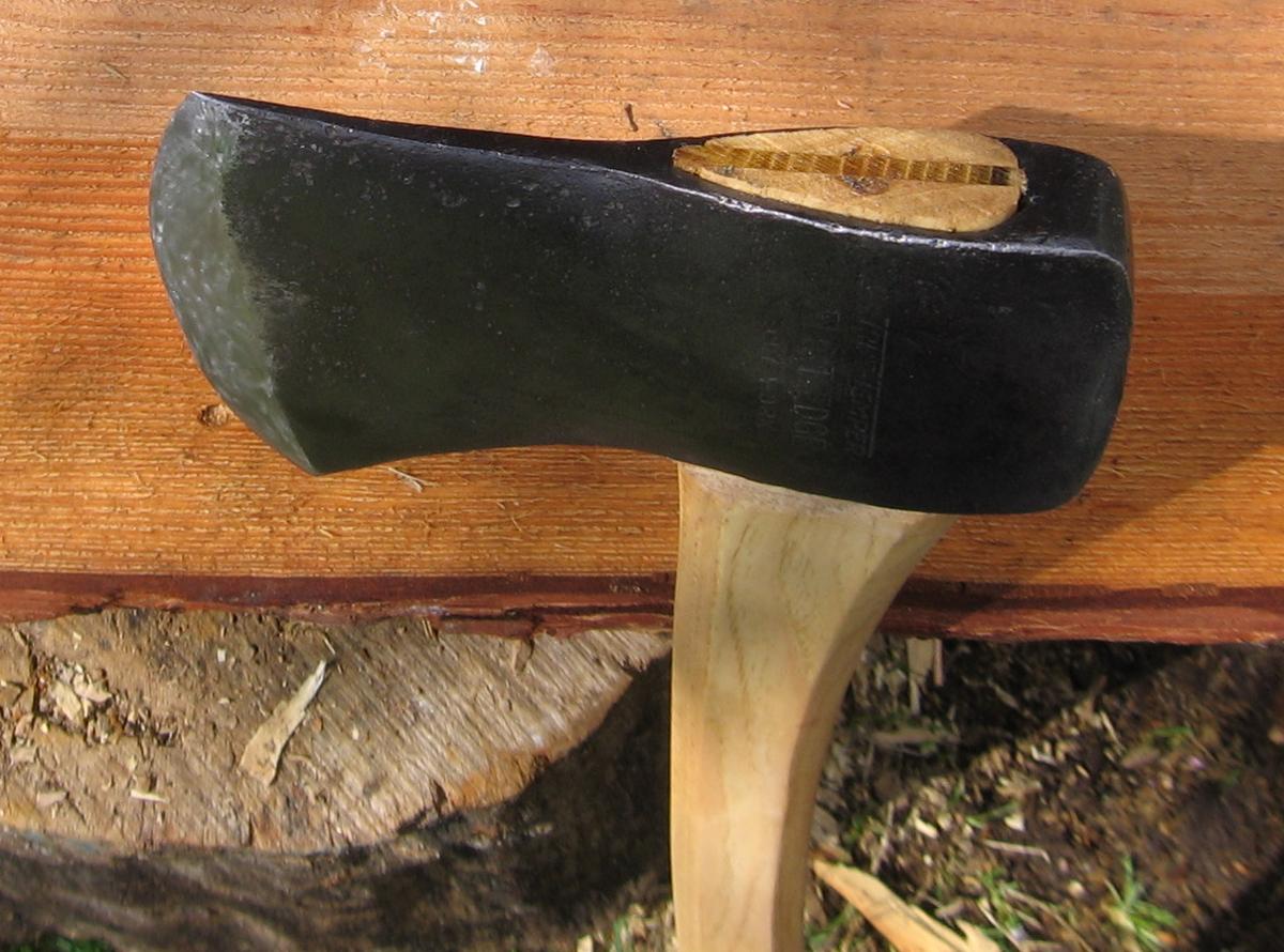

Here's what an axe with lost of character and a nice patina looks like
