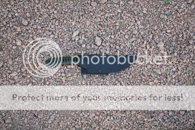

The upswept fighter has an overall length of 11 3/4" and a blade length of 6 3/8". Its paracord is black for the underlay and olive drab for the overlay. The sheath is a foldover design with a single MOLLE lock.
