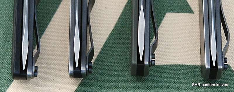

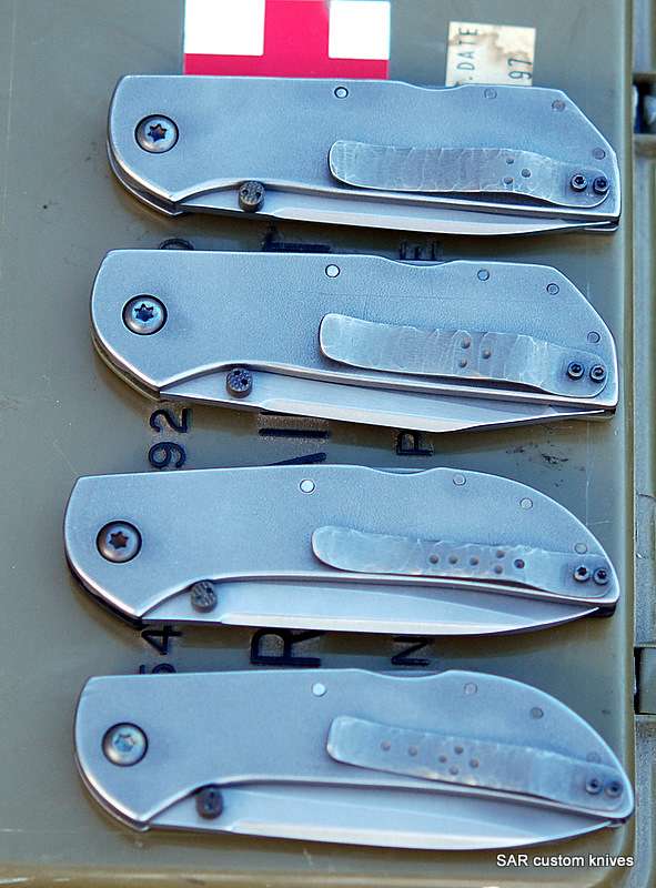

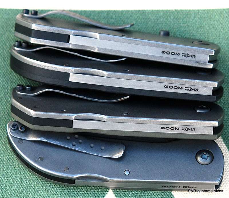

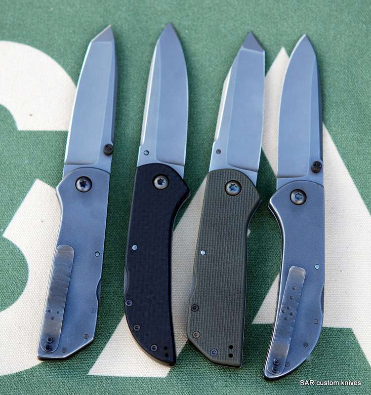

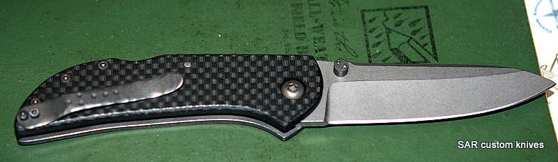

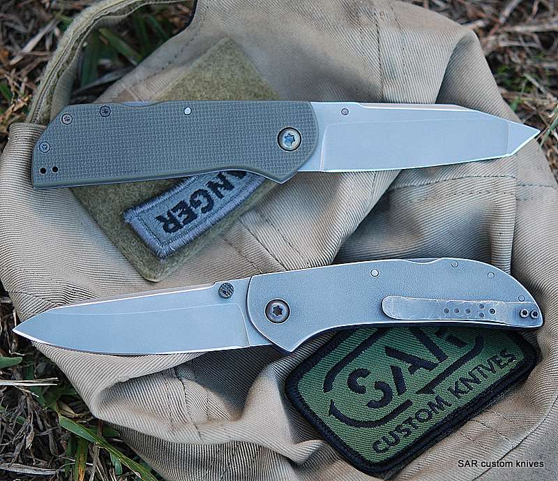

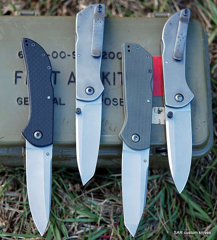

Just finished these up today, which is great means I can get started again
SAR Broad>>>-----------> Arrow Lock-back
Specs:
.125 cpm 154 HRc 59 blade length is 3 1/4" with positive stop.
Lock-bar cpm 154
.100 Ti Frames
Coarse peel CF and G-10 both are around .125
Textured ambidextrous ti clip
303 stainless checkered ambidextrous thumb-stud
440c spring material
Black G10 back spacer
Almost everything has been stone washed
No Nail nick this time unfortunately, I have to rethink the way I am doing it to get it right.
These things are Walking, Talking rock solid lock-up and ready for any chore at hand.
Thanks for looking
Spencer
