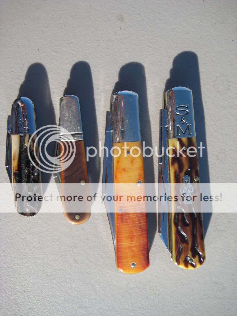

Three of these barlows have gotten the squeeze, tap, sand and polish treatment (the GEC un-x-ld has not needed it yet).

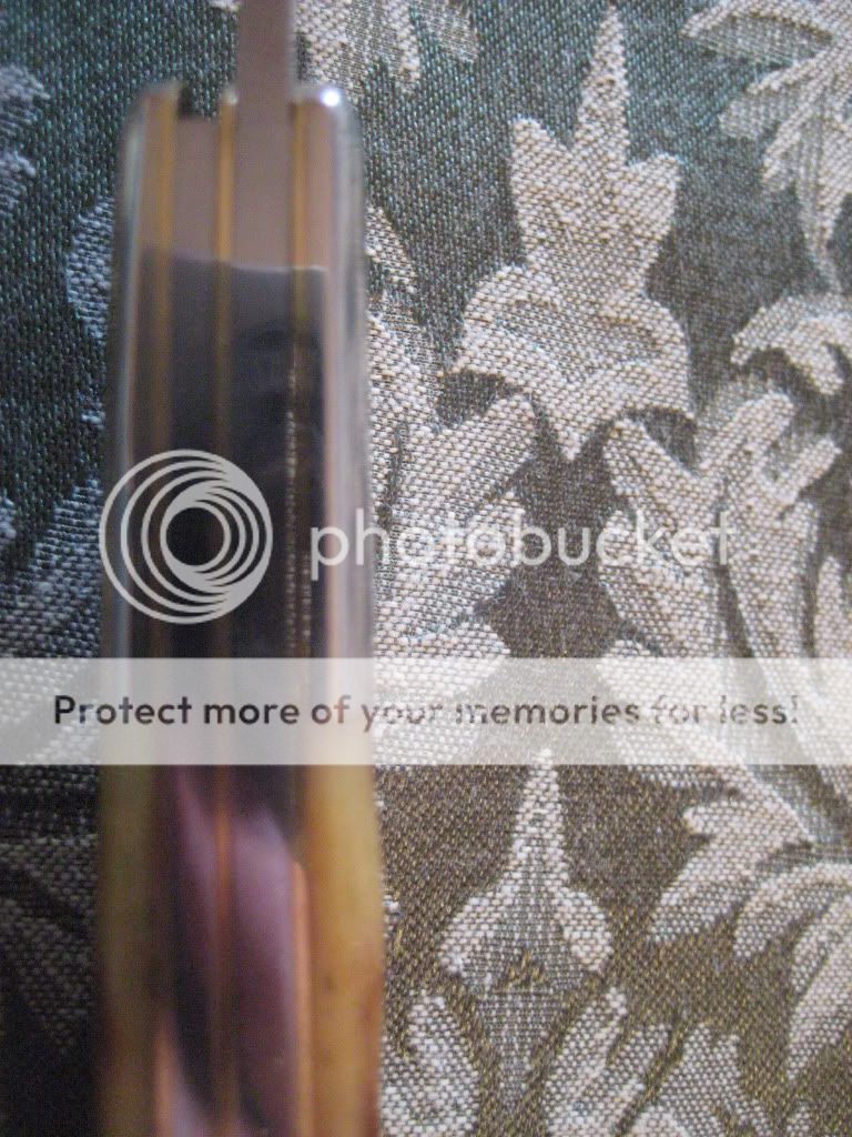

Here is a spine shot as received. (this is the S&M File and wire). After fixing it is one of my favorite folders! So much so, that I bought another one to give to my own father, because he liked mine so much.
