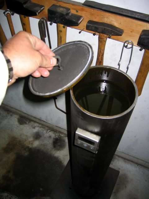

My current 6" dia vertical tank...
Do whatever you can to go horizontal.
It's not that difficult.
You only need to build it one time.
That way your entire cutting edge hits the oil all at one time instead of the back end of the cutting edge entering oil that has already been super-heated by steel 1500 degrees!
And if you make it long enough you can easily slide the knife back and forth from end to end helping to keep "new" oil in contact with the edge at all times.
30 quart Home Depot Bayou Classic Turkey fryer.:D

I don't really agree with how you wrote that, Karl. I have seen you make mention to this before, but not as absolute in your disapproval. The oil would never superheat to that level. If you aren't getting flash, you are even getting above 400F in most cases. Unless your vertical tube is only 2" in dia or you are using a poor quenchant, I don't think you are going to have any trouble. This all happens in less than a second. You need to plunge quickly, but no faster than horizontal. The mass of the blade is in the belly of the tank by then, so the remaining heat is evenly dispersed if you have the proper amount of medium (5gal. is pretty good). In fact, the very important act of agitation is more easily done with one smooth motion in a vertical plunge.
As far as the horizontal tank is concerned... the advantage is having the choice of what gets cooled first, that is mostly to control the curve in longer blades. (or if you choose to edge quench) Many smiths are now quenching spine first with great results.
Rick
Karl has a point. The convection and vapor jacket collapse is better in a long horizontal tank. However, this setup is only really easily set up in a large and permanent shop. As Rick pointed out, 5 or more gallons of oil in a 6" wide tank, with a quick quench, is going to work just fine. On Karl's side, the historic quench is horizontal.

A few standard rules apply:
1) Have a good size fire extinguisher on hand when there is this much oil in the shop.
2) Make a good cover/lid for every tank. This not only keeps the oil clean, but keeps animals out. It also can snuff out a flare-up.
3) Make a good and sturdy base for the tank. It should be half as wide as the tank is tall.
4) Label the tanks. I know you can remember what it is, but humor me.
5) No mater how impressive or how primitive the tank is, it is the oil that does the work. The tank needs to have enough oil for the job. A minimum for small to medium knives is two or three gallons. For multiple knives or large blades, five gallons is best. For swords, it often takes ten gallons to fill a large and deep tank.
6) The right oil for the job is required to harden blade steels. While 5160 can harden in anything from bacon fat to Parks AAA, steels like 1095 need a fast quenchant. Don't make yourself crazy by trying to get an insufficient quenchant to do a job it is not capable of doing. Set up two tanks and put fast oil in one and medium oil in the other. The fast oil should be a commercial quenchant like Parks #50. The medium oil can be something you salvage, or canola oil ( or similar), but the commercial oils, like AAA, will last longer and work a bit better.
7) Ventilation - Quenching make lots of smoke and airborne oil droplets. This is not good to breath, and smells bad,too. Have a good fan blowing to move the smoke/vapors, and have outside air coming in the shop. Quenching is best done in an open air smithy if possible.
