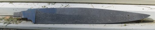

I saw a post somewhere that someone said they profile out the shape of the blade then do the heat treating (normalizing, quenching, then tempering), then keeping the blade cool grind in the bevelsand shape it. My question is on 1080 steel that is 3/16" thick by 1" wide (sharp part of blade will be 8.5"), if i profiled a blade shape, normalized it 3 times, clay coated it, then heated to non-magnetic and quenched it in water (or oil) ( i have cracked 2 long clay coated blades quenching in water, point first into a pipe of water, too long for my normal oil over water in the ammo box quench), then grind in the bevels and shape it, can i still get a nice hamon/temper/transition line or is 1080 too shallow hardening for that?

I use most of the 10 series steels and clay harden all of them. I enjoy making the big blades 8 and 10 inch that you speak of. I profile, do the distal taper then finish up all the soft work around the ricasso and the guard shoulders. Before I
start the plunge cuts, I try to decide how much material I will leave at the cutting edge so the odds of it warping will be acceptable when I harden it. Wide tipped blades warp a whole lot less than the long pointed ones so they can be thinned at the edge more. This is a 12inch blade. I will harden it at this stage of the grinding and figure I have good odds it will not warp. You will get that hamon
you are looking for in the 10 series steels and not be gambleing to much. Fred

so on a 3/16" thick pice of 1080, if i quench it at full thickness the hardening (to form the hamon) will go all the way thru?

i was hoping to have a rope cuttin knife this time, but i cracked the blades on the last 2 :grumpy: but i wanted a nice hamon on it since after Trackrock it will be going to a friend of my wife, and he likes the hamon on some of the others i did. i just wasnt sure how deep the hardening would go since the 10xx steel is supposed to be shallow hardening. guess i will just have to try it :rolleyes:
I believe the shallower hardening the steel the more pronounced hamon you can achieve. I think Kevin Cashen said that somewhere.
