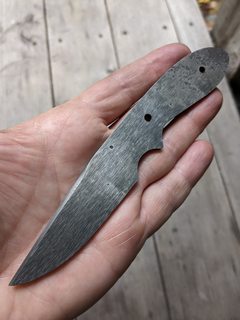

Hi. I have recently took a class on forge welding, as a a project I have forge welded a billet of 1084 with 15N20 jacket. It looks good, I don't see any delams, so I started cutting out a knife shape and at some point, after a basic surface grind I have decided to etch it in ferric chloride to see the contrast. The chloride I'm using is diluted and I only kept my blank in it for a couple of minutes, but the result I got is not really what I expected.
What I expected was for the 15N20 to be white or shiny or anything. But the color of the whole billet is pretty uniform gray, as you can see here:
If you look at the edge, there is a slight line that shows the border between the steels and 1084 is very slightly darker then 15N20, but nowhere near the contrast I would expect.
Of course, the knife is still not hardened, I need to polish it a lot more and keep it in the ferric chloride for longer. But my questions are:
1) Would that be enough? Or should I do something else to bring out the contrast?
2) Why is it so uniform? If one of the steels were a mild steel I would chalk it up to carbon migration, but they are both high carbon steels.

I've only done a couple of san mai blades, but I had the same reaction to my first one. The contrast is much more distinct after hardening.
First - IT won't show any difference until hardened.
Second, you don't need to etch that long. It also looks like you just let it sit and the bubbles made the streaks. Etch for 10-15 seconds is enough to see what is happening. Longer etches should be done in 30 second to two-minute soaks, taken out and cleaned off under running water with a paper towel, washed with soap and water, rinsed well, and soaked again in the FC. Repeat as many times as desired.
The edge shot looks like you have the sides pretty thick. You will have to grind a lot off to get to the hardened core once you do the HT.
Try this
Harden the billet.
Grind a 45° angle on the edge and etch to check that the edge is centered. You only will need a short dip of 15-10 seconds to see the dark core. The 15N20 won't be white, but will be lighter than the simple carbon steel.
If the edge looks centered, then grind the bevels, keeping the core centered. Regular dips in the FC will show you the status.

FatFrumos - Clean up the sides of the billet, but don't grind much of any taper in the billet before HT or you may get warping of the edge part. Also, the rule for any san-mai blade is to do then HT for the core metal. That means you would use a HT regime for the 1095 core. Since they both fall in the 1450° -1500¯ range, 1475° is what I would choose. Give is a sufficient 5 to 10 minute soak to assure the core is ready for the quench. you need a fast oil. Canola will work, but Parks #50 would be better.
