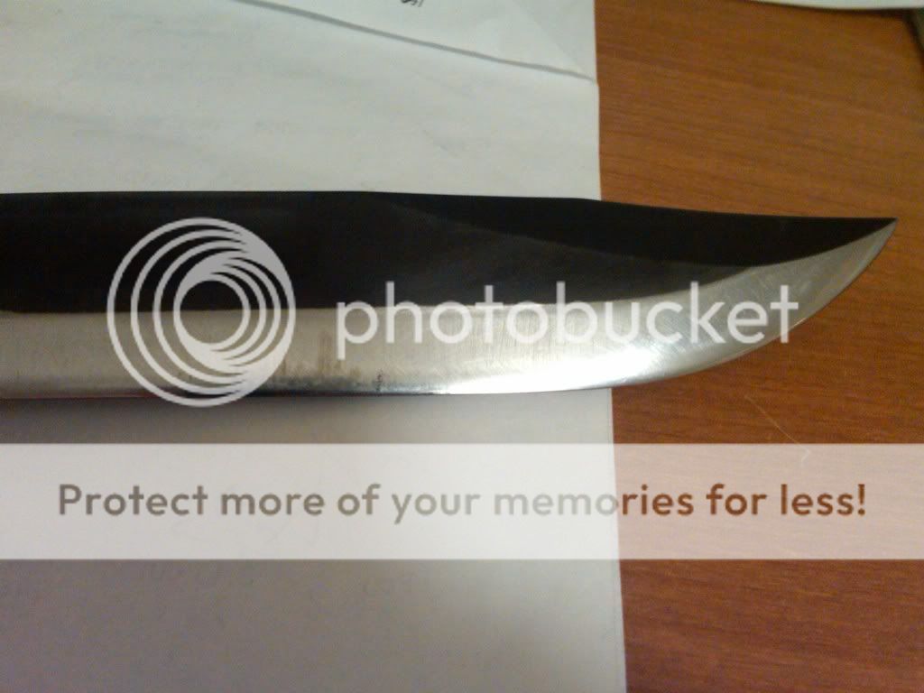

I am trying to convex a ka-bar short knife and it seems that it is getting sharp, but even after the 1000 and 2000 grit sand paper it still will not glad through paper very easily.
Should I be forming a pretty good burr like when sharpening a bevel edge knife? I am wondering if I should start back over with a more coarser grip paper and get up a bigger burr before moving to the finer grits.
I did get up a small one to begin with, but maybe not enough to really get the edge going...any thought?

Have you convexed the entire edge, or just the bevel where it meets the primary grind? When you start with a thick edge bevel, it takes a while to get the entire edge truly convexed.
If you have a true convex edge, it is possible that you are putting too much pressure and/or are using too high of an angle. Try a lighter touch at a lower angle.
I removed the black coating up to where the grind starts....trying to convex it starting from that point...eventually hoping to finish off the entire grind with 2000 grit paper and make it mirror polish

You might try using rubber cement to temporarily attach varying grits of wet/dry sandpaper (e.g. the type used for autobody work, available at auto stores and elsewhere) to a firm foam pad (e.g. to a mouse pad).
Start somewhere like 600 grit, and work up a good burr on one side pulling the knife towards you with the edge trailing. You should be able to feel a good burr with your fingernail along the full edge length... then switch sides. The second side will largely be easier, as the burr will just kind of bend/roll around to the other side. But get a good solid burr on 2nd side.
Then go to a 1000 grit. Repeat.
I don't know that you need to go to 2000 grit.
From there, use a leather strop loaded with some fine rouge, or something similar, and mechanically work the burr back and forth, one side then the next, and it will "work harden" and eventually just snap off (work harden, like when you bend a piece of wire repeatedly to break it).
Then you can keep stropping both sides lightly until you get the desired results. Keep approx the same angle, else you'll dull your hard-won edge somewhat.

i am going with you. after comparing with my bark river fox river, the edge is just way too thick to convex. you would have to take off an absurd amount of metal, but I am still contemplating it.
Both knives are the same blade thickness but the difference is the bark river starts going to the 0 grind from the spine all the way down to the edge. The Ka-bar tries to do this starting half way down the blade (from the beginning of where I started removing the black finish). That is just too short of a distance to get to a nice thin edge to begin convexing. You would have to use 220 grit paper and just take the entire side down a good bit before trying to actually work on the edge.
Maybe I should just turn it back into a bevel edge since that is the way it came...any thoughts?
