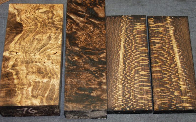

When blocks and scales are dyed and then stabilized in a tank, the different woods can react differently to the dyes with portions resisting the dye. I think that can give the wood really cool random color patterns.
This photo shows some pieces of different woods dyed and stabilized by K&G. They were all dyed brown in the same batch.

If the dying was done by one of the professionals like K&G or WSSI, I would guess that it was the redwood resisting the dye. Redwood will vary a lot with how oily it is and some will be pitchy.
