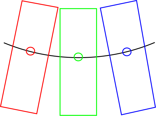

I was wondering if anyone has experience using a lansky on the 0350. I'd like to know if you can get in the recurve with the flat stones, and if it's a close call, would a shallow angle help? Thanks in advance for any replies.
Very Respectfully,
- me
I've used a lansky on a 0350 with good results. I have to say it was a serrated model though so not a lot of recurve there. Havent had to sharpen my 0360's yet but dont forsee a problem. Hope that helps.
I don't have a Lansky, but I do have a DMT Aligner, which is pretty similar. It works fine. You just end up with 2 points of contact against the stone instead of one.
On a "regular" curved blade, when you sharpen, the edge is in contact with one point at the center of the stone:

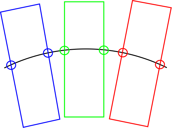

On a recurved blade, the edge is in contact with two points at the edges of the stone:
On very steep recurves (like a Spec Bump), it can be a bit trickier, but for something like a 0350 or Blur, just sharpen like you normally would any other blade.

flarp's illustration is perfect. :thumbup:
The Lansky's narrow 1/2" hones will make it a bit easier, in terms of working the inside radius of the recurve. A shallower angle will help to 'flatten' the radius of the recurve a bit; the flipside of going shallower is, you'll have to remove more metal to fully apex the edge. Slow & patient is the best approach, but it can work. I used a Lansky to re-bevel an 0350 in S30V, and went WAY shallow with it. Had to take a lot of metal off, so it was a long project. Still got the job done.
