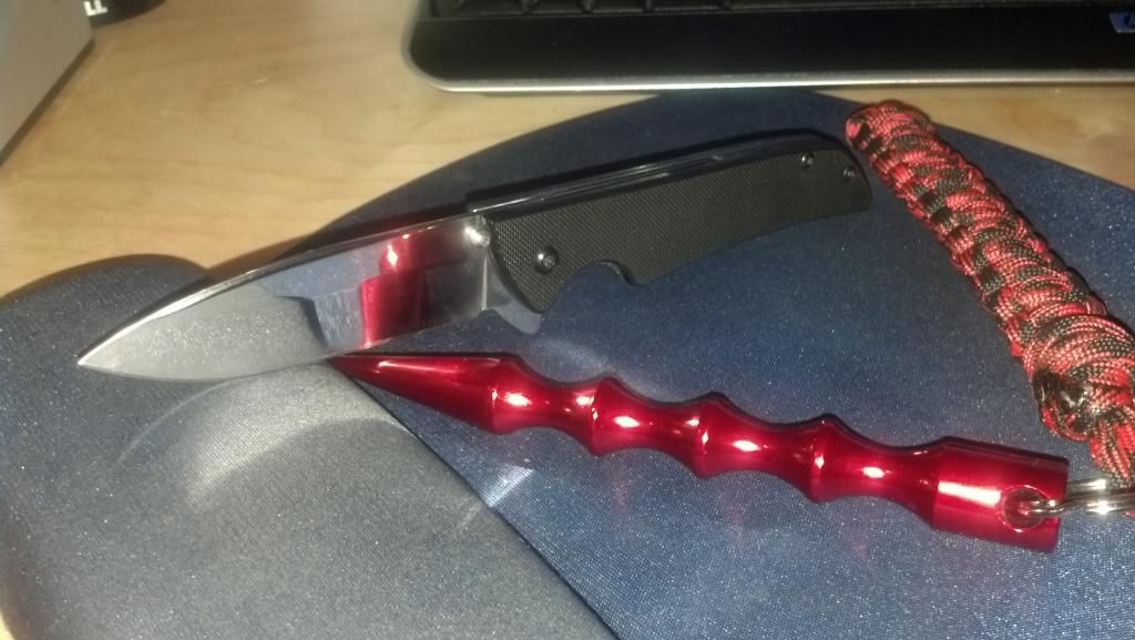

Just had to plant that idea didn't you :). I'm very happy with how it turned out.
[/URL][/IMG]

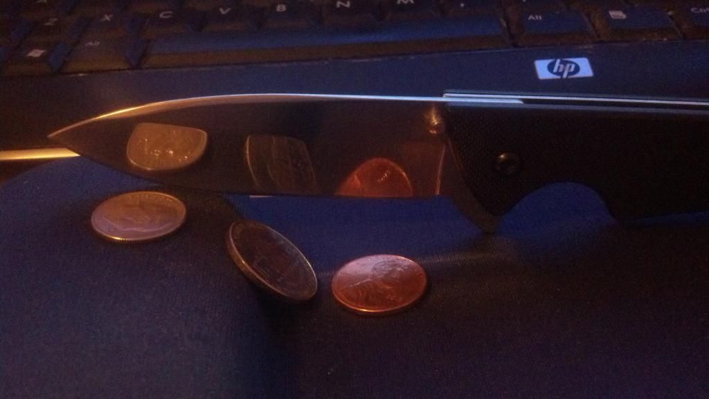

Not perfect, I wish I spent more time around the thumb studs but it's my first attempt so I'm very pleased. And I finally figured out how to post pictures :)
Nicely done.
On my keepers I usually polish the pivot area and sometimes the lock area for smooth, crisp, fast action.(sounds like a 70's commercial)
At first glance I thought that kubaton was a plug that you use to...nevermind...:o
Giggity:D
But, good job! I have only mirror polished pocket clips and edges so far. You did an awesome job!

Hahaha nah I've never used it for that lol, or anything else for that matter but it was a gift so I carry it. Thank you for the compliment and thank you Cicatriz too. I notice small scratches you can't see in the pics but overall I'm really happy with it. I really dulled it while sanding and I'm not the best sharpener but I managed to get this back to shaving sharp after polishing without scratching it anymore so I'm actually more proud of that. I went with wet sandpaper 180, 400, 800, 1500, 2000, 3000 while just washing with dish soap and water in between grits. Polished by hand at the end with Wright's Silver Cream but I didn't notice any difference at all it looked exactly the same as after the 3000 paper.
