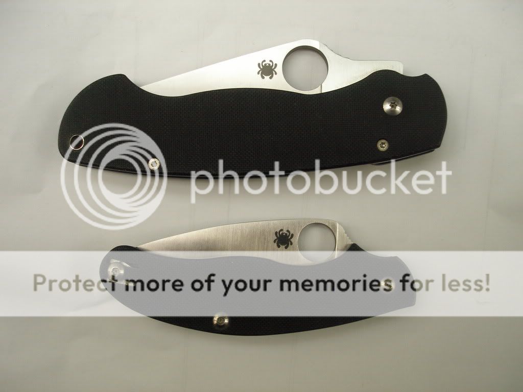

Of course, you could always look at the Spyderco UKPK. It is made specifically for the UK market. Blade is just under 3", and it is non-locking, but the action is such that it behaves a lot like a locking knife. The handle is not huge, but the way the knife is designed you can choke up on the choil and have a handful with the handle.
G-10 scales, S30V blades, what's not to like? Here are a few pictures of the Para and UKPK:
