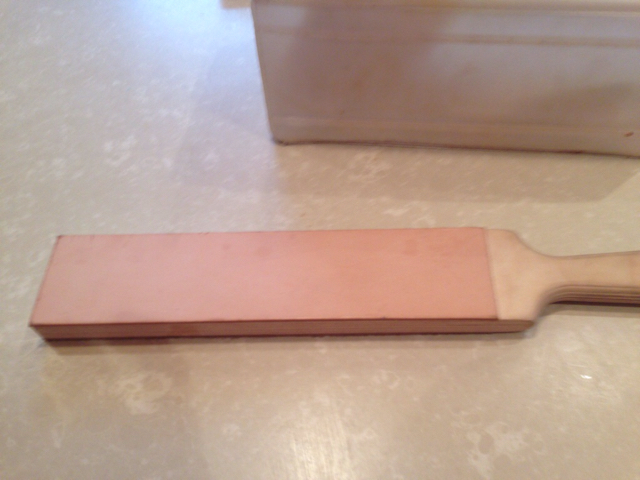

Ok so I applied to the very smooth suede side. This side has almost no nap you can feel. Applied compound, warmed it over a stove top element and then rubbed with paper towel to remove excess. Should I keep repeating this process or is this fine?
This what it looked like before
^^That should be fine to get started. Over time, as you use and 'refresh' the strop with new compound, the green tinting will even up and become more uniform in appearance. From a functional standpoint, you're 'good to go' as is. :thumbup:
The main thing to remember is, don't over-apply compound. The compound which embeds into the leather is what's doing the work, and all the rest that doesn't have a hold on the leather will just be in the way, and won't really be of any benefit.
