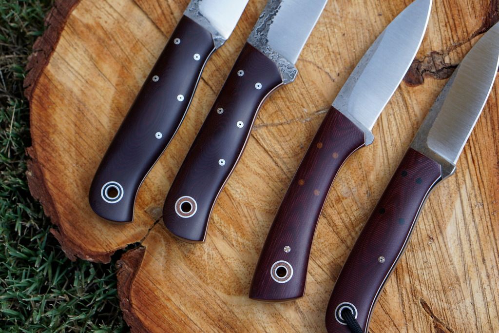

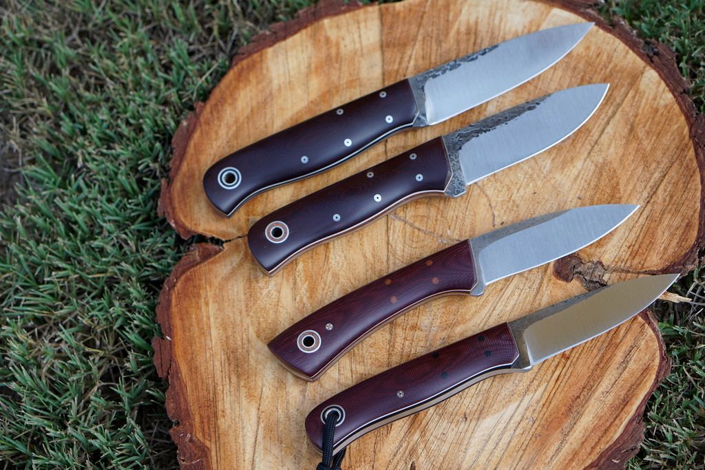

These pics should illustrate what Kirkwood and I are both saying:
The KEB and the BC Jr are maroon linen micarta while the Bushboot and Hiking Buddy are crimson micarta. My KE Bushie actually sports maroon on one side and crimson on the other......it's one of those unique "one off" knives. I tried to capture it in a pic but it didn't quite turn out.

I'll let the pics tell the story, aside from the fact that Andy and I had a conversation about the KE Bushie in which he clearly described that the knife had two different colored micarta's, one side maroon & one side crimson. It's entirely possible that the shop currently sources only one flavor to keep them from being confused, and that the description that Ken used is different from how Phillip now describes it. That's my story and I'm sticking to it :D
I totally believe you and the pictures tell the story perfectly. I was just following up with why I thought they were the same.
