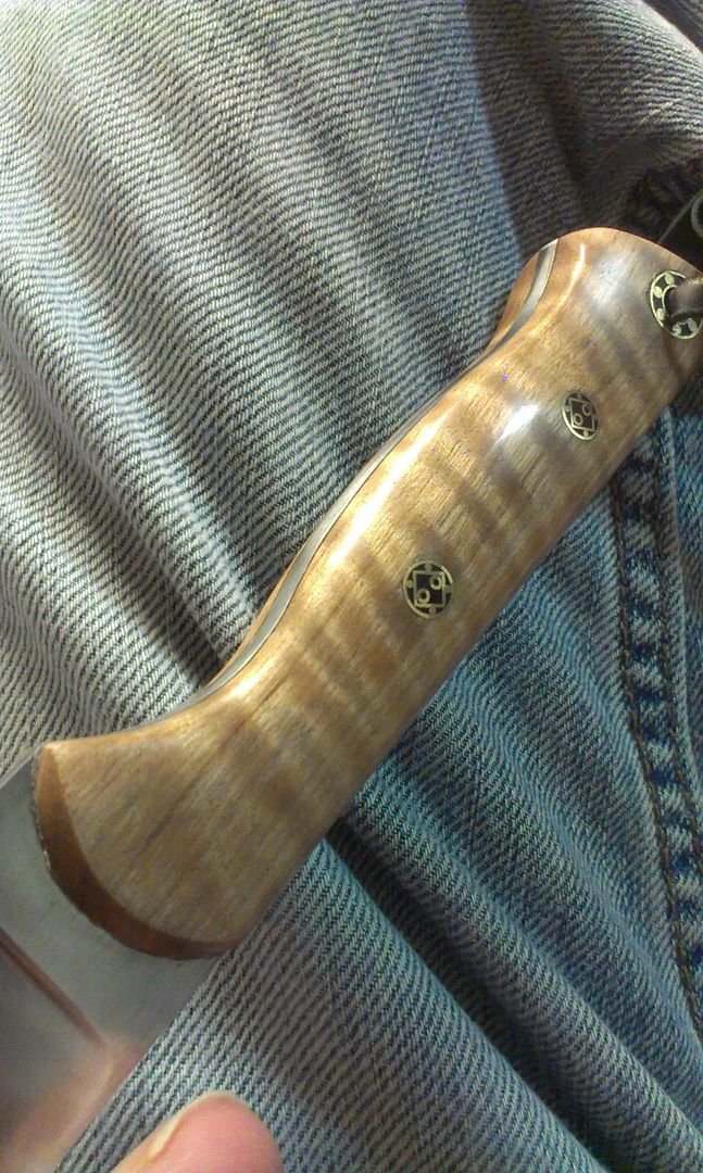

I use a letter bit after my 1/4" pins. The holes are a tiny bit bigger than 1/4" through both scales and tang. As blunt said, it'll give you a tiny bit of room for adjustment.
These are the last scales I did.
