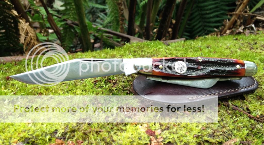

So here's the deal-I'm thinking about having a knife reground by Tom Krein, a D2 #49, but with only one blade. Is anyone a fan or alternately totally against this? His regrind seem to come up fairly regularly, and usually don't last long on the exchange. Is the cutting performance enhanced enough to make the regrind a wise course, or not? I'll be sorry to lose the blade etch, but I carry this knife all the time, and would like to see even better cutting action. I do pretty well free hand, but the regrind I've looked at seem to cut well. What is the consensus on this, if there is one?
Thanks all, Neal
I have had a couple of GEC's with Tom's regrinds performed. He does a really fine job and it can really enhance the slicing properties of the knife. Now that being said, I don't feel that most GEC's require a regrind such as this. They utilize a very flat grind anyways so the gains of the regrind are somewhat marginal. You're considering a Queen of which I am not familiar with the thickness of the blade and secondary grind from the factory. But based on my experience, many Queen knives sport a somewhat thick blade with a very thick secondary grind. In the past I have had to put in extra time to reprofile those blades. So if that's the case with your #49 in D2, I think you would be very pleased with the end result of Tom's regrind. It's not cheap though so I personally would think hard about how much I really like the knife before proceeding.
I hope this helps without muddying the waters too badly. :D
Thanks Bob. Yah I'm a little nervous, just because it would be hard to replace. It's the horseman's stockman, blade, punch and hoofpick/backscratcher in bird's eye maple. There's a couple out there, but I'd just as soon not repurchase:D. The blade is about 3/32" on the spine at the plunge and at 1/8" or so back from the edge is 1/32". All I have handy are woodworkers calipers, sorry. I love this knife and I'm a little torn. However everybody who has one of his regrinds seems pretty happy, and he did do the sharpening for Bob Dozier, which imho is saying something. Just waffling I guess...

Neal, I tend to regrind - as in put a finer, more acute edge on, and thin out behind the edge - all my knives shortly after I get them. The only real exceptions to this are Moras, a particular modern production company, and some GECs which won't get much action as users. But with all those I still refine the apex a bit.
So I mention that by way of saying that it's not strictly necessary on a lot of knives - I do it because I like sharpening and playing with different steels and pushing the envelope as far as cutting performance goes. It also makes them much easier to keep them sharp down the line with a few passes on a fine, finishing waterstone; the Sharpmaker, or a strop.
With my small sample size of a Queen No. 9 Stockman and a 51 Jack, I would say that the resharpening I did was necessary, and the thickness behind the edge was personally unacceptable. Opinions on this vary of course. But I recall that I was taken aback at the butterknife type thickness of the edge of at least some of the blades on the stockman, and while the 51 came cleanly apexed, it was still very thick behind the edge.
People can say that it was a utility type grind, but that kind of thick edge is not to my taste, and is detrimental to the cutting performance the D2 blades of these knives are really capable of.
Since redoing them they are excellent performers, and despite their flaws I still really like them.
Another thing to mention, is out of the five blades I resharpened, four of them had fairly wavy grinds on the flats, which becomes more apparent as you thin out the edge. If yours is like this too, then a Krein regrind would fix that.
You can see where the blade flats dip a little towards the middle.
The main blade on the 51 was pretty ok.
So I'd say yeah, go for it if you're willing to pay the cost. Or, give it a go yourself if you have some sharpening skills.
