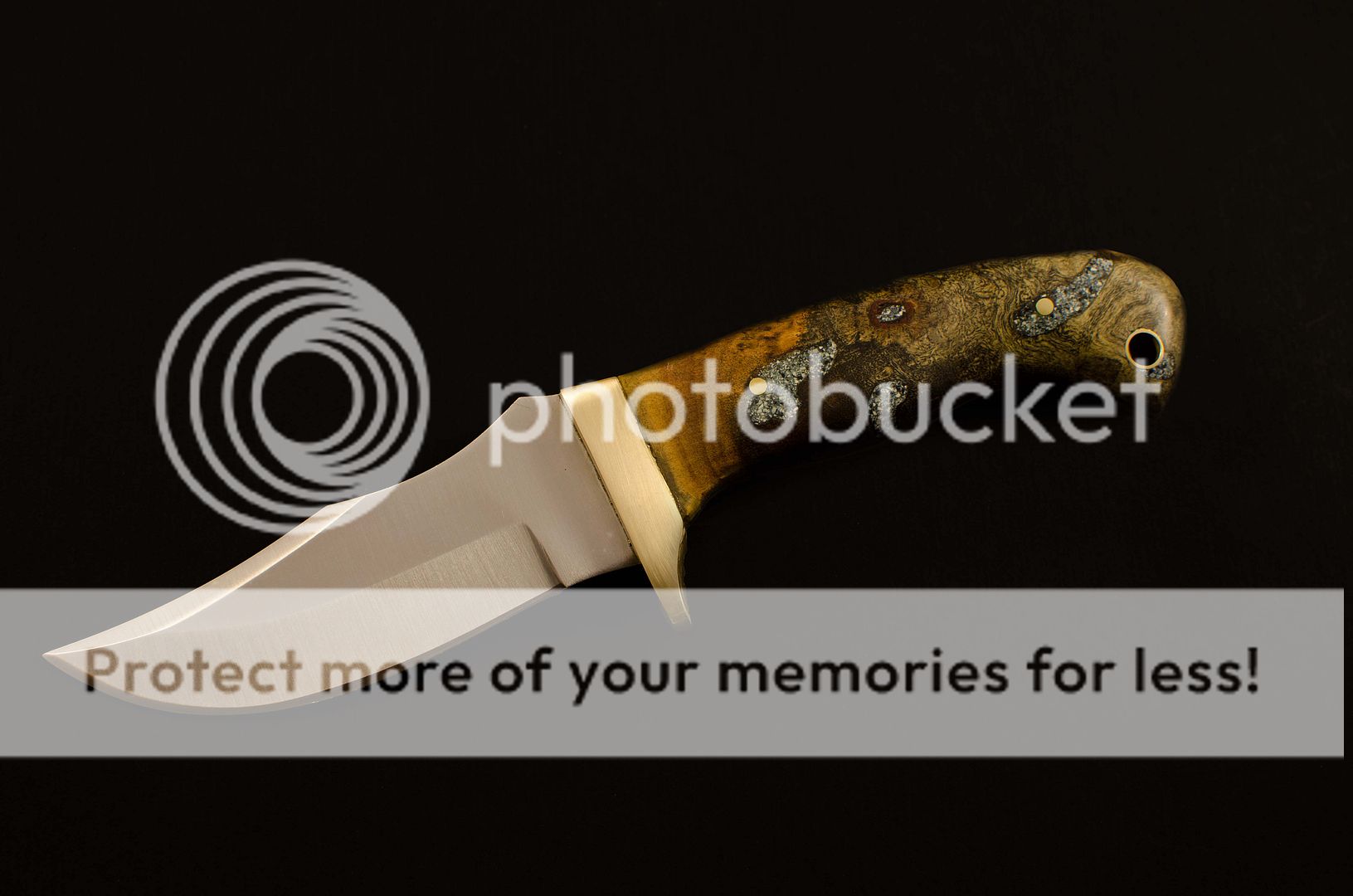

Hey guys. I am really new to knives and I have successfully made one real beauty... well, I put scales on a blank. Heres that knife...
I have started my second knife and this time, it has brass appointments. I am using some of the exact same buckeye burl as the knife above. As I am sanding things down I seem to be pulling brass dust into the wood scales and I think its discoloring the buckeye burl. Is there any way to get that out? It became most apparent as I got into the very fine grits. It seems to be turning the wood a dull gray. I tried wiping it with a damp towel to see if the natural color came back, but it's still quite gray.

The wood is stabilized and i am using wet/dry sand paper. I'm sanding up to 1500g. No concern about moisture content as the wood and work environment is extremely dry. I tried something that worked like a charm. I wrapped the scales with white masking tape and grripped it hard for a few minutes. When I removed the tape most of the color of the wood returned and there was gray dust on the tape. So was the gray stuff actually sand deposit from the paper??

Poez. I actually didnt just think of the masking tape idea. But, like you suggested, I masked off the scales to continue buffing the brass finger guard. It was when I removed the masking tape did I notice it was taking off the gray. So I retaped it and gripped it twice more and it cleaned it up pretty nicely.

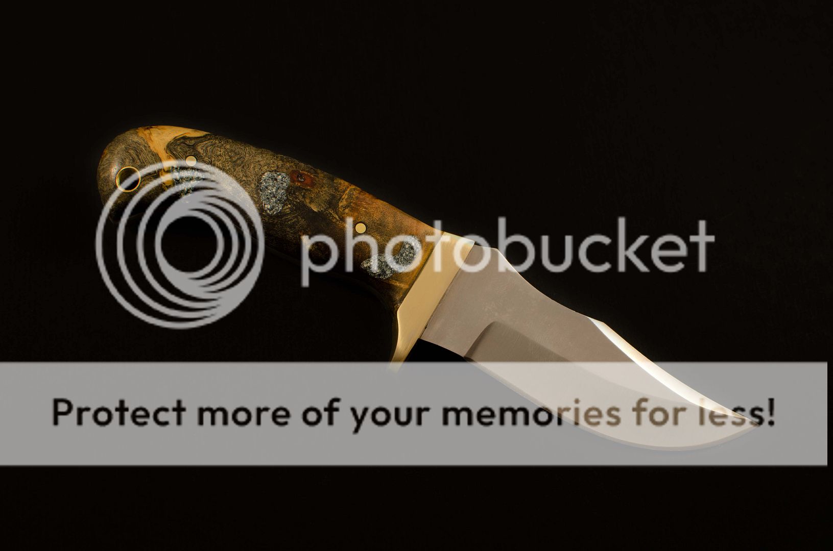

I polished out the scales and here it is. I think that gray color is gone, but this wood has a lot of natural gray so hard to tell. Definitely a more subtle part of this burl than my previous project.
