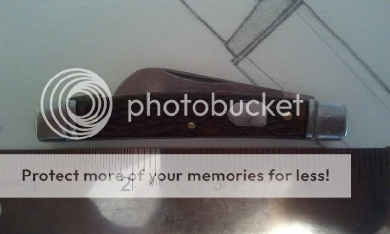

I have a junky old single spring half-congress by Sabre of Japan and the pen blade is broken off at the tang. I really like this handle shape with the lone sheepsfoot blade. I am thinking about using it as a pattern to make one properly with only a sheepsfoot blade, but don't know what I would call it. Would it be a 1/4 congress? Equal end sway back? This knife really is handy because with the tall sheepsfoot blade I can open it with a pinch grip or using the nail nic.
So what would be the correct name for this knife pattern?

Congress jack - though historically, a congress jack has normally had two blades at one end - a large sheepsfoot and a pen of some sort -- but a single blade congress jack should be dandy too.
Here's an old Boker Improved Cutlery congress jack (3 1/2" closed) - not mine I'm sad to say (note that the backspring pin is moved back away from the center point - it's a jack after all, might as well give the springs some more room to work and allow a bit more room for the blades down in the body of the pattern):

That is a cool little knife! So it would be a congress jack. I was also thinking of moving the spring pivot pin back to lower the blade just a touch and allow for a longer blade while keeping the tip in the handle. I love that with the wharncliff and fine tip pen blade! My biggest pet peave is pen blades with such a short blunt spear point you can hardly use them for fine detail work.

Interesting to me is that these photos show something of the finesse the really old congress patterns had -- in particular, the curved blade backs (they wouldn't have considered the main blade to be a flavor of wharncliffe back then). This is normally impossible to see in photos or scans. This curve starts from the run-up -- it allows the blade to sit closer to the body when closed and look more graceful, but in particular - it allows a smooth continuation of the concave congress back curve to the blade tang and blade back when open - where it becomes a smooth convex recurve. Love the subtly curved shield too. Looking forward to seeing what you come up with.
Zero, thanks for the pics. Those really help with design conceptualization (is that even a word?). Interesting to note, like you point out the graceful long curve of the blade spine, yet the spring side of the body looks almost straight. I have seen a few older congress patterns that were straight backed, but had more of a traditional sheepsfoot blade with a straight spine. This knife you posted is really quite refined and very elegant in design. The more I look at it I start to notice little things that don't stand out because they are just perfectly in place.
Here is my knife I intend to remake in better materials. It really is a pile of junk, but the pattern with a single blade makes for a nice thin, handy, comfortable little knife.
The main things I am looking to remedy would be blade shape. I think after moving the spring pivot back .25" it will allow a little longer blade to sit with the tip inside the handle. I am going to try M-2 for the blade, I have some .034" 416 SS for the liners, I may make the spring from 1080 because I don't think the M-2 will work well for that. I just have to pick up some pin stock to match whatever I decide to use for bolsters. Should be a fun little project.
