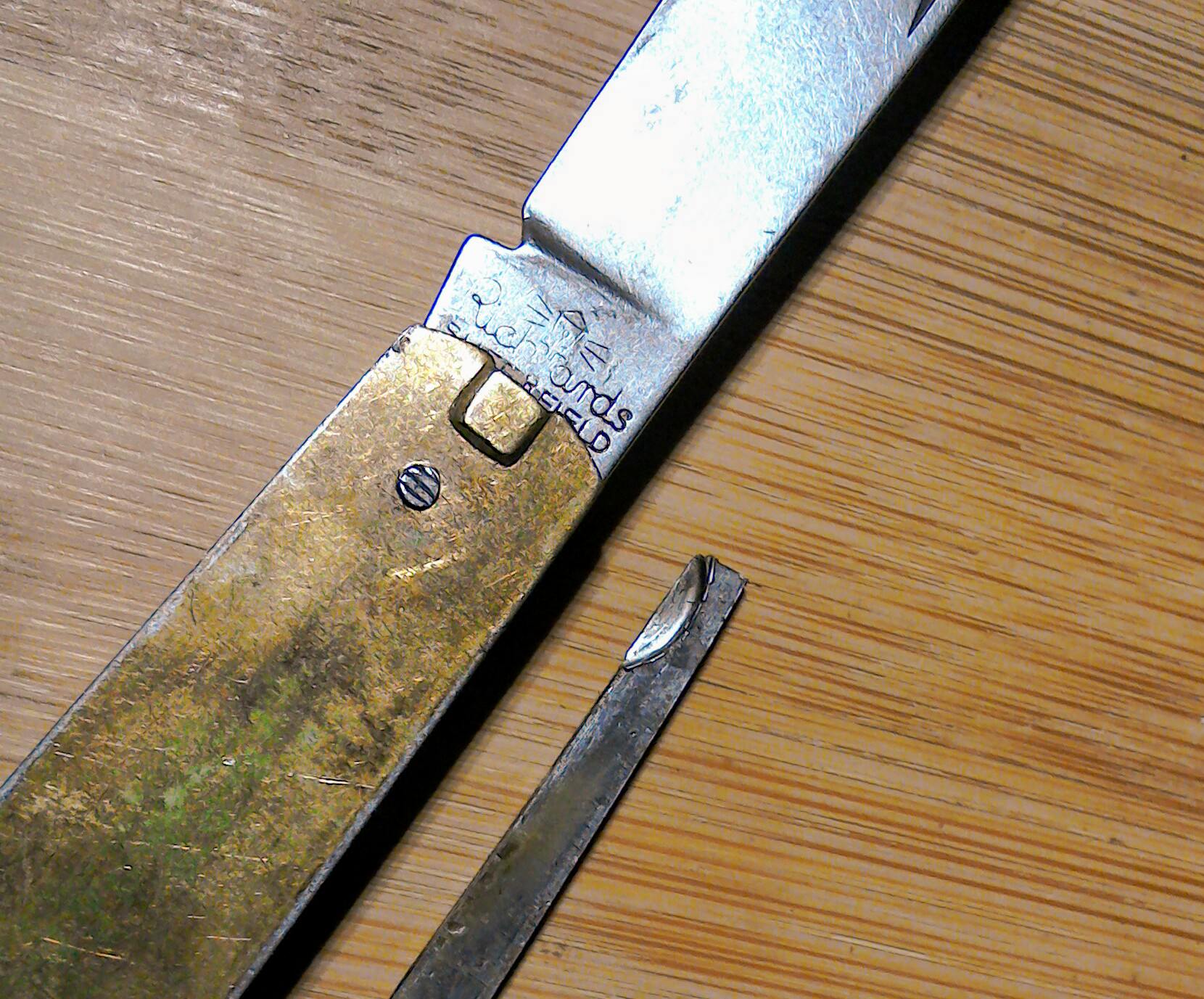

Unfortunately, a fair number of the Camillus engineer knives on the market are parts knives. The story usually goes that one knife had a main blade sharpened down to a toothpick, and another knife had a busted awl. So somebody assembled the best pieces into one knife. Unfortunately, this sometimes results in a knife with not-so-good levels of fit. This is the downside of buying a knife with such extraordinarily large production numbers.
And then sometimes the knife has just been worn out. It happens.
Can you post a picture of the backsprings? Parts knives are often easy to spot by looking at the backsprings.
I recently got this cheap Richards knife with the same symptoms, might be your problem too.
The bottom knife, you can see the sunken end. I’ve tried cleaning it as best I could, didn’t make a difference.
