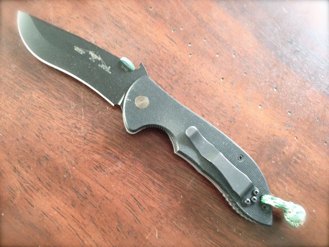

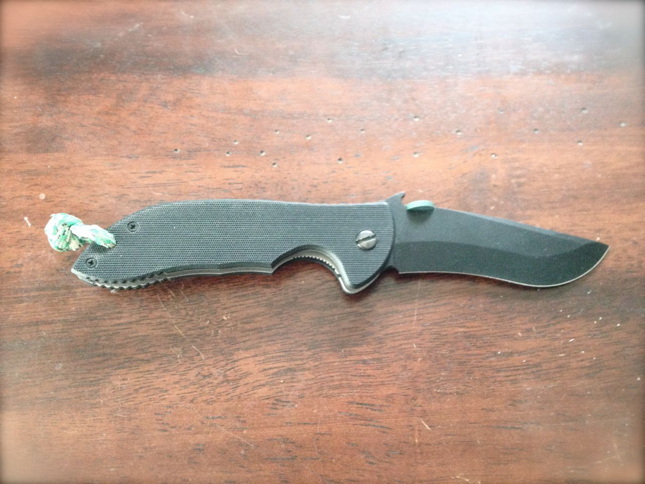

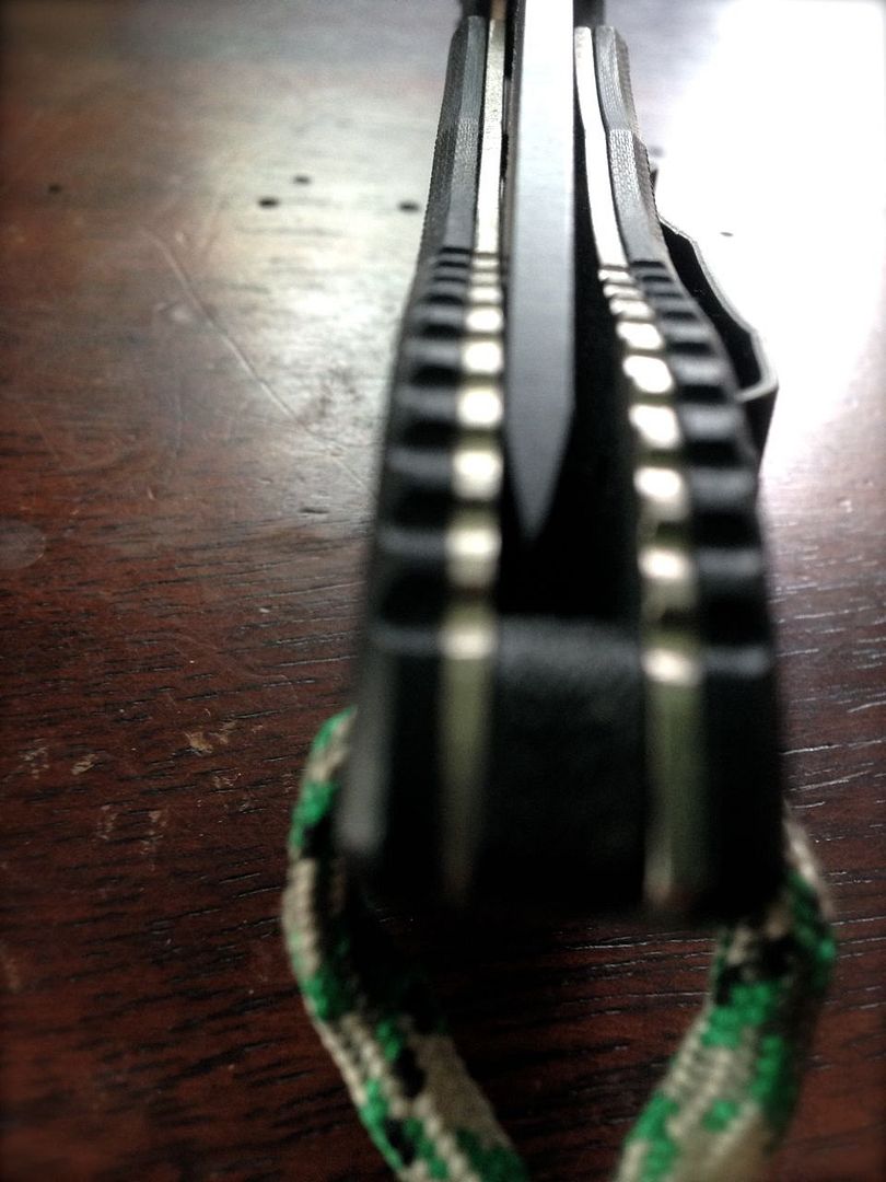

I have a lefty commander and have really grown to love it. The action was a little sticky at first and it has really worked in nicely. I carry the lefty commander most days. The lock bar, liners and clip are all lefty. The only downside on this one is that I had to pay full retail, direct - and for this price on a production knife, I would like a centered blade. I will try to get a couple pics.

You have to remove the pivot screw to open it, MtnMark, so the pivot was loosened as well. That is not a bad thing.
There is a trick to centering these blades and I know I have it somewhere I just have to get it. It's a small instruction.
Off the top of my head though:
Turn the pivot to where you would like it to be. Meaning the looseness or blade tightness is where you'd like it. Don,t worry about center or the blade touching the liner and what not. Open the blade.
Now loosen the the pivot 1 and a half times back from where it is. Now loosen the body screws to where they are loose but not falling out.
From the back tighten the body screws forward toward the blade making sure they in straight and freely while holding the scales together firmly.
Hold the liner lock in and tighten your pivot 1 and a half turns back to where you like it.
Close the blade and center the blade slightly if need be.
I think that's it. Try it and let us know.
