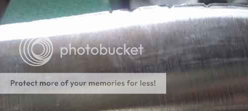

I'm not going to bust out scientific facts, as to be honest, i'm not a metallurgist but I do have some experience with THIN infi.
I took a comp grade sarsquatch, and figured... hey this decarb sucks, so I ground it off. While I was there, I figured why not grind out the infi dimples
Now that the primary grind was sufficiently thinned, I figured.. hey this comp grade edge is RAZOR sharp, but why not make it sharper, why not make it a scalpel. I took the edge down to about 10 degrees per side, convexed. It was the sharpest knife I have ever touched, simply making contact with the edge would make you bleed.
In use the knife worked AMAZING, it cut through everything I needed to, but I never really put it to the test I put my Busses through. I took it out Ice Fishing and was using it to split kindling for our fire barrel. It was going through wood scraps no problem, I even chopped some up with it.
I didn't run into any real problems with the edge until I decided to test it out on some frozen wood my buddy had brought. Making angled chops I quickly went after the wood and I was pleased with its performance.. until i went to resheath it and it wouldn't fit in the sheath. The edge was very very dented, certainly not the fault of INFI or Busse though. The combination of me thinning the edge to a scary degree and the lateral stress against the actual cutting edge while chopping/removing the blade at an angle were just too much.
I ended up grinding out the damage and thickening it up some and it worked fine after.
I will say, the knife held up tremendously well using it to split wood, chop up softer stuff, kitchen use and general knife tasks even with the very thin primary grind and edge. Your culti will hold up FINE to any normal use. My sarsquatch didn't even chip after all that, just dent and rip a little.
