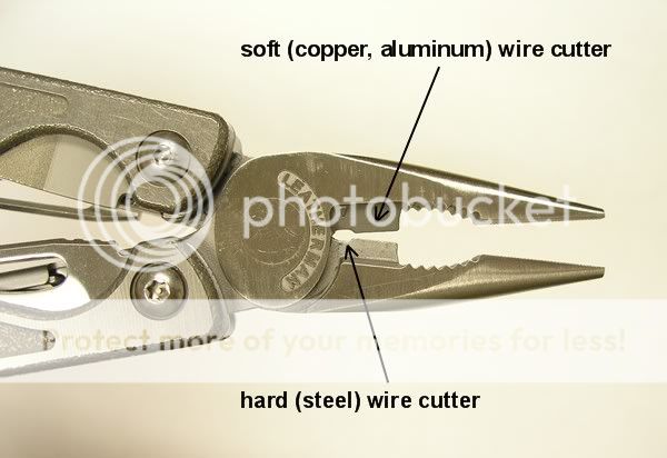

Hi, I've been a long time lurker of this forum (didn't need to post as archives are pretty useful...til now). As I'm volunteering in the building of houses in Sri Lanka in about 1 month, I bought myself multiplier tool, the Leatherman Wave. I got this off a discount, which is great. Though I wish I should have researched more and should have bought maybe the Swisstool RS, the Leatherman Surge, or the Leatherman Core (I didn't now about this forum until after I bought my Wave and started googling).
Anyway, my question is about the hard wire cutter in the Wave. Is this thing tough enough to cut higher grade chicken wire? What exactly constitutes "hard wire"?

The original Wave has a notch for hard-wire as well. As to why the notch is necessary, the only reason I can think of is that it helps to keep the wire from slipping out.
kapt kopter is right, your Wave will work okay. Also be sure to heed his advice about which portion of the wire cutters to use on different types of wire.
Soft electrical wire (usually copper, sometimes aluminum) needs to be "sheared" with the forward portion of the wire cutter. (see photo) Attempts to cut steel wire in this area will result in a notched cutting surface, which pretty much ruins this feature of your multi tool.
The hard wire cutter area is closer to the plier pivot, where you can apply more leverage. It is for any type of steel wire, including fish hooks, bailing wire, and fencing. This "hard wire notch" could be more aptly called a wire breaker than a wire cutter. The two opposing surfaces are blunt, and when the right amount of pressure is applied, the steel wire simply snaps apart.
