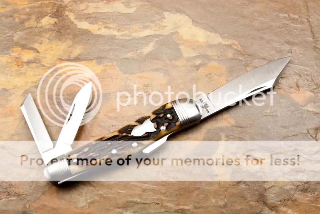

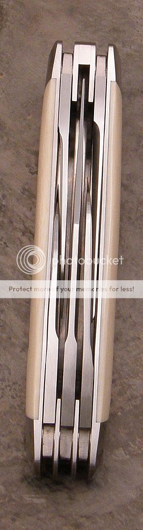

The whittler pattern is a difficult patter to do well. Getting the center spacer taper correct is a challenge along with the hole drilling.
That being said there are so many difficult patterns in the multi-blade arena.

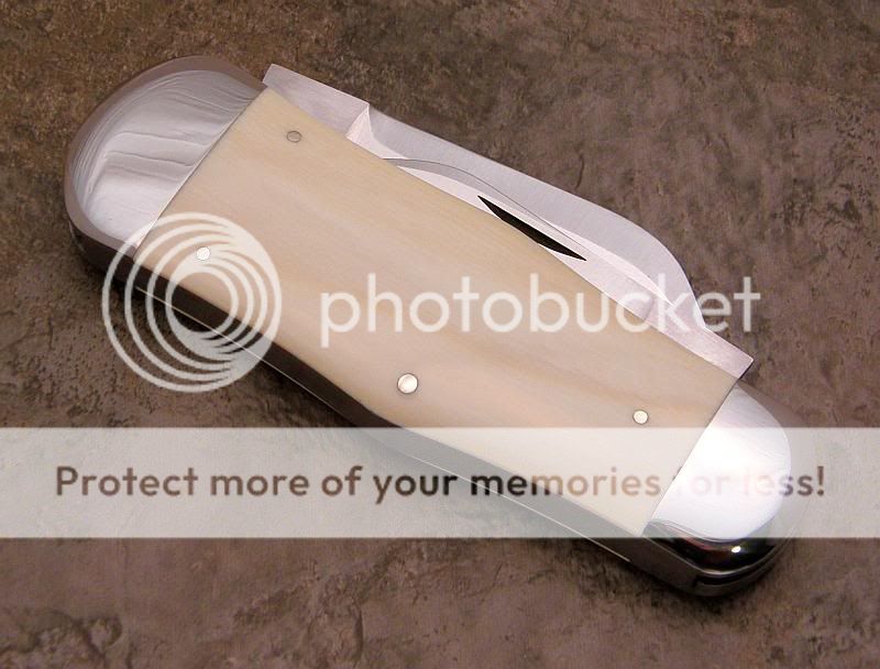

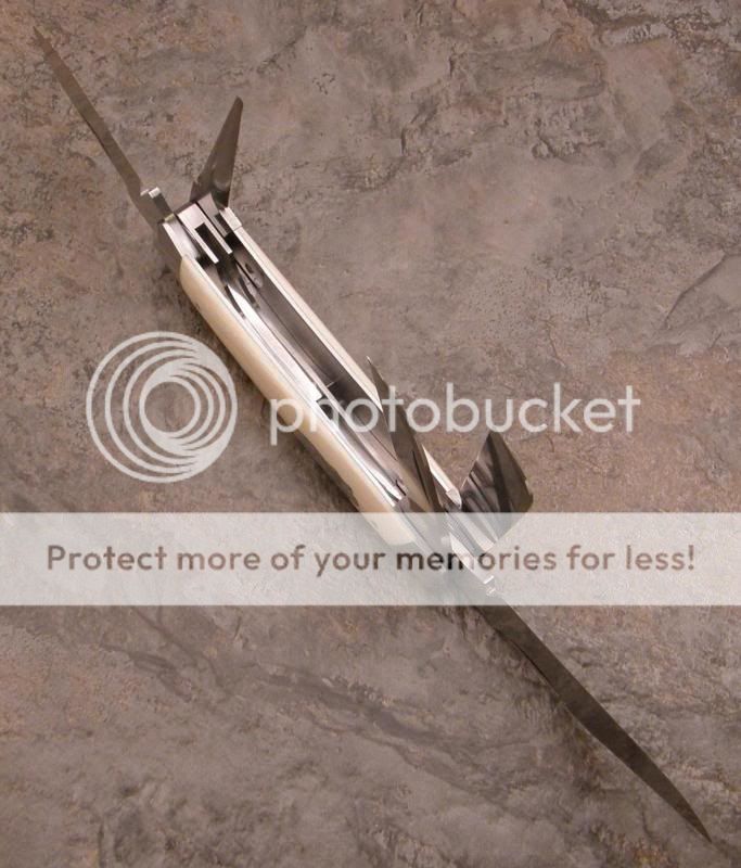

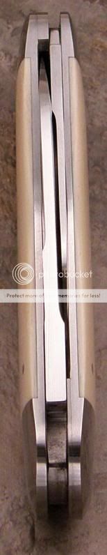

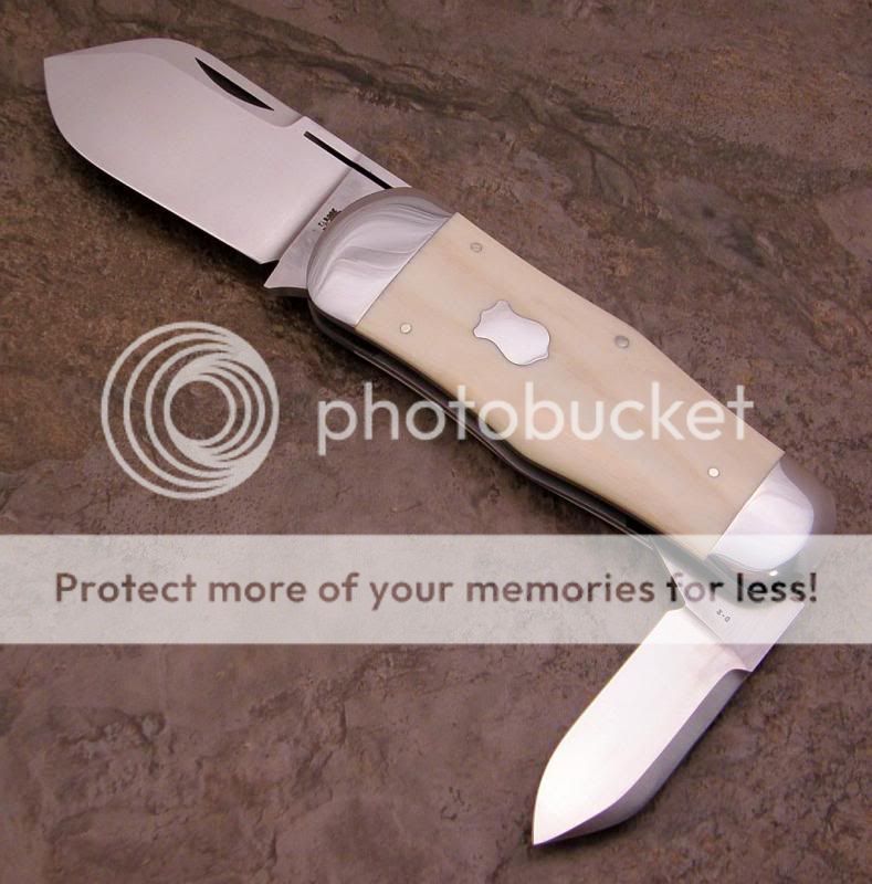

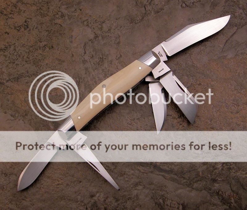

Hope a few pictures are ok as I will show a few that presented major challenges to my knife building skills(in no particular order).
The knives with either a locking mechanism or corkscrew adds a lot to the difficulty of build.
These are incredible Ken, I actually got goose-bumps looking at the pictures! :D

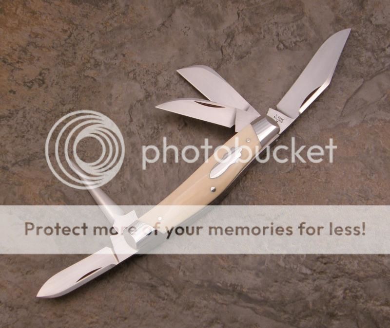

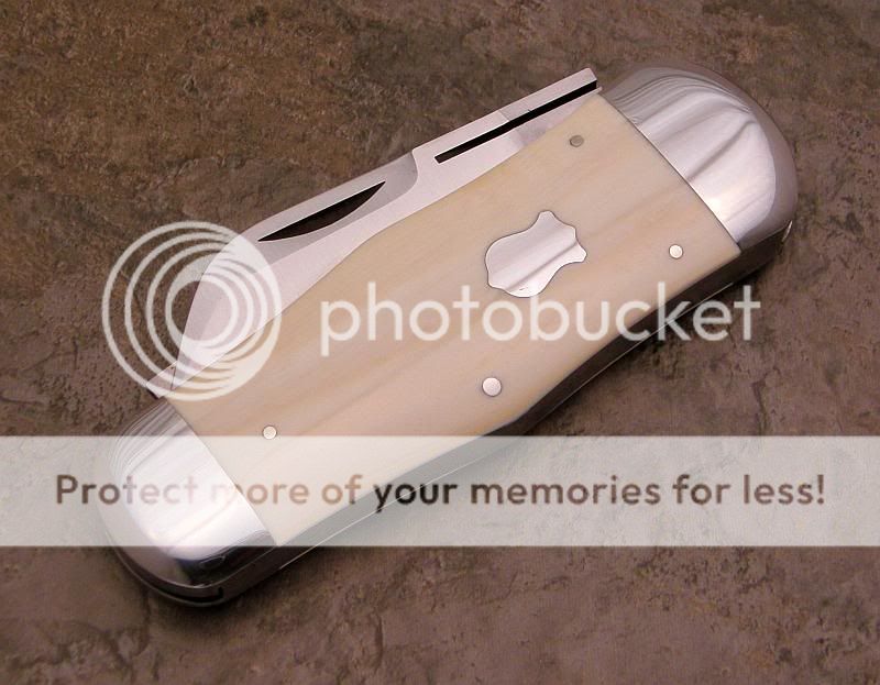

Ken, could you tell me more about this one, and its challenges?
(If it has a specific name, perhaps I can find more pictures and information in your dedicated thread?)
Whatever it is, it's beautiful.
~ P.
Sarah,
That is a small 4 blade swell center congress pattern that I did a few years ago. This knife also has a nail file/manicure blade. The tolerances are very tight and with small blades being hard to grind anyways its a hair puller!:eek:
The real challenge from my standpoint when building many of these knives based on vintage examples is to keep the proportions correct. When these knives were made originally the grinds were such that the blades just had to pass each other opening and closing. If they rubbed while doing it it was really not a big deal. On a custom knife today we all expect no blade rubs. It is very very easy for a maker to build the knife with thicker blade stock and center liners for more clearance. A few thousandths here and there end up destroying the proportions. That is one of the hardest aspects for me to get "right" on a handmade knife.

Thanks much for the additional information and pictures. I found your point about blade rub especially interesting:
Well, kudos once again on a job well-done, if at the expense of hair. Heh.
These additional pictures, as well as your explanation, are very helpful. Thanks!
