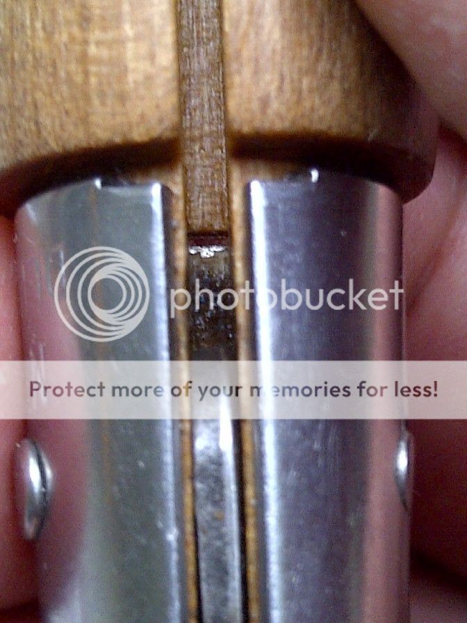

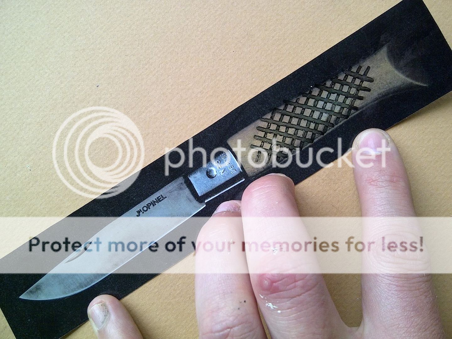

So, my solution was to cut down a piece of triangular stag and wedge it down in there. It was fitted so tight the compression of the wood held but I also stripped the inside where it would attach and epoxied it in.
I also put a notch to hold the blade in it so it would stabilize it a bit.
I like my opines to be sharp the entire length. I even file them for the kick out further.
In the ebony I went all out and designed it for the back of the kick to hinge down onto the slant shown in here :)
All in all I LOVE opinels. I invested days of work into mine and they have NOT let me down :)
Seeing this posted elsewhere on the forum earlier was the inspiration for my own (less sophisticated) modification. And I agree that the lateral motion of the tip against the wood seems to be the source of more edge than simple contact with the handle.
Thanks, richstag, for sharing this both now and earlier.:thumbup:
