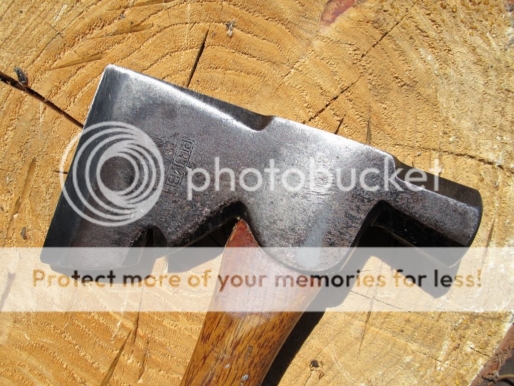

Garry - you included a CT in your pic. Is that one with a hardened poll as well? - just without the chamfered poll? I have one with the same CT logo I haven't messed with - run a file on it to tell?
International Corporation 2006 School bus I'm driving at the moment has an issued CT wood-handled hatchet in it that appears to be hardened from top to bottom. The blade has purposely been dulled and scalloped. But I would trust this thing to break glass, slice through sheet metal and bust things with the best of them in the event of an emergency.
Nice find! Man, when the poll is even checkered then you know an axe like this means serious business at both ends.
