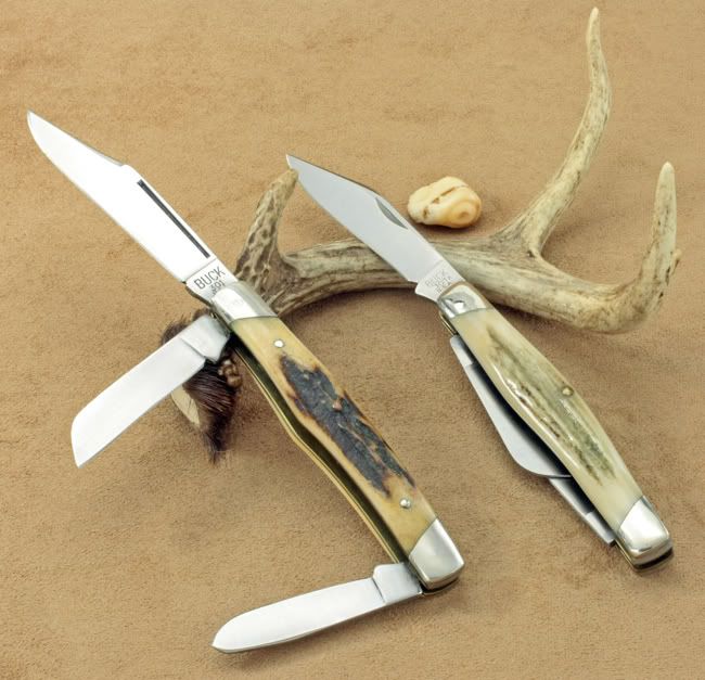

These both have that date code. Left one is elk.
Here's one with scale rivets and Camillus steel. Must have been an after market mod. Other one is elk.
