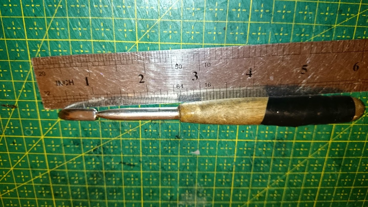

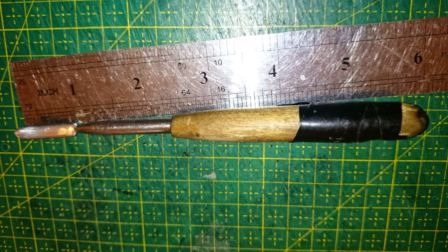

For me, the most important is a tool for molding.
I tried a few ready tools but at the end I made my own.
I made it over 1000 sheaths to folders, for me it is perfect.

Question. I know carbon steel will discolor wet leather. I have found that my hand made stainless makers mark won't. Is that true of all stainless?
I did it with a a stainless steel rod with a diameter of 6 mm (about 0.25 ")
15 minutes work with a a belt sander and polisher.
Every month polishes it with a polishing paste.
I did not notice never problems with staining of the leather.
By the way I'm going to do some new, if you want to do for you, too.
