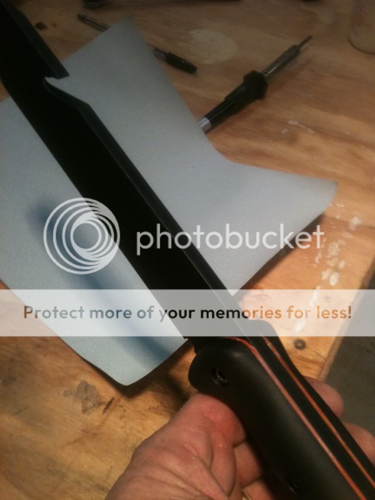

Messing around in the garage with my bk3 blank. I wanted orange so cut them out of home depot bucket lid.
i know they're not perfect but wanted to see what it would look like.i'm thinking about replacing soon with kydex.
