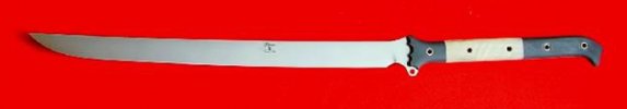

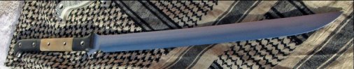

CBT or no CBT aside, here's a couple of factory satin Custom Shop AK pics.
The first is mine. It is different from the original Minumental Ganza AK pic, so there's at least two of these in the world, as evidenced by the second pic (which is the original sighting from the Minumental Ganza pics).

That was basically the one I was referring to. Aside from that customer model (and I don;t know how many were made) you can find AK's without CBT's in threads where members modded out their coated blades.
