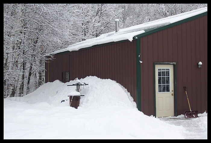

These are from my old shop in Illinois, but the system is the same.
100 gallon or more tank outside.

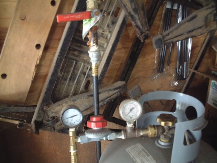

Regulate line pressure at the tank to suit your needs inside.
I have a regulator outside that puts 7 pounds in the hard line.
Shut off on the tank.
Shut off on the line.
Run over to your forging area and put in another regulator to drop the line pressure to your needed amount at the burner.
With a shut off on the regulator.
Put another shut off on the burner.
I had insurance at this location and I have full replacement and liability at my new location. Fully inspected by the ins. company.
See the regulator on the tank and the shut off in the hard line.

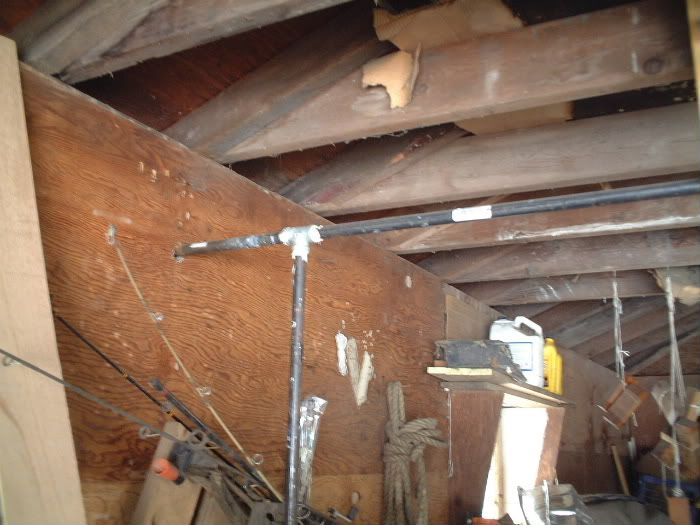

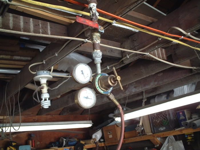

Come in through the wall. I even had an in-line 100#-er for back up!
Take it overhead to your forging location:
I use quick disconnects at the burner as I have three forges and burners.
With a shut off on the burner as well.
Somebody said something about hauling 100#-ers being illegal?
Seriously? :rolleyes:
Whatever.
This is the new shop. See the same line dropped from the ceiling:
