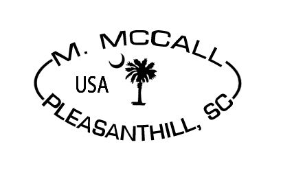

So I've been pondering on this for a while now, but now that I have some good steel, my grinder is fully operational and I'm ready to go I've ordered my mark, and took some of the advice offered here. So here it is. Just waiting on the proofs from marking methods and should have it by the end of next week.
Looks good to me. I don't know what sizes you have settled on but my old makers mark was clear at all 3 sizes with the smallest being 1/2" or so.
HAHA.. A fellow South Carolina man. I didn't figure I would be the only one to use the palmetto moon in the mark from SC. Thanks Matt.

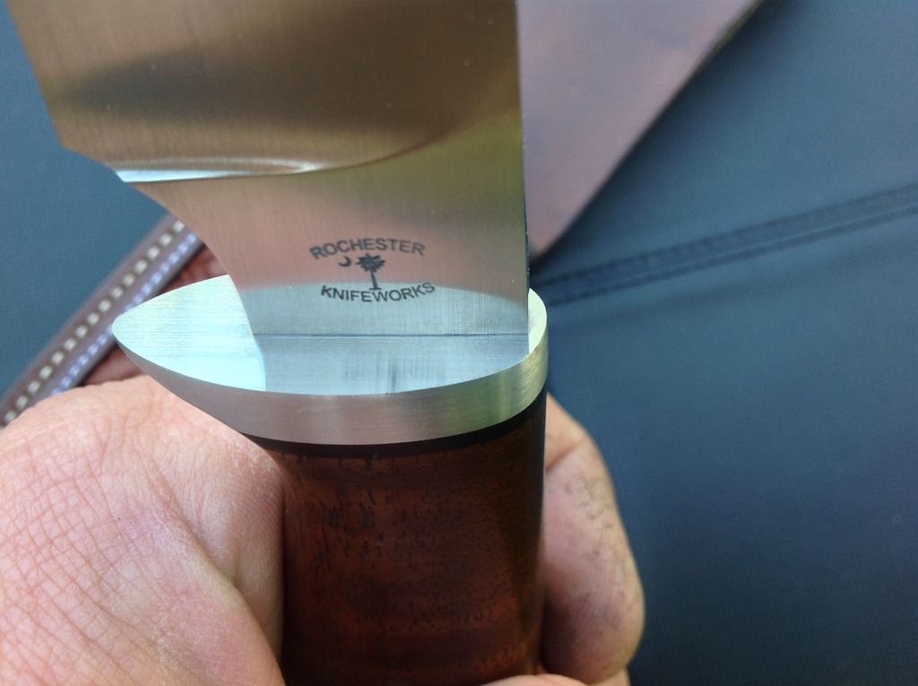

I liked it but figured folks outside of the state wouldn't get it so I simplified it to Rochester and Seneca Sc. If another Rochester starts making knives in Seneca I will have to get more specific!
I liked it but figured folks outside of the state wouldn't get it...
I don't care for the palm tree and moon
I Google-ed and found it's the state flag, but since you already have the state written in text, I'd skip it.
1
I wouldn't want to confuse it with the Islam moon
2
Leaving it out will leave more room for the text, especially on scaling down smaller
3
There is too much detail that will be lost on shrinking.

This is about .5" circumscribed.
Got my stencil in last night and tried it out on a cracked blade. The etcher I built seems to work pretty well.
